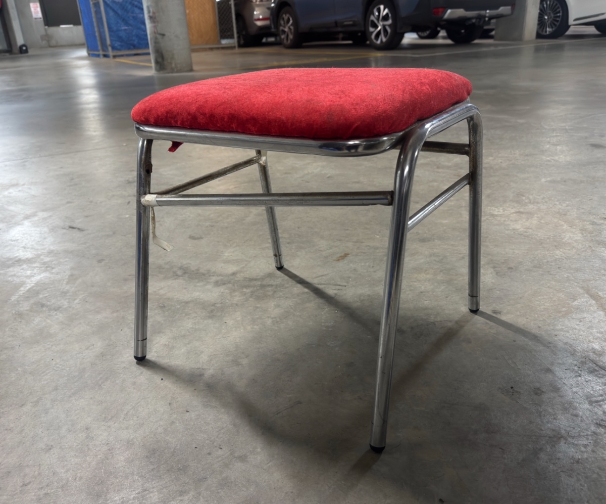

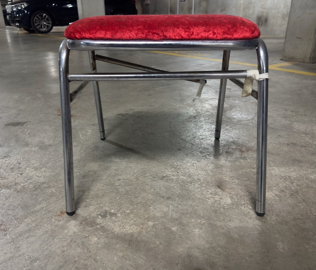

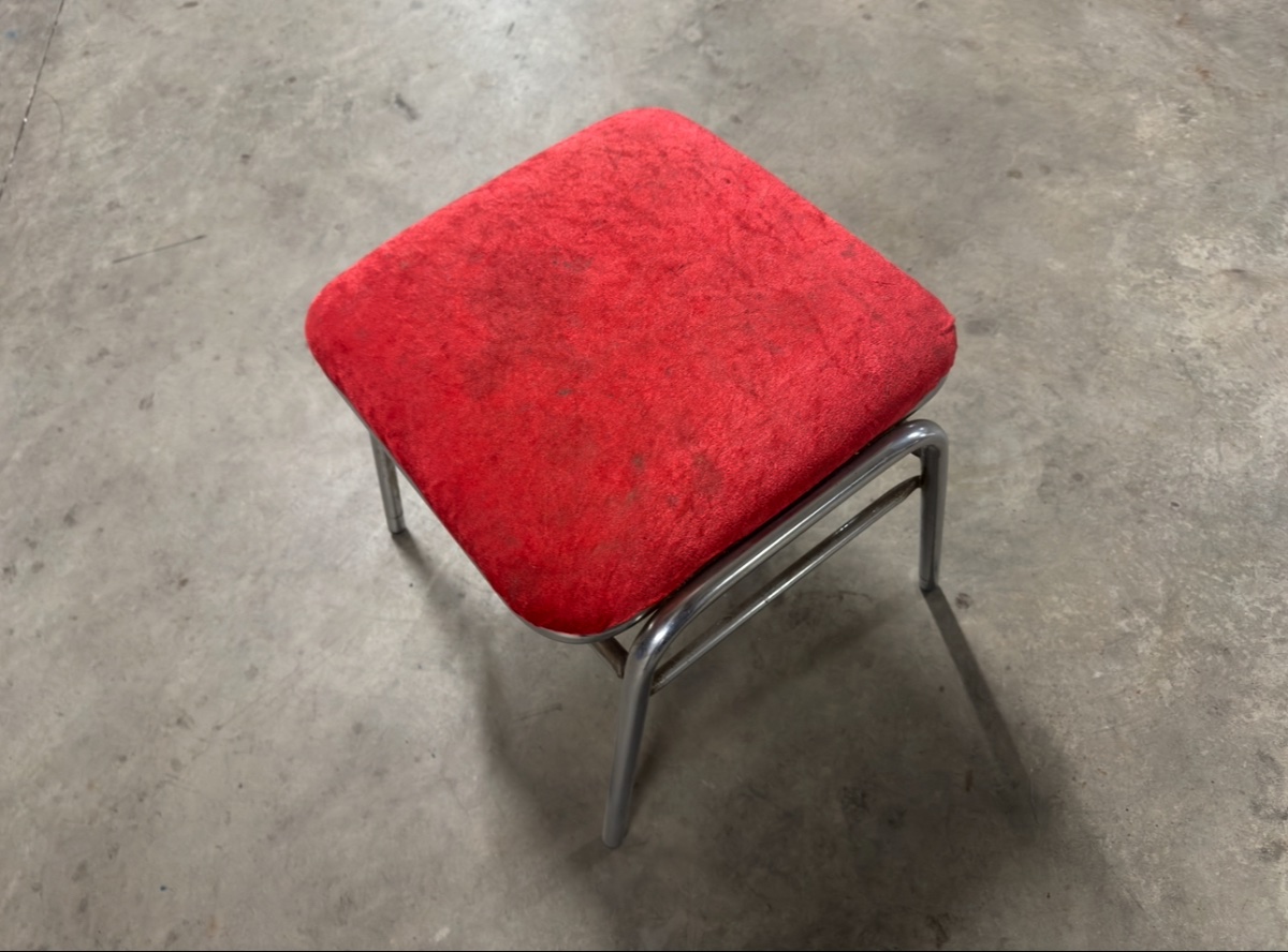

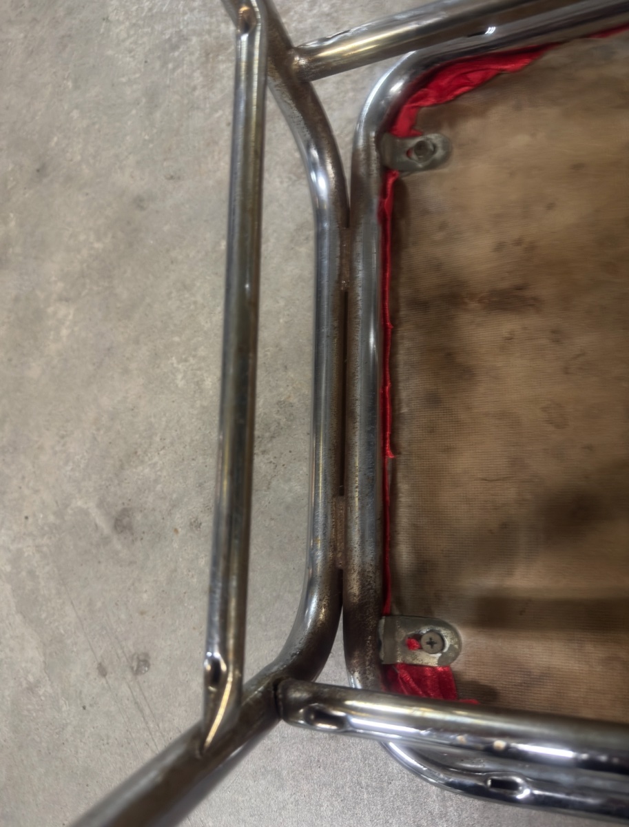

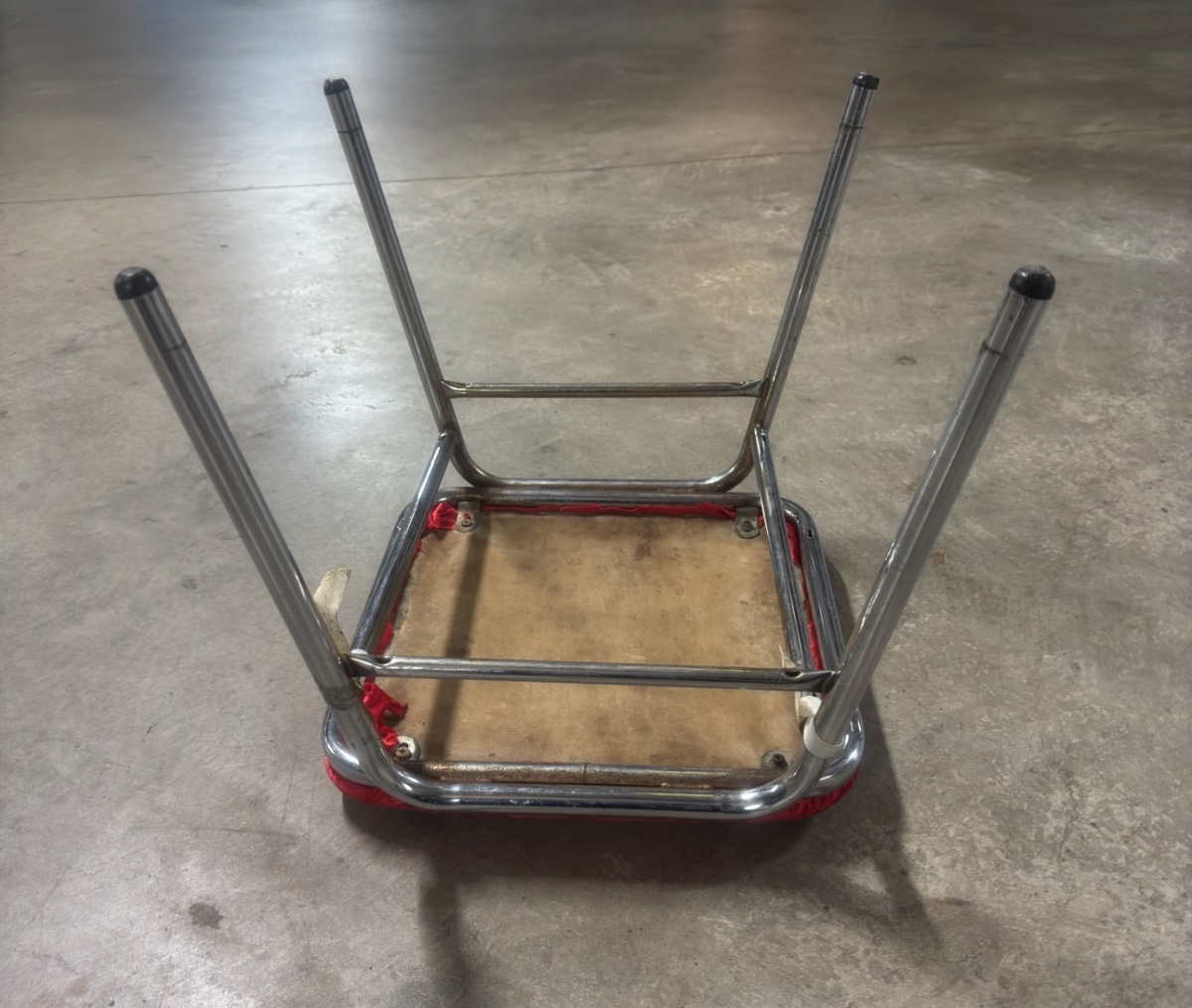

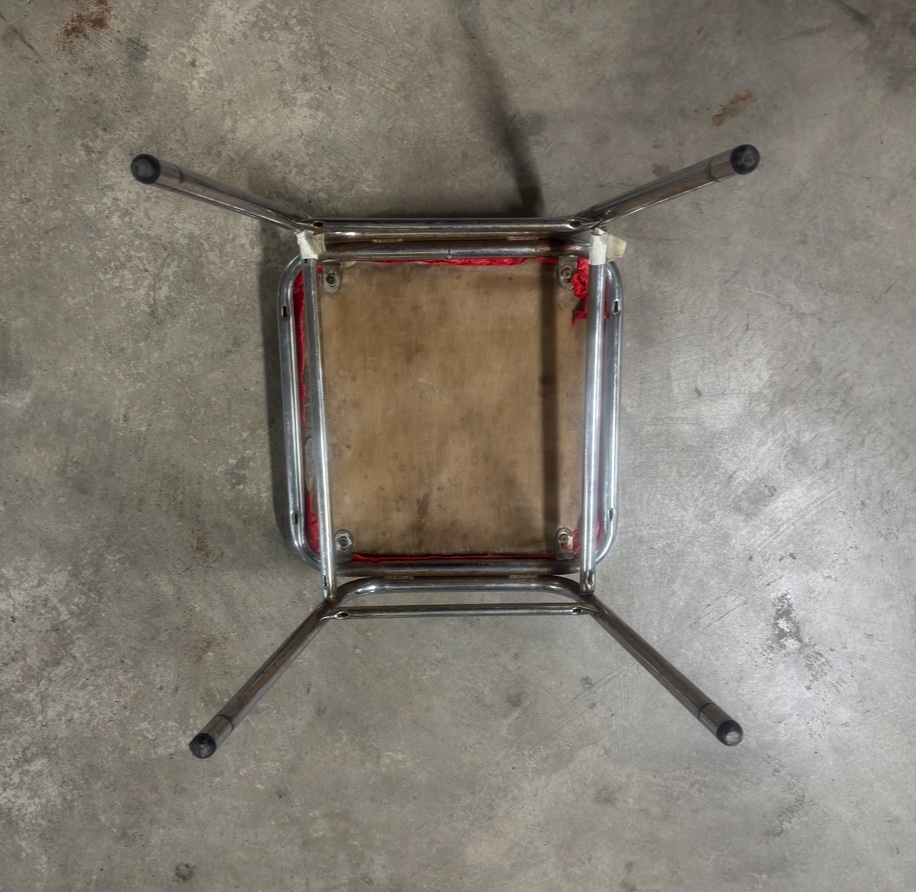

Any interest in an Arcade stool project ?
Under the Spotlight red crushed is the little bit worse for wear original grey “ corduroy “ material.
Few photos , but won’t be attending to it for a couple of weeks / get back from Japan

What is the going rate for the stools? I'm getting a few with my cabs and they are 30usd each and in pretty good nick. Should i add more to the order?
I was in Tokyo a few months back, it was so good! I was very silly and didn't bring back any 100 yen coins though.
They’re around $250 new here after people import them so I’d definitely get more if they’re that cheap.
Definable interested in that stool project, thanks @djsheep
