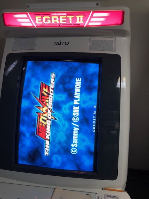

I spent a bit of time with this today. @mathieulh
So I used the newest MultiBios fixed image on my Naomi 2 system.
- NAOMI 2 MB
- Sega REV B JAMMA IO
- 512MB Net DIMM
- WiPi v5
- Pi4

This is great work. I was able to test nearly every game without actually powering off the Naomi, just booting one game, testing, then loading another over the top and letting it reboot itself. It worked alphabetically all the way until Samsho6 when it refused to load any more games over the top. As soon as i rebooted the naomi and pi system though it worked fine again and didn't give me any issues since then, and i was able to load games over the top of Samsho6.
I'm not sure about Rumble Fish 1, can anyone confirm that game works for them?
Thanks for this incredible feedback!
- Guilty gear isuka is actually AW01 (that's what the header is set to, as well as what's in the original 7Z name)
I fixed the filename inside the archive.
- Indeed the rumblefish did not run for some reason and I never noticed! I just tested after seeing and indeed I also had the error 22 on that title. I fixed that title as well, it now runs fine on my naomi2 on the rev C bios. Please redownload it from the mega repository.
- About sports shooting, I don't know what I can say other than it runs fine on my Naomi 1 and 2 running the latest BIOSes, I just retested it and it's running right now on my setup.
- About salary man kintarou, I just grabbed the title from the original SYSTEM_X header, as well as for all other atomiswave titles here. As long as it uses a unique id for the game itself, no (technical) issues should occur.
