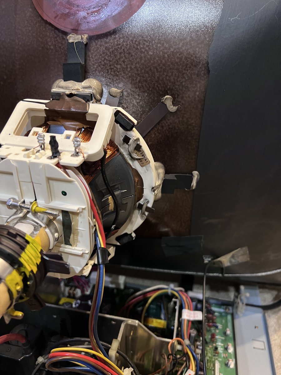

The tube in my NAC is June 1996 (6F) , yoke is ms9 , but he cut the connectors that comes on ms9 yoke and put ones to work on ms8 in my case . See on the tube what stickers you have on them and also what yoke you have to see if you need to change the yoke too
In the picture is how it looks on what he did on wires yoke
I contacted Sharp and they said they’d take a look. They think it is what he referred to as the color amplifiers on the chassis and replacing them. When I take the chassis and tube out I’ll
snap some pics of the yoke. Fingers crossed that will fix it.

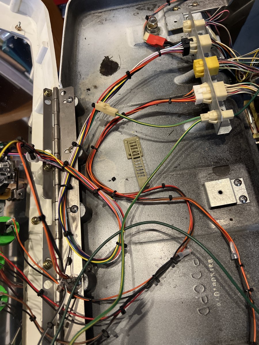

Just realized my marquee light isn’t working on the Astro 2. Does anyone know if it’s this one or this one to replace?
The manual lists it as -> DULUX S 5W/21 (390-5327)

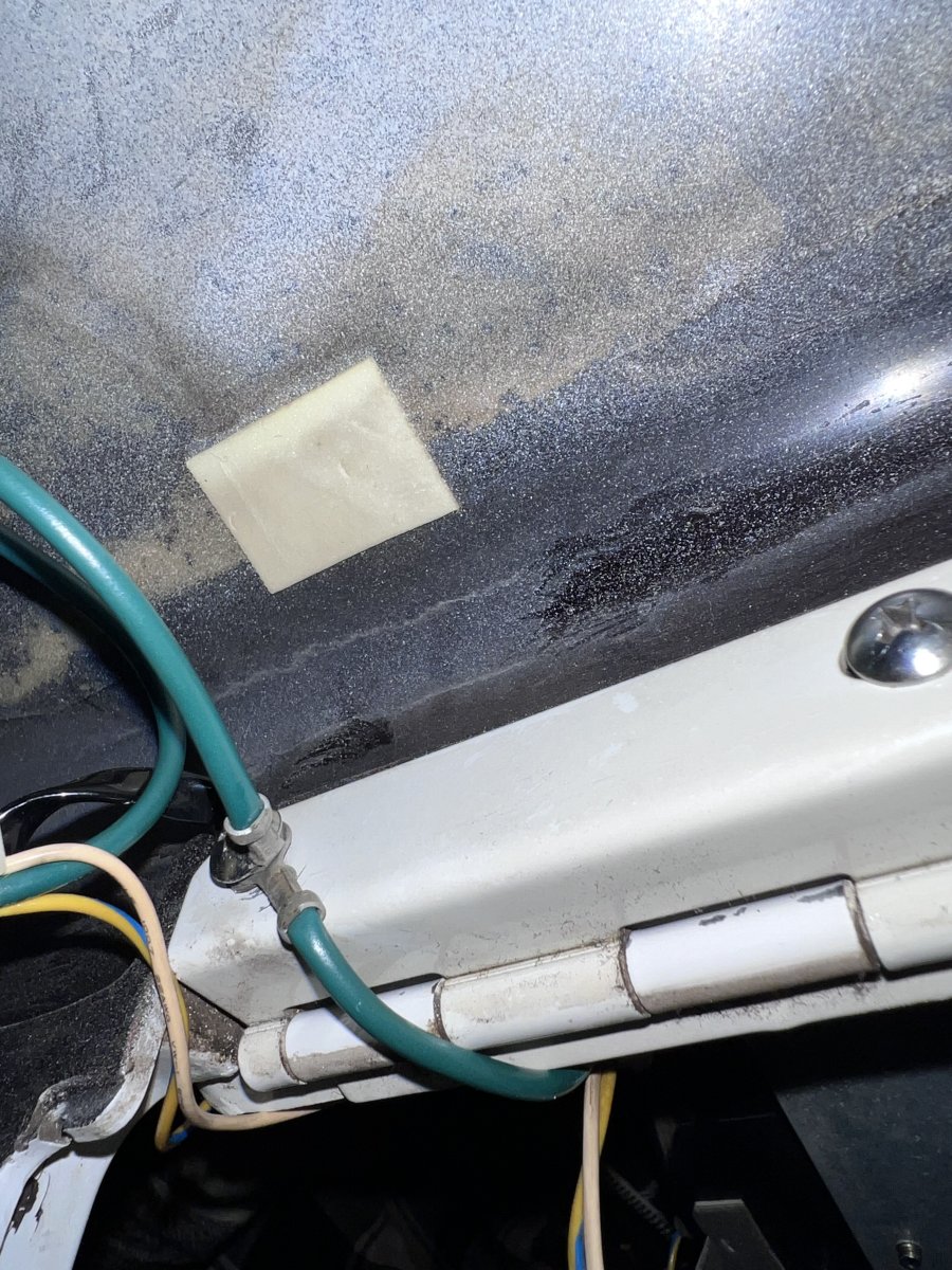

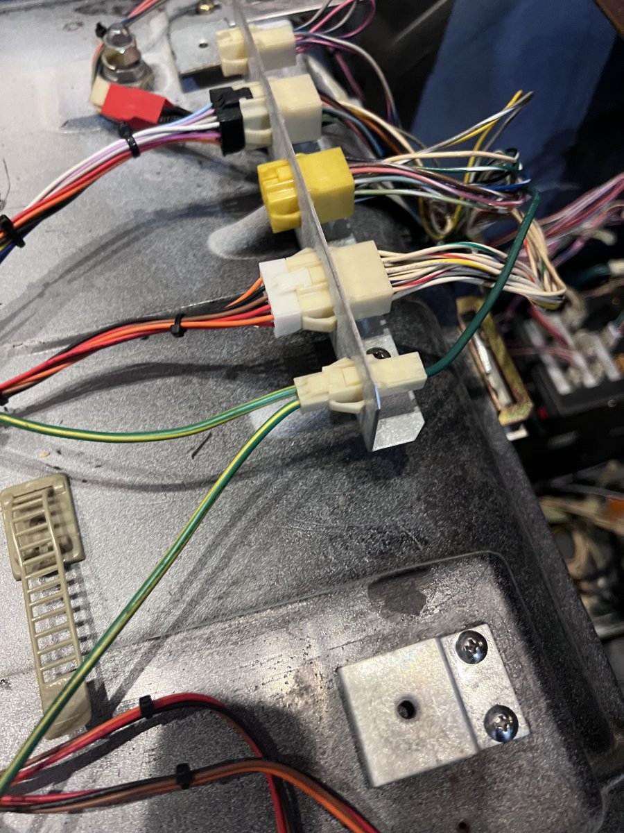

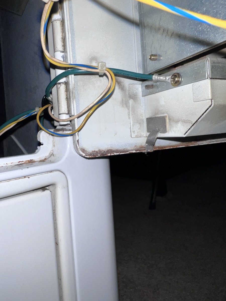

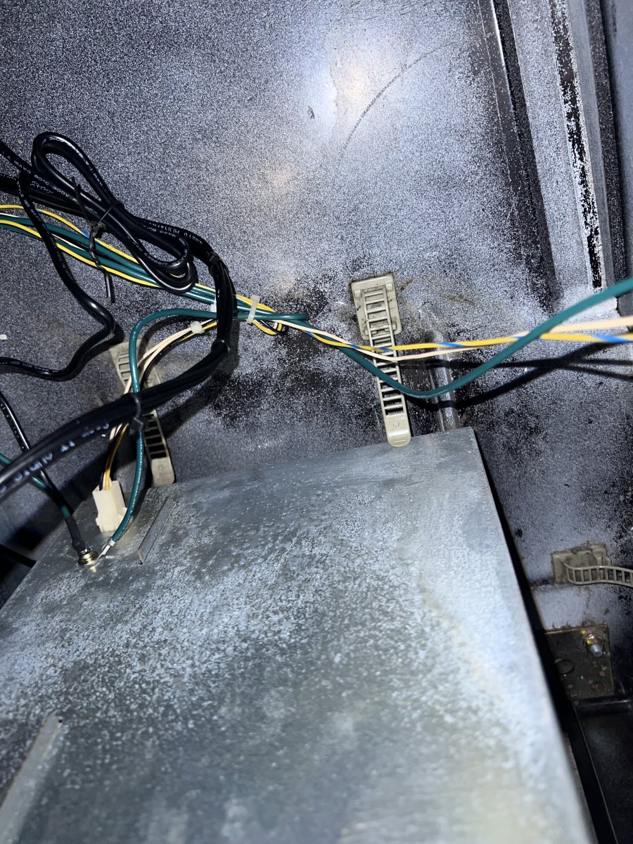

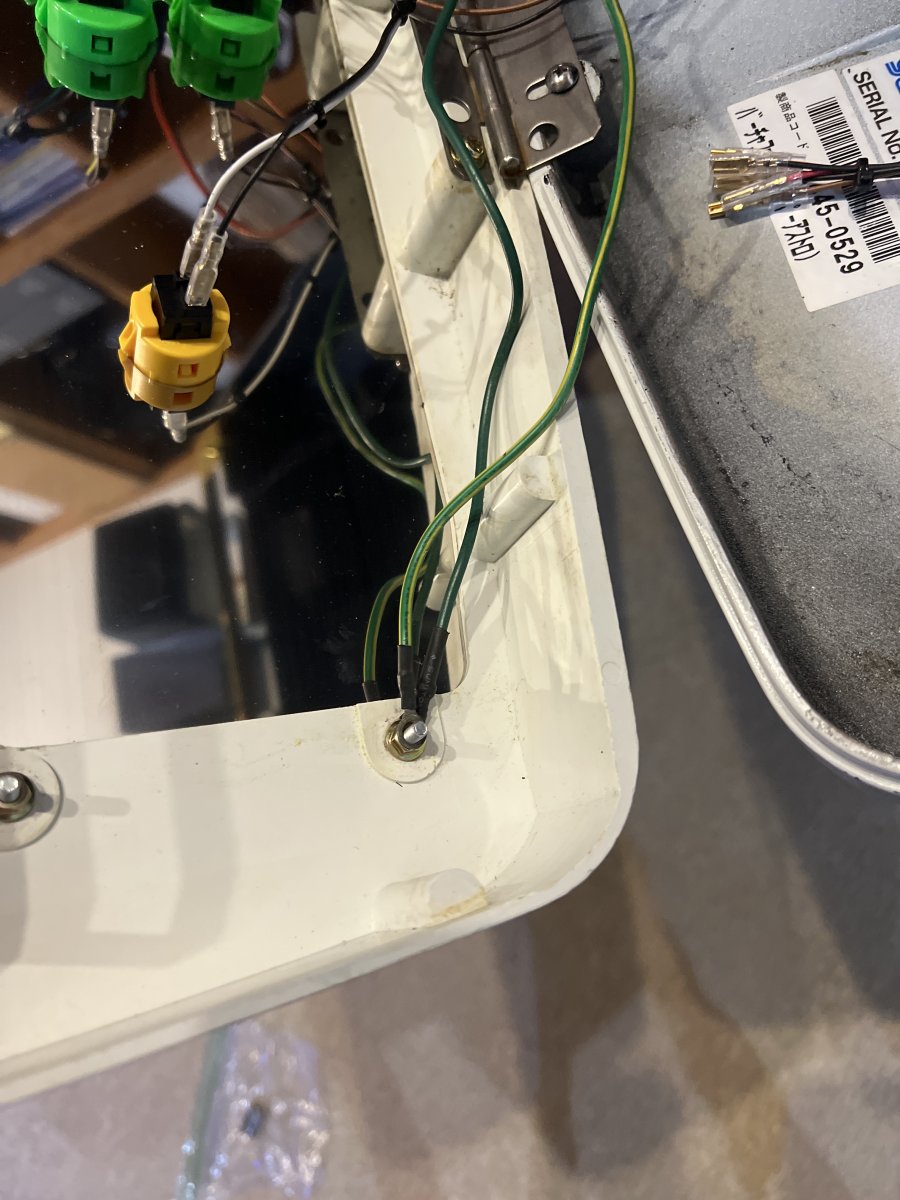

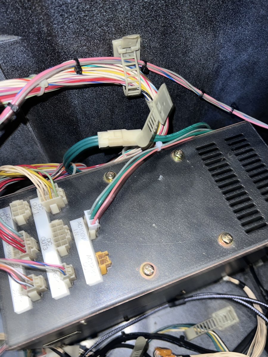

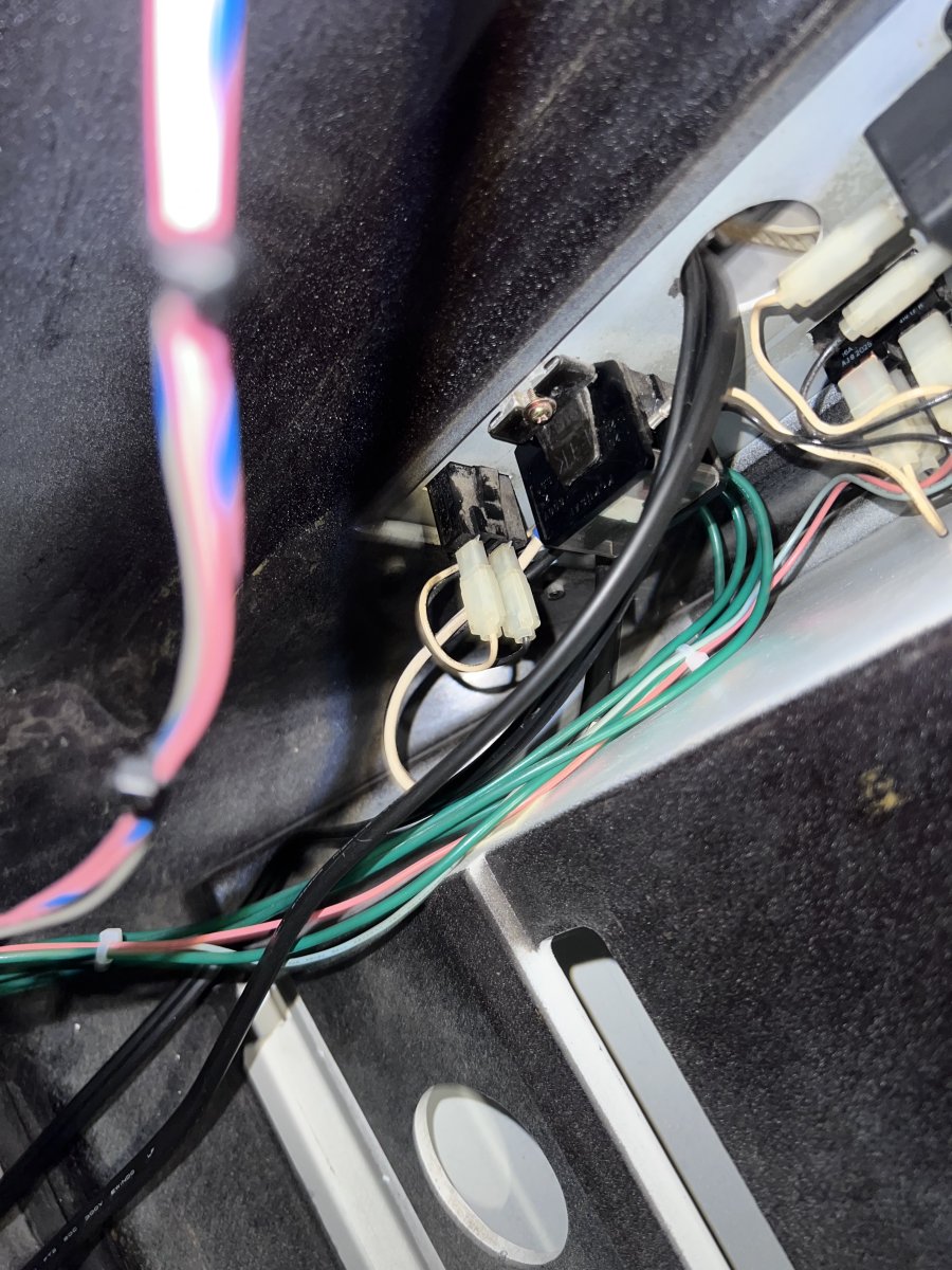

So just noticed on the Astro 2 my marquee light isn’t working. I ordered a new bulb but still no luck. All I can think of is the coil ballast is no good?

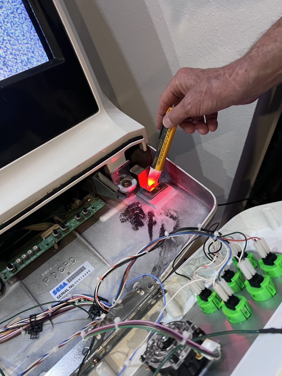

Also since the monitor is out not sure if that matters I touched the top of the unit while the unit was on to test voltage going to the light and heard a loud feedback thru the speakers.

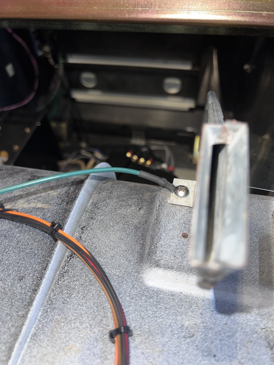

Not sure if I hooked up grounds wrong causing that noise or what could be wrong with the light. We are getting voltage on the wires going into the ballast
I’m also detecting voltage on the cabinet pretty much all over but I’m not getting zapped.
I turned off the amp and the feedback noise went away.
My og astro has voltage on the ground wires too and the cabinet so pretty confused rn.
