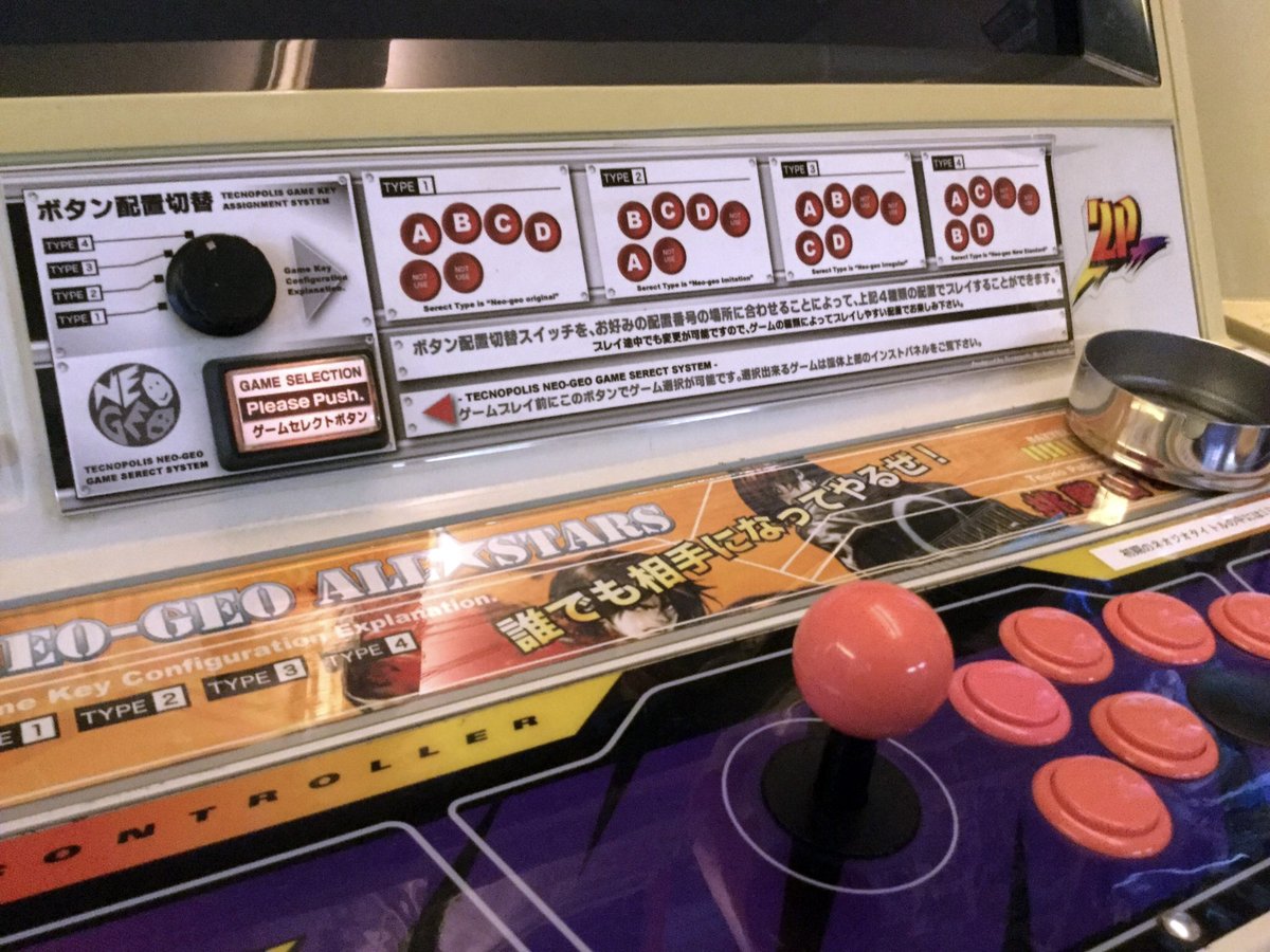

This is why so many cabs with Neo Geo games use the dial selectors for button layout. I have those too (modeled after this Technopolis one), it helps a lot. Even with fighters there's a range of how they work and which button layout makes sense.
That’s very cool! Wish it was easy to put 8 buttons on any cab and change the layout like that.

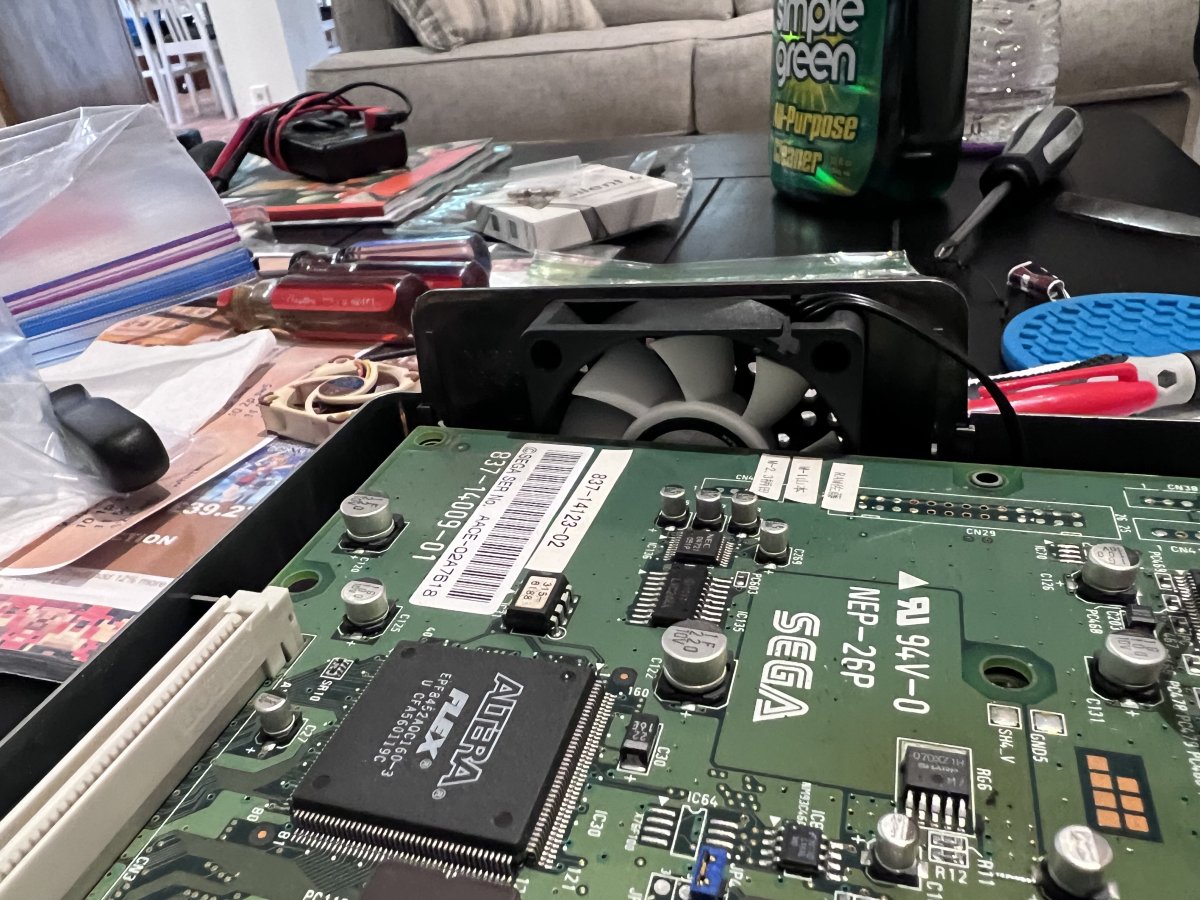

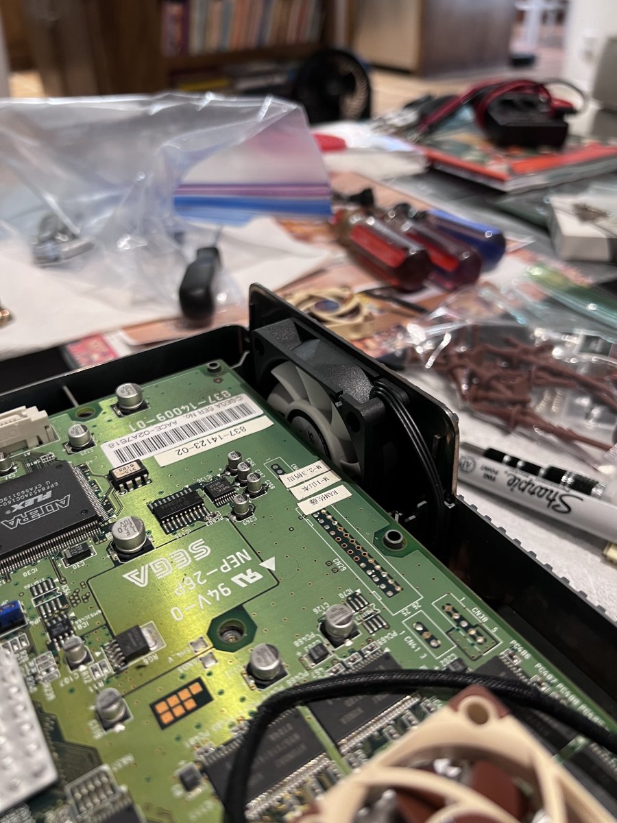

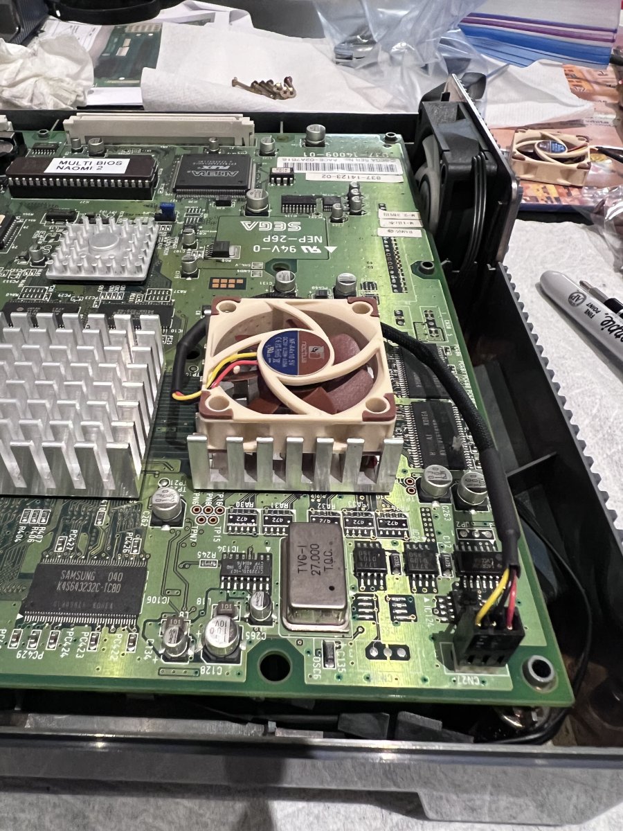

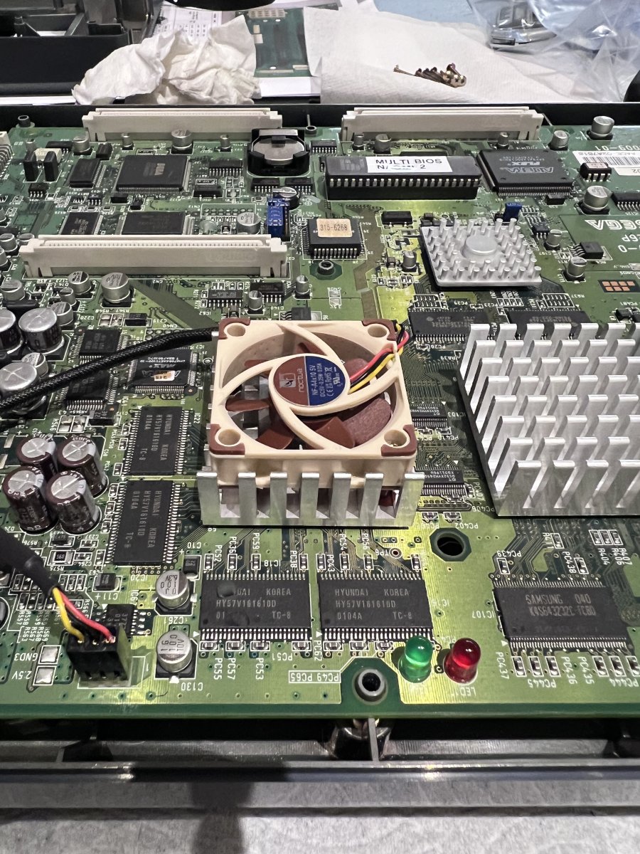

Didn’t realize these are the same Noctuas for the Dreamcast fan replacement. Since I have an extra I’ll be working on that next. Now that the Blast PSU, Sun PSU, and Naomi 2 all have new quiet fans it sounds like a dream and not like a rickety jet. Thanks everyone for showing me the way on these mods. Bought a noctua for my PC case as well lol.
I also found that turning the Naomi 2 Noctuas sideways (I did this to make the cable stretch and look neater) made them fit snugger into the heat sinks. Not sure why if they are square, but they are snug enough to where I may just leave the stock screws in there and I don’t think they will be moving much.

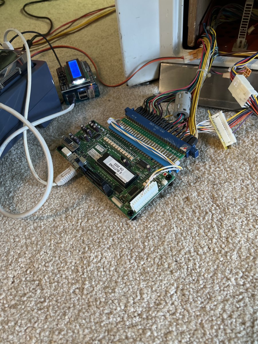

You can reprogram buttons on the fly without wiring with the RECO. It also has CPS2 edge as well as a few other features.
I would like it if he made a version without the JAMMA female and solder posts so I could upgrade my jamma connector permanently.
if you decide to -purchase lemony’s connector. I can attest to his build quality. He also sends some sweet slaps with his order
I was able to connect buttons 1-5 thru p1 harness just for testing and all those buttons worked fine.
Tried jumper A and B on Sega JVS / IO board with no change.
Will be purchasing lemonys adapter asap.
Just still bummed thought I could get it working without it.

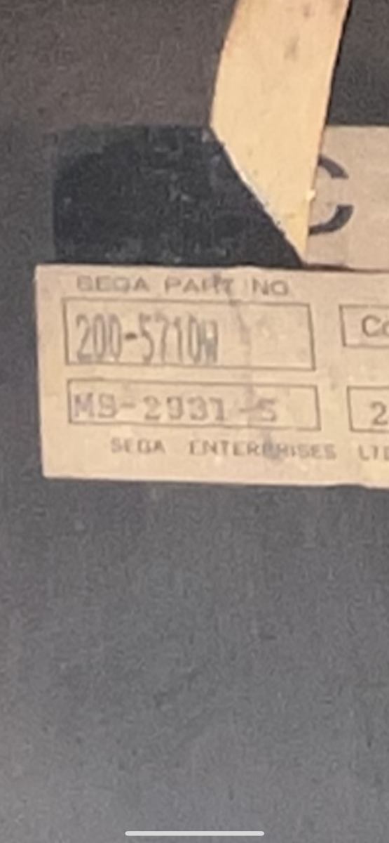

Finally figured out my model of monitor. Not sure how this differs from the other Nanaos.

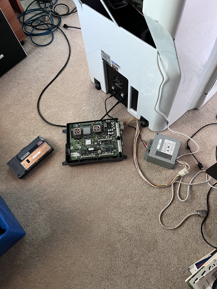

Ordered my internal power adapter and kick adapter from lemony. Hope these are the two last pieces minus the monitor repair 🤓
Is there a way to get Virtua Golf to work? Not sure if it’s a net dimm incompatibility thing or I don’t have the right type of control setup
That would be an incompatible IO board, my man. Which one is being used, the JVS to Jamma io?
There's nothing wrong with that i/o, but you also need the trackball i/o daisy chained to play the trackball games.
