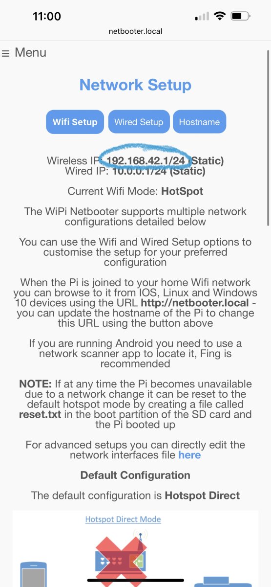

So I got the WiPi to work. I got a game to boot. But the problem is when I change it from WiFi Hotspot to WiFi Direct mode on the Pi I can no longer access netbooter.local
I tried changing wireless networks, maybe im choosing 5ghz instead of 2ghz
My router sees a device called NETBOOTER 10.0.0.51 but I can connect to it. Tried a million times.
Before I changed it the Pi said the Wired Address was 10.0.0.1 and the Wireless 192.168.42.1 but those didnt work either.
Im so close lol. It shows the device is allowed on my router and i tried to set a static IP to 10.0.0.51 but that didnt work either.

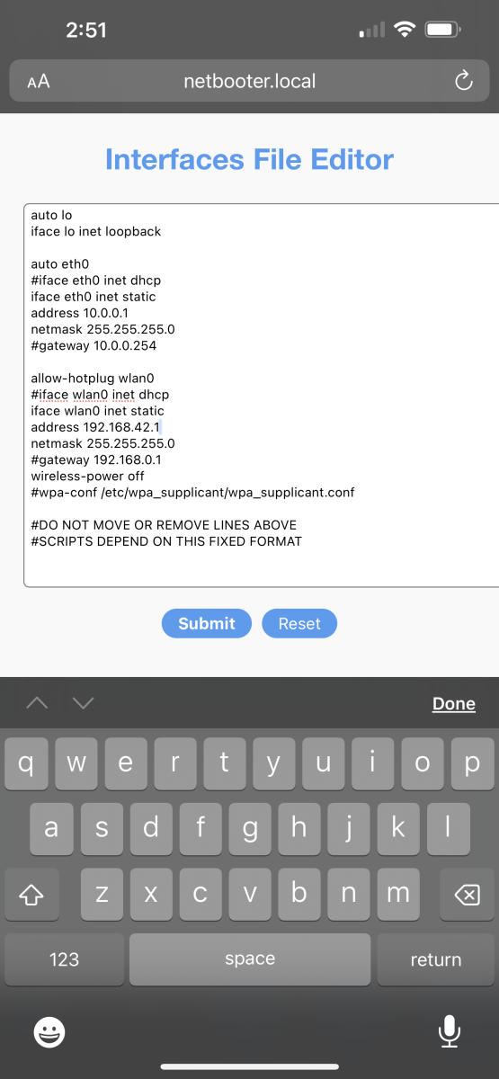

But it seems when I set a static IP using the network interfaces file for the wireless on the pic I can’t access anything.

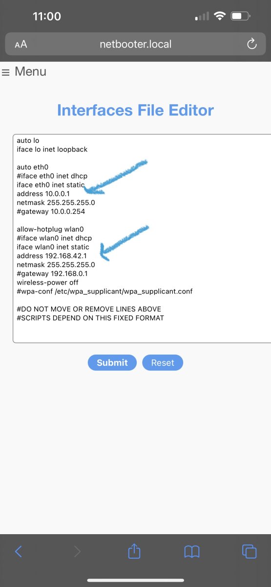

Here is my interfaces file. Any suggestion on how to edit it so I can use DHCP for the wifi pi address?
My routers address btw is 10.0.0.1 do I also need to modify the gateway section to 10.0.0.1?

Network Setup under netbooter.local said
Wireless IP 192.168.0.109/24 (DHCP)
Wired IP : 10.0.0.1 /24

Then when I scan for dimms under manage dimms it tries to scan 192.168.42.1 /24. So I also tried 192.168.42.2 and was gonna try 192.168.42.1 for the Pi.

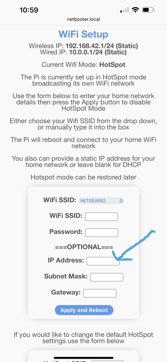

What is the correct way to update the static IP on the Pi? From the network interfaces file or from Network Setup -> Wired Setup on the netboot.local (pi)?

Is it normal for it to search 192.168.42.1 like in my screenshot? Other times it has searched 192.168.0.1 I think.
Also on the NetDimm scanner what determines the IP ranges that get scanned?
The others with arrows is this where I edit the Pi’s static IP for Ethernet and Wifi?
Main issue is everyone keeps telling me to the change the Pi’s Ethernet and or wifi address as well as selecting DHCP or static but no one has told me the correct way to do those things. The methods I’m trying don’t seem to work.

If you connect the physical interface of the RPi to your wired network, it needs to be on the same network as your gateway.
This way it doesn’t conflict with anything and is reachable.
The netdimm should be on this same network as well.
The wifi address for the RPi should be on a different network address scheme from your home wired/wireless network.
I get the impression he's got the ethernet cable directly between the pi and net dimm, and is trying to access the pi from his phone on his wifi network.
