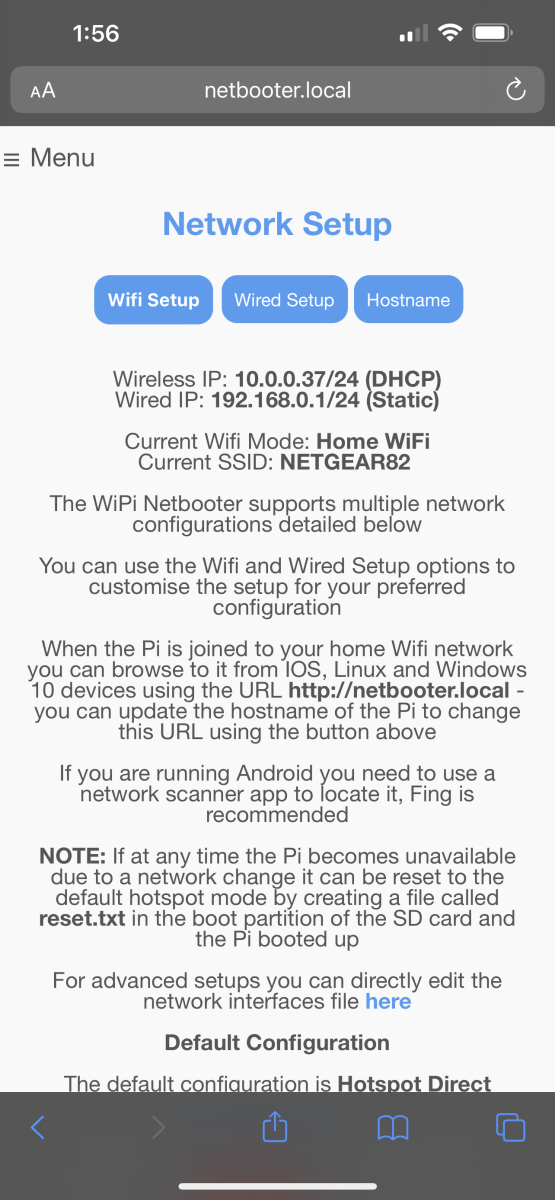

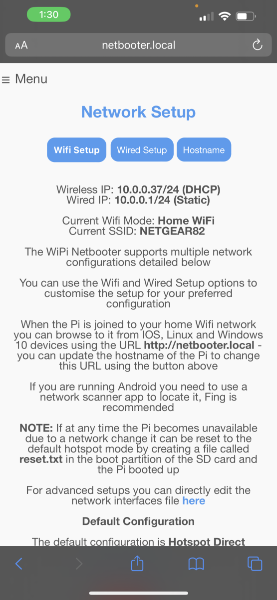

Do you have your wired and wireless backwards?
Your wireless is running 10.0.X.X right?
Screenshots above are showing the reverse?
Disclaimer, network settings really hurt my head... :unsure:
Yes all wireless devices are 10.0.0.x

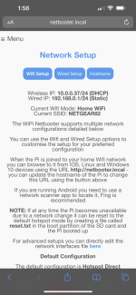

I am trying to access the WiPI from my phone without using hotspot mode. I want to be on any wifi network in my house and be able to access it from my phone.
Once I enter the SSID and pw I can no longer access it and have to reset the pi network settings.
I want to change the pi to 192.168.0.X but no one will tell me how to do that. They just keep telling me to do it. Lol. Plug in a keyboard and connect to a TV? SSH? Netbooter.local setting? interfaces file? Seems like a bunch of methods none of which I’m doing right.

Everything you are doing makes sense and it will really just fall on someone with the network know how to sort you out…

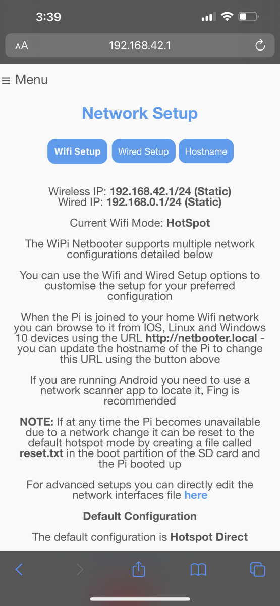

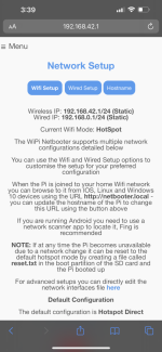

was able to get my WiPi to 192.168.0.1 with a gateway of 192.168.0.1 (I didn’t know what else to put) via diet-pi settings and net dimm to 192.168.0.2.
Net dimm adds successfully
But my wifi address on the WiPi is listed as 192.168.42.1/24 static.
Couldn’t figure out how to set the WiPi wifi to DHCP.
In this case I could connect to 192.168.42.1 and see the WiPi page from my home wifi which is great but it still was in hotspot mode and not technically joined to my router. Making tiny progress though lol.

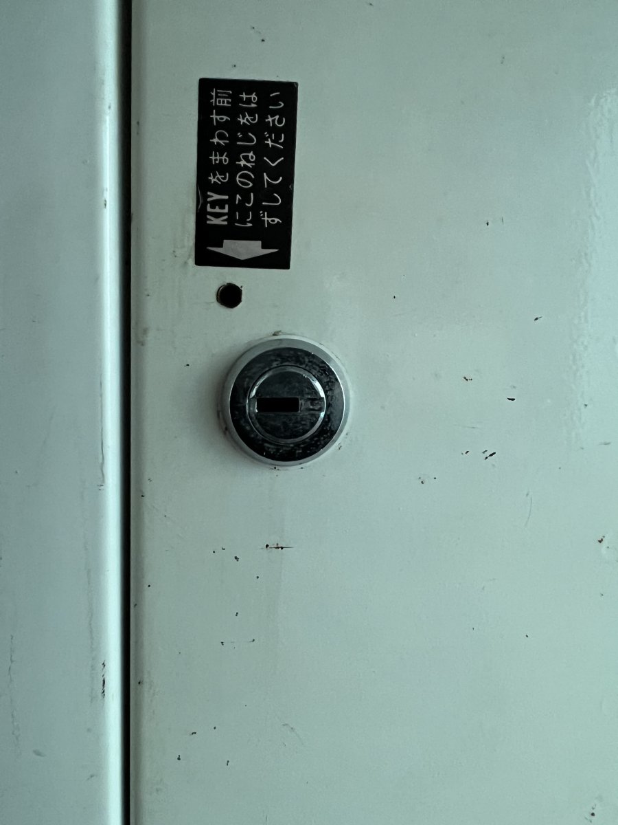

Kind of a minor detail but did I orient these locks correctly? That little notch thingie is it facing the correct direction?

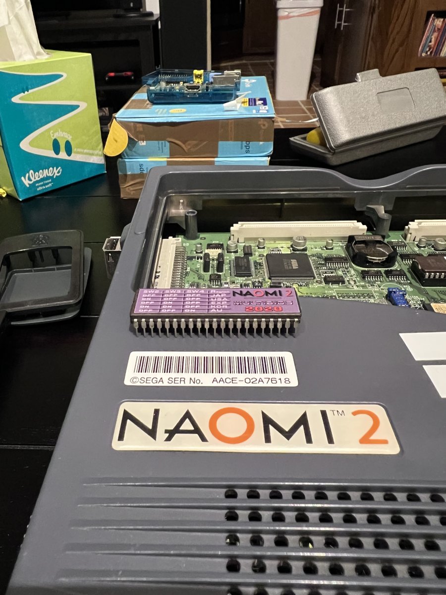

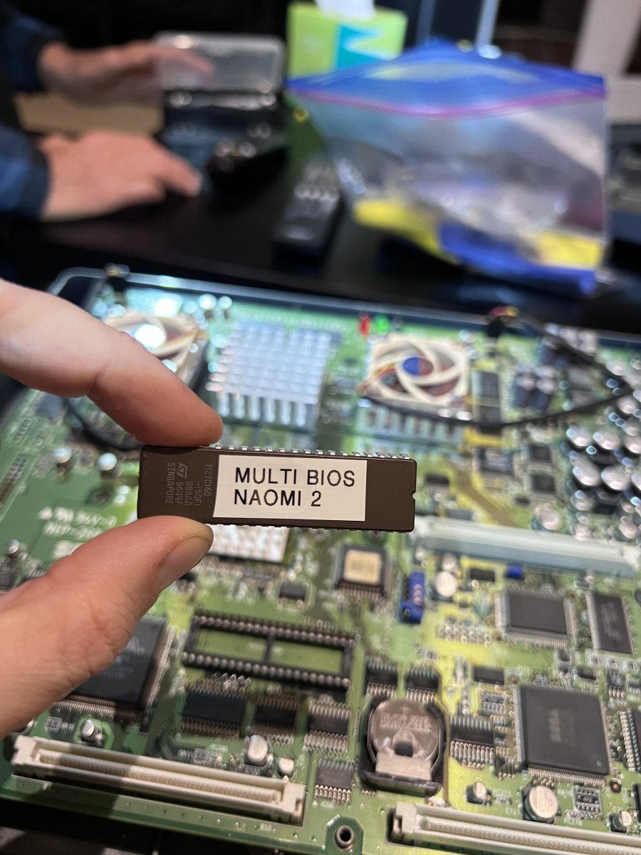

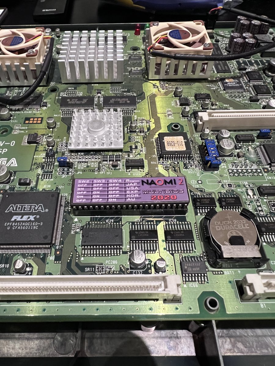

Not sure if I already had the newest BIOS with proper bootstrap or not so I got this off eBay and put it in just in case.
White one is the old one.

Not sure if this is the easiest way to check, but just try netbooting any of the Atomiswave titles and then switch out another game.
