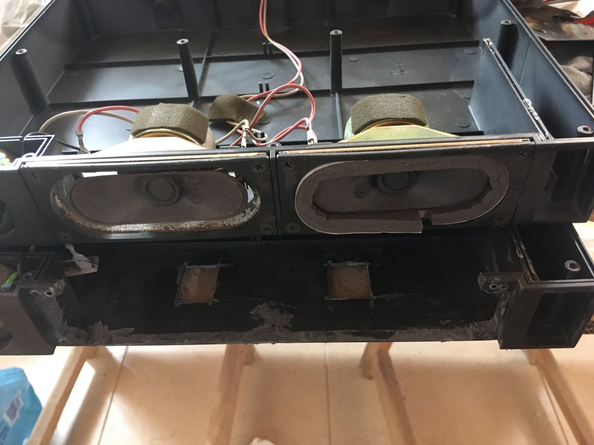

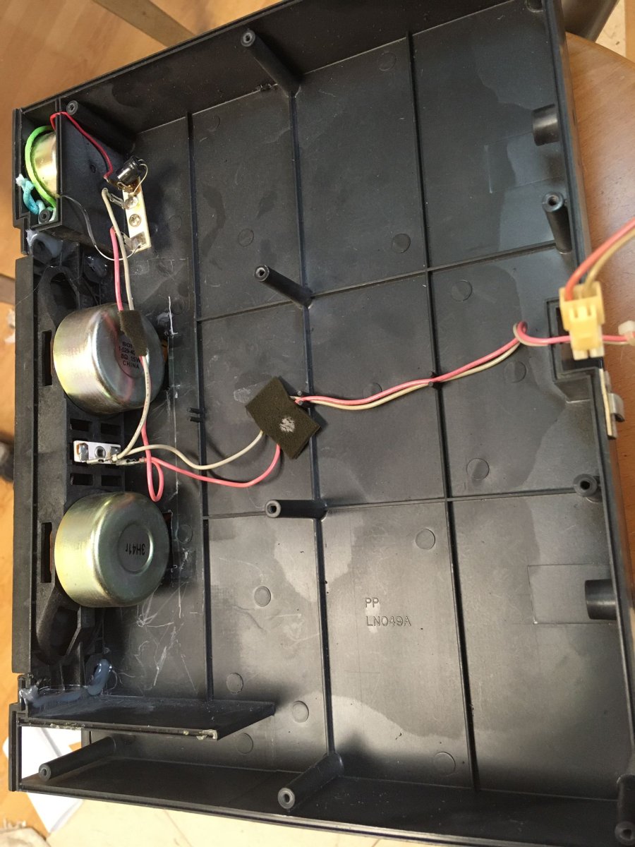

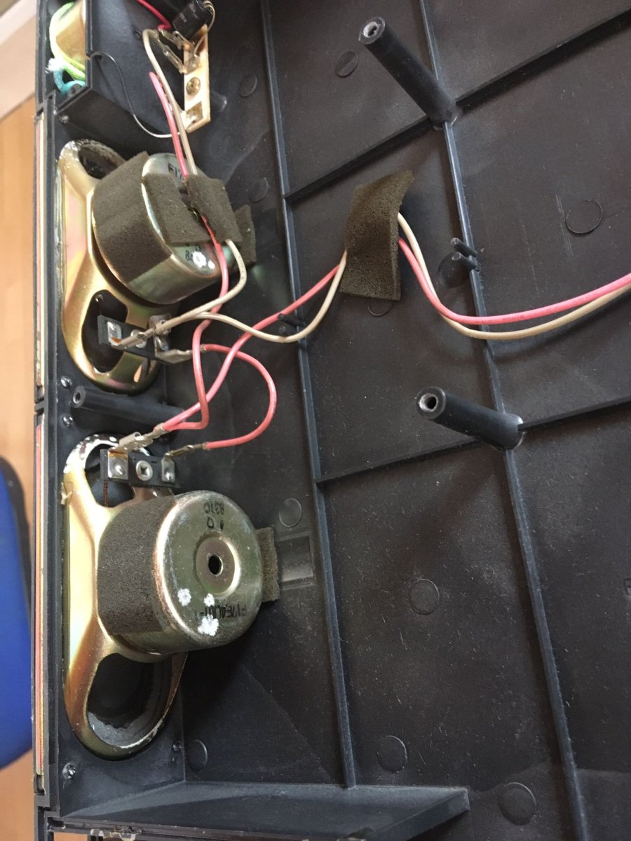

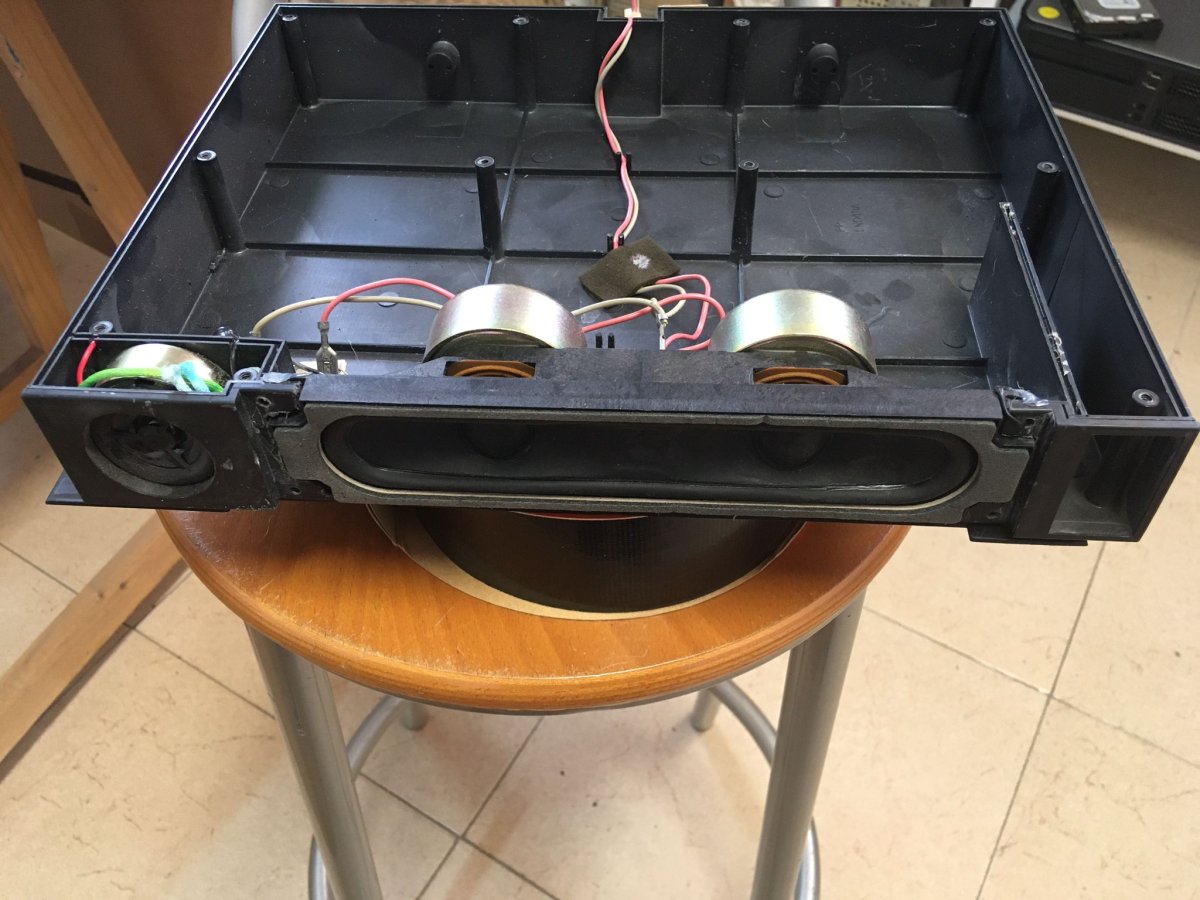

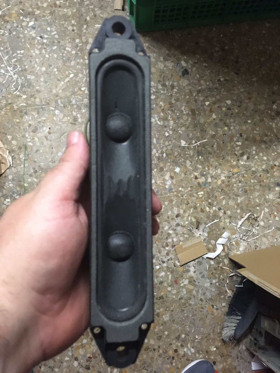

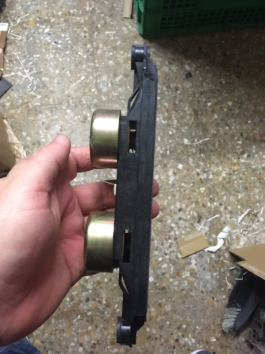

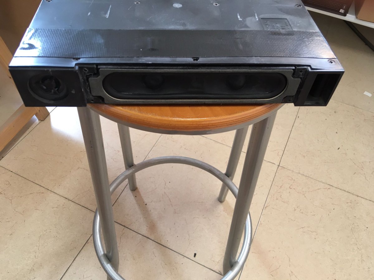

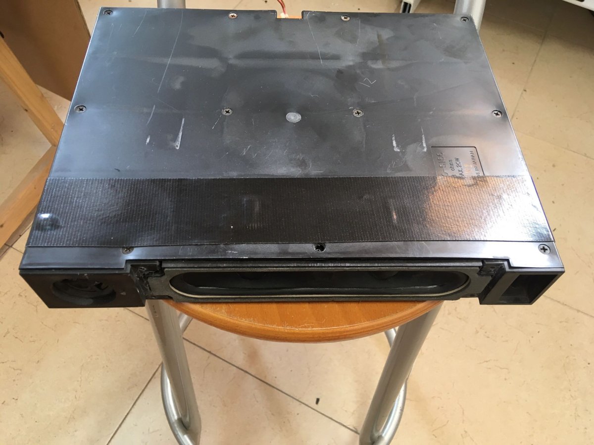

Hi everyone,
Sorry for the intrusion, I wanted to show you my personal solution to the common problem with Blast City speakers and similar Sega cabinets.
There is no simple solution, changing a speaker for another exactly the same is impossible, this speaker model is not available, at least for me.
After many tests and a lot of time invested, this has been the option I chose...

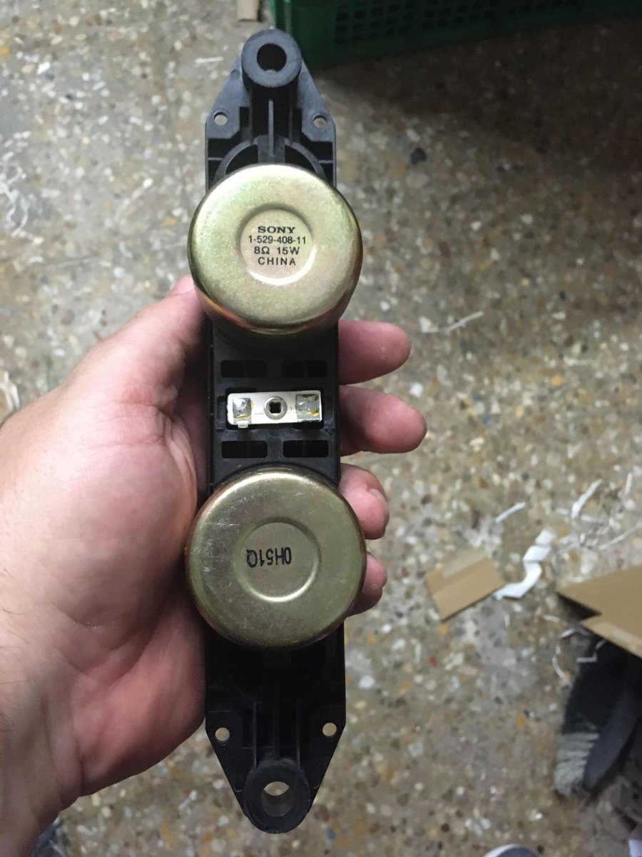

Need some more info. Model #? Shielded speakers?
Interesting, are those from a Sony sound bar?
I don't know what equipment they come from, they are used and I bought them at a television technical service.
Yes, they have the armored cone.

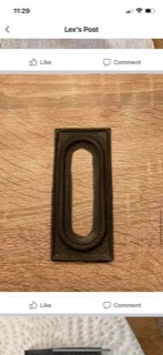

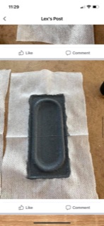

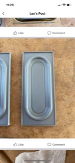

Were you ever able to create the model for the speaker?
Do you guys mind sharing the pictures you have and linking me to the group, please? I might give this model a shot.
Still haven't got round to it, all my gear is under dust sheets i'm afraid. The group was https://www.facebook.com/groups/429399407089518 but as far as pictures its only those in the post you quoted there is nothing else. Unfortunately the guy who made them didn't want to share, his response was it's easy to make (make your own).
That is incredible. It's been several years since I rebuilt my speaker modules, and I don't know if I saved the old drivers. If I did, this would be a really fun project to attempt. Thanks for sharing.
