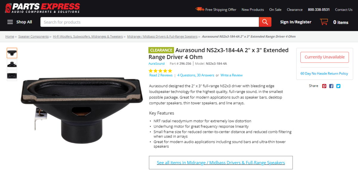

Parts Express no longer have them. Looks like we're going to need to find another alternative
They were out of stock when I was looking at them early last year, hopefully it's just temporary!
I think it's more of the "clearance" tag on them. When they were out of stock you could sign up for an email to be notified once stock was back
i bought 12 of these when they were in stock.
My speakers were fine to begin with but im "hoarding" them , for when the time comes.
Parts Express just tell me they will not receive some of them anymore ...So anyone know if AuraSound is a japanese company and how to get in contact with them for an order ..o buying other Speaker Combo with Box built in to fix in Blast near same place as the Guenine speaker Box .
