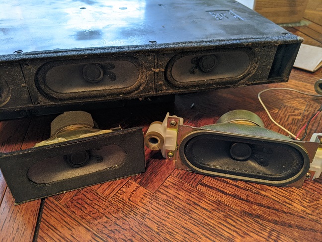

I was converting a component TV to use in a cab and when parting it out I noticed the speakers in the set looked like a good match. The speaker on the right in the pic is from the TV, next to a ghetto re-foam of an original Blast speaker. I did have to cut off the excess metal used to mount in the TV and drill some holes, but that was not a major issue. Unfortunately they are 8ohm but I just used one speaker in the plastic housing(and sealed up the empty speaker space). It seems to work good, better than that blown speaker farting that comes from rotted out ones.

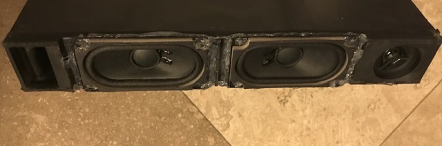

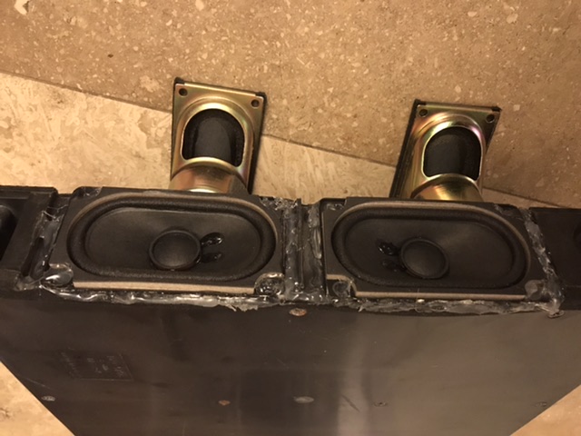

Thanks to notsonic’s suggestion two posts above, I installed four of those Aura NS2x3-184-4A speakers in my Blast City. They sound great and fit snug. I used a hot glue gun to completely seal them in for good sound and I didn’t use screws. The case itself screwed back together nicely. The speakers are a bit better quality on paper than the originals, easily plug into existing wire with the same size tabs, and best of all are a solid solution at a good price.
Photos shown of old removed speakers and new ones installed before and after using glue gun.
Cost shipped was about $32-34 shipped for the four speakers using a coupon.

Thanks for that. Parts Express does international shipping, so I'll go with these as well. I've been meaning to order some smaller speakers and 3D printing adapter plates for them, but I just can't get around to it. I'll stick them on with silicone.

Thanks to whoever found those Aura NS2x3-184-4A speakers. I ordered from Parts Express. They are a little wide, but the plastic speaker case bends enough to fit them. If you center them in the hole, the original screws wedge the speaker down perfectly. I used some black caulk to seal up the visible holes. I also added foam circles held down with a dot of hot glue to dampen the tweeters.

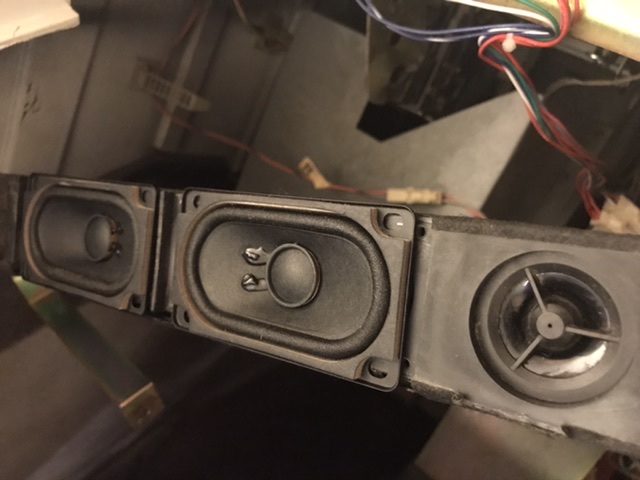

Pic of speakers before re-installing:
