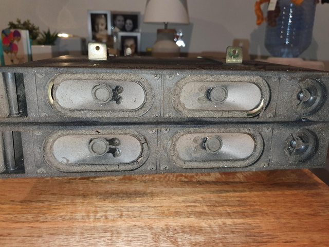

Just ordered 2 pairs of the Aurasound NS2x3-184-4A 2" x 3" Extended Range Driver 4 Ohm that has been recommended on the thread.
I disassembled the blast last night and found the speakers in this state
I ended up ordering 5 speakers as I would like to try and dremel out the sides to see if it'll make it fit better.
Since the speakers are 4 ohm, I imagine you just wire them up exactly the same as the stock speakers?

Yes, there is a small filter inside for the tweeter. But just wire them the way you see it. The speakers should be connected in series to present an 8ohm load to the amp channel. The tweeter is a bit harsh for my liking but necessary, you can try covering the tweeter about 1/2-3/4 to tone it down a bit if you also find it harsh.
