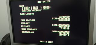

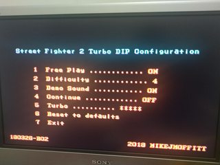

Hello @brentradio
I get the rom from Street Fighter II CE, but I have the same. I am unable to enter the "service" mode and modify some settings. My CPS-2 has a Neo Geo configuration controller.
Another game have the same behaviour as Street Fighter II Turbo.
It´s not a claim! It´s only to ask your guys if is possible some single modificatios to you "turn on" this feature?
A
Apocalypse
Hello @brentradio
It's not "turning on the feature" but rather adding it.
I see the SF2 Turbo is signed by its author, maybe ask him.
Anyway, I went pretty far on the C&D before and I thought "Dammit, I'd rather tackle it 100%!".
But then I couldn't find my files anymore… :(
But reading my (handwritten) notes it all seemed not that complicated (you know that feeling, at first it looks impossible and when you've done it once the following times seem like a breeze).
