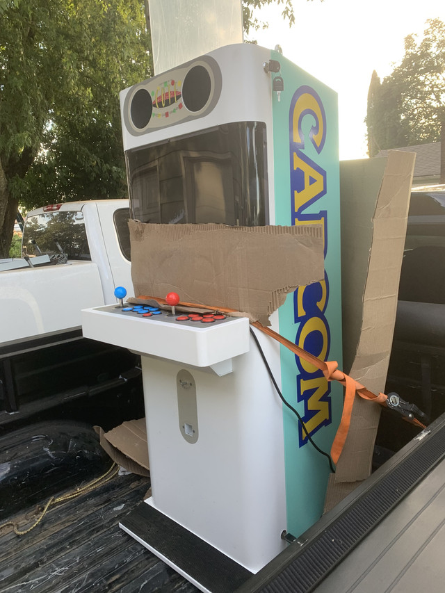

I cant use my "Arcade Cabinet" for the Jammaizer Mister combo because of load requirement of the PSU.
I ended up taking one of my Repro home for my living room and would love to order a replacement PSU.

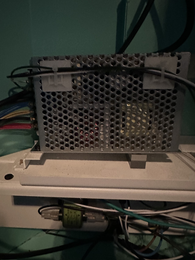

I installed my RT-85A.
It solved my issue with Wyvern where the controls weren't working.
One thing to note is this PSU is much smaller than the one that came with the kit.
I improvised with a couple Legos and mounted it to one side of the mounting plate.

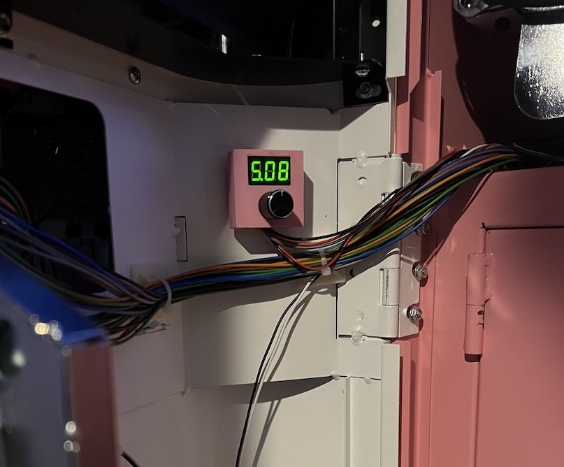

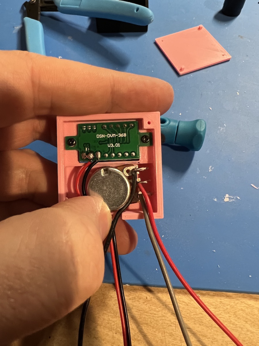

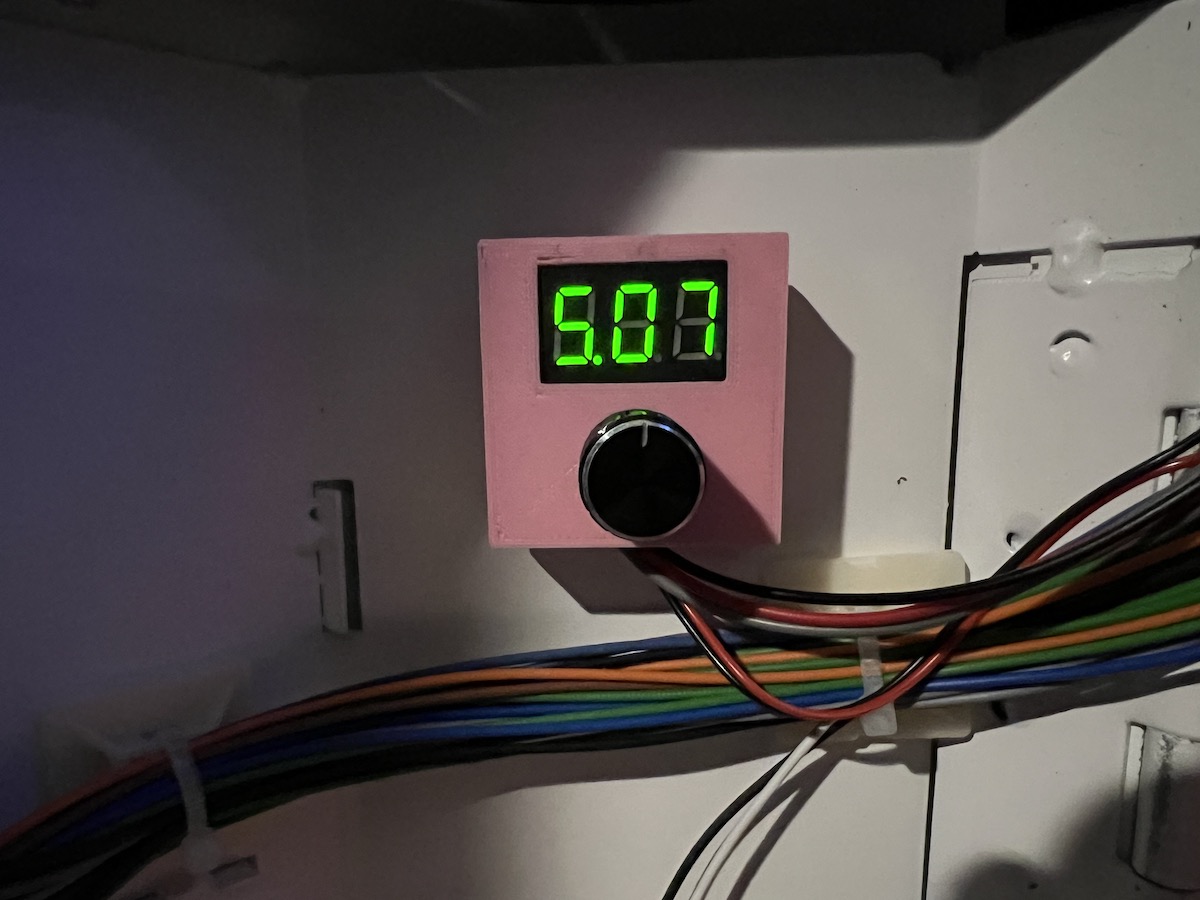

I didn't like digging into the back of the Minicute every time I wanted to adjust the 5v so I made this little remote box. Parts and STL on a longer post I made in the 3D printing subforum but thought other Minicute owners might find it useful.
This is hot! I’m going to install this in all of my cabs :)
Can you add a mount for a switch to swap between voltages?
Just thinking about it here… you would need to have two separate pots to keep the voltages where they needed to be after adjusting. The switch would be used to swap the LED between voltages.
But yea, that switch would work great :)
@Lemony Vengeance
Ok, back from holiday and thinking about your requests for the 5v remote box. Got the switches so I can incorporate them into the model and it's clear how you could have the adjustable pot for 5v input into the switch as well as the 12v and then whatever is selected is displayed on the LED. Cool. For the 12v however, I don't see any where on the PSU for one to adjust it so why would one need a second pot? Easy enough to add, but I wanted to see what I was misunderstanding.
oh, I was thinking more for JVS stuff LOL (so, 3.3v), sorry abotu that.
there really isn't a need to tweak the 12v voltage since it's usually just used for the sound amp on PCBs.
@Lemony Vengeance Ahhhh, I see. I don't run JVS stuff all that often so my head didn't go there.
Cool, so 2 pots, 1 LED, and a switch. I dig. Should be pretty simple to tweak the model.

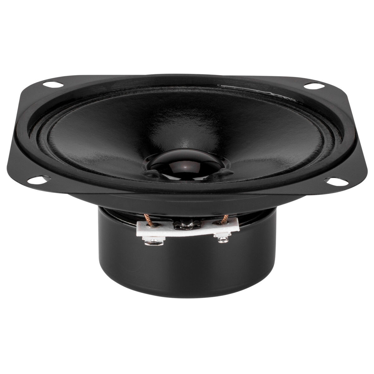

I recommend the Visatons. You will need to slightly drill the holes a little bigger, but these are shielded and sound great.
Shielded speakers should be used to avoid any electronic interference with the monitor.
Im sure there will be others on this board who have a different experience, but as some one who has seen this damage before...get the shielded.

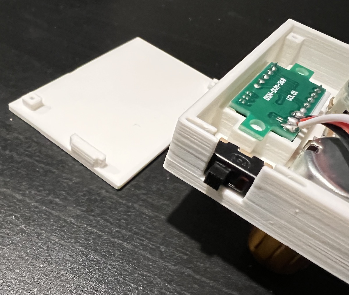

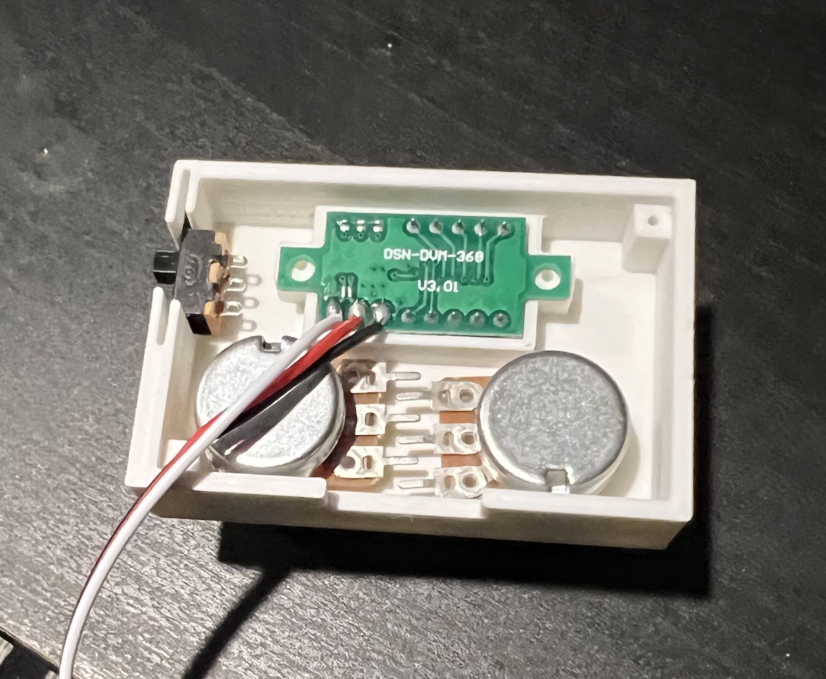

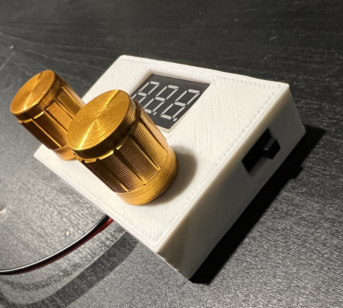

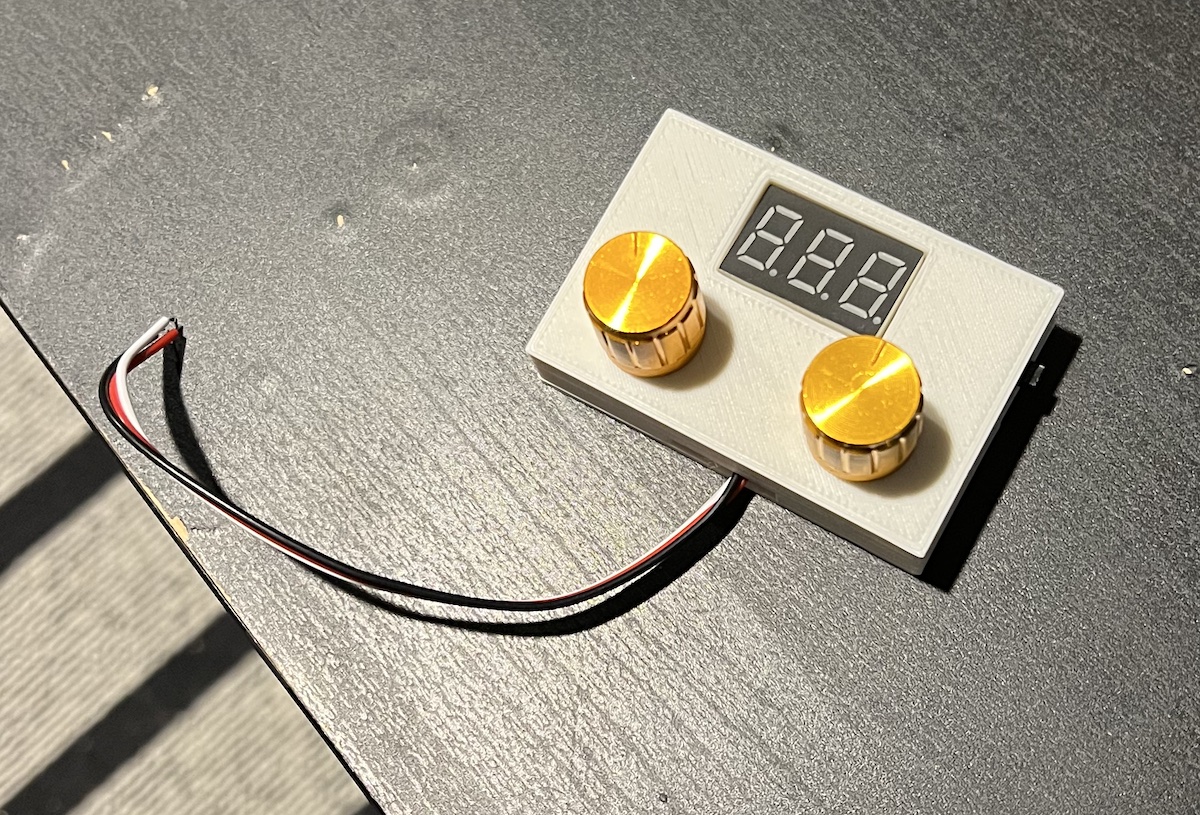

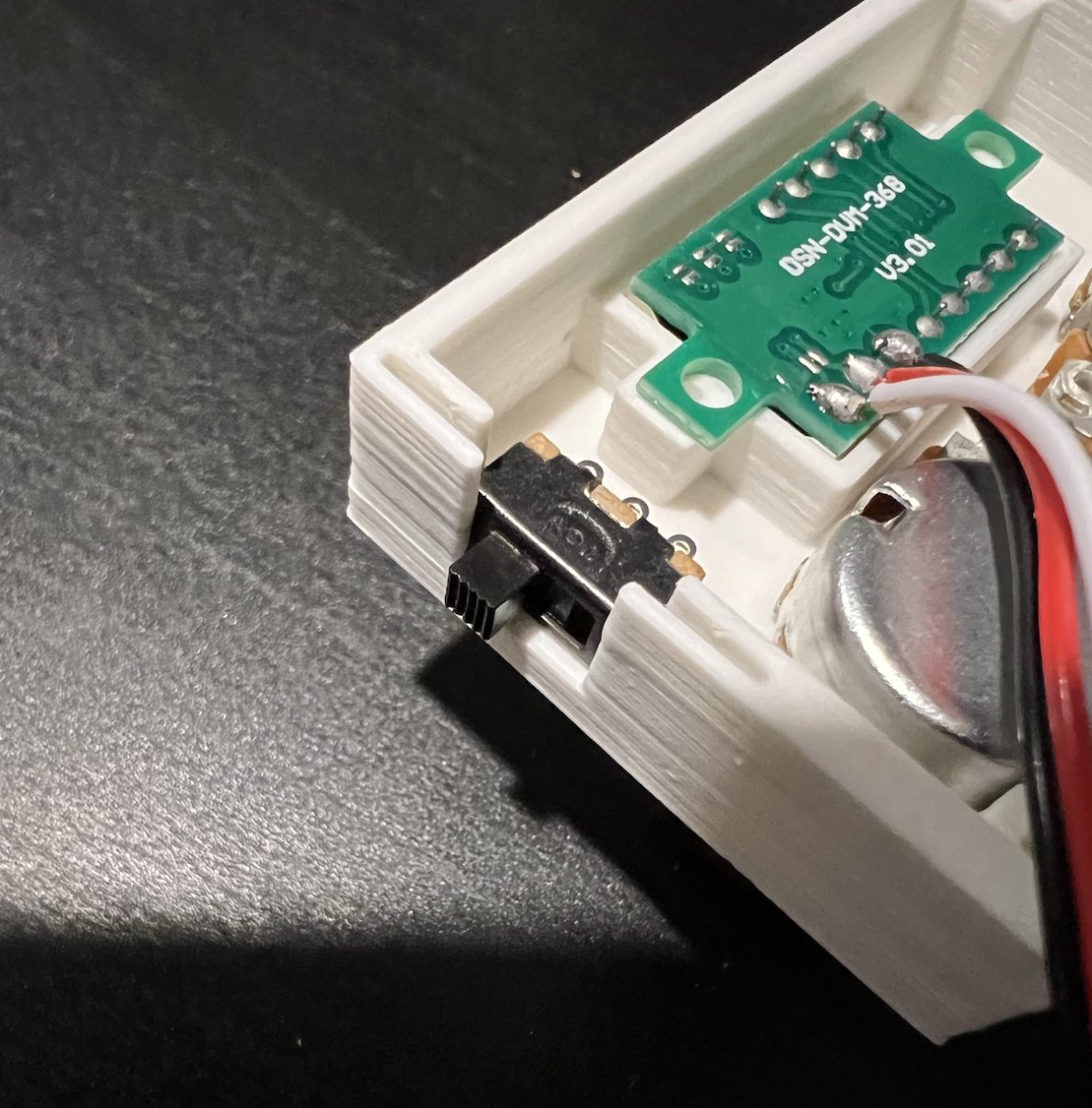

Hey @Lemony Vengeance I got to modding the 5v case to the spec we were discussing. 2 pots, a switch, and the voltmeter. Check it out and shield your eyes from the gold knobs, they were the only color I have left at the moment ;)
It's a little tight in the case but shouldn't be too much trouble wiring everything together. The only place that's really on top of itself is with the pots but I'd just snip the legs and solder closer to pot pcbs. I wanted to keep the case as small and symmetrical as possible so this is where it landed.
The case has a groove that the switch fits into very snugly then the back has a piece that pressure fits it when the case comes together.
Everything is nice and snug. Should work pretty well from what I see. Lemme know what ya think. Easy to tweak at this point.
