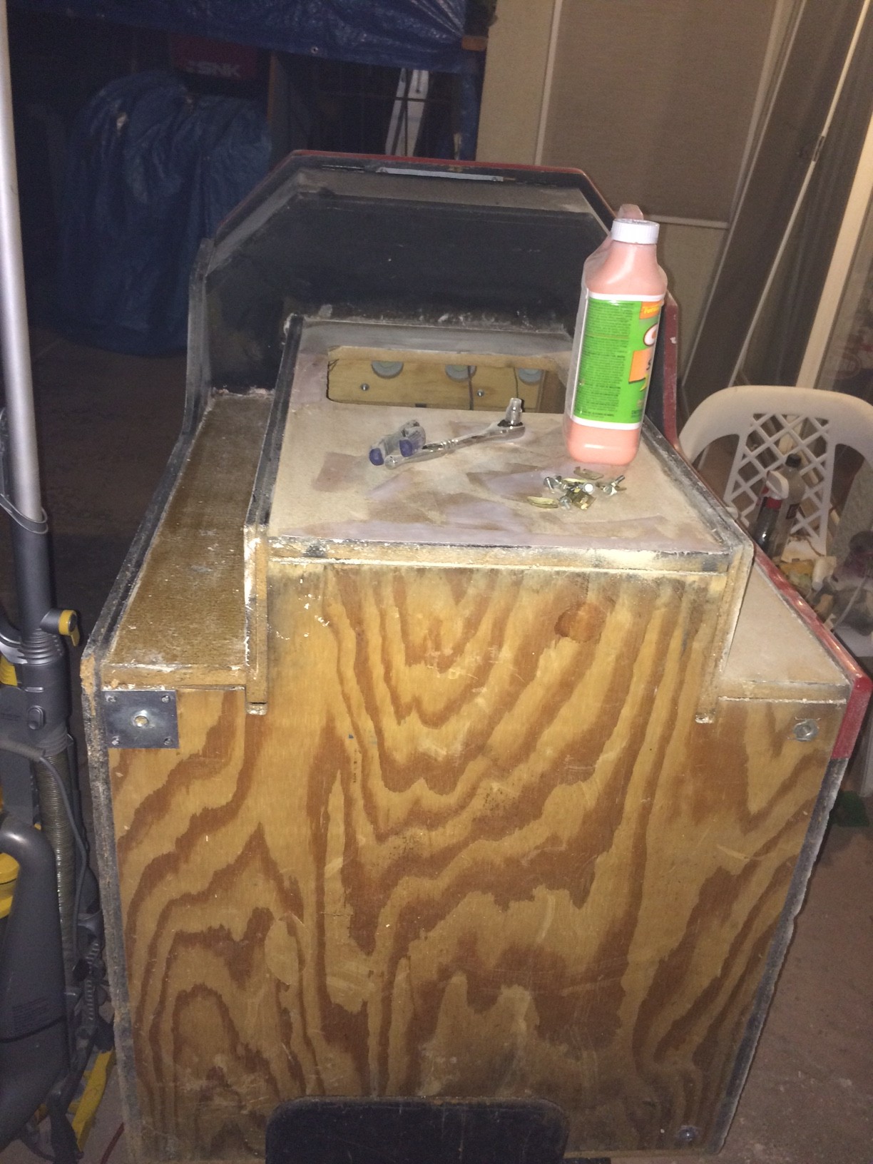

So after all the vinyl came off, I bondo'd the first skim coat over the coin mech security holes and did some spot body filling where needed. The bottom of this cab has no leveling feet for some reason. So the bottom edges of the wood look like they absorbed some water. I debrided the wood along the bottom edge with a metal brush. Then went to Home Depot to get some wood hardener. Will drip that onto the bottom edge with a straw tomorrow. Then will bondo that edge. Would be quite momentus if I can get one coat of primer on before this weekend is over. Stay tuned.
Alright, applied the wood hardener all around the edges of the left side of the cabinet with a straw and bondo'ed up the bottom edge, rebuilding the busted corners:

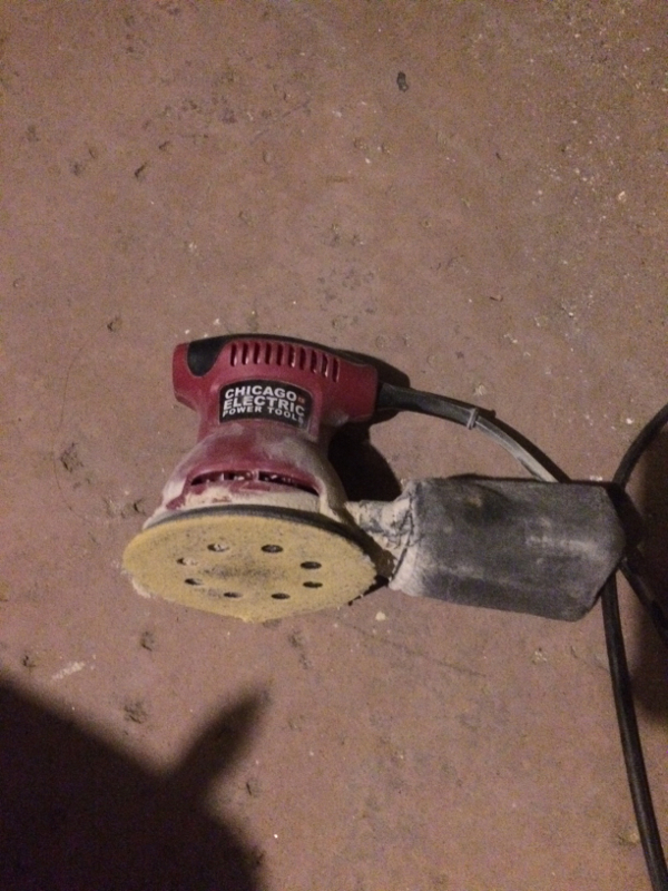

I must admit, this $20 random orbital sander from Harbor Freight kicks all kinds of ass for the price (less with the coupon). I have no idea how long it will last but so far so good. If you ever pick this up for one of your jobs, make sure you get the right sanding pads. Harbor Freight sells two kinds of pads. This sander takes the one with 8 vacuum holes.

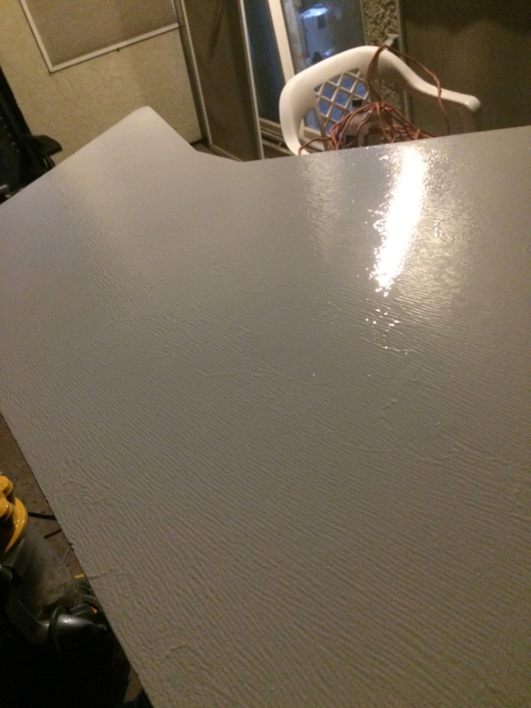

Was able to get a thick coat of oil-based primer on the left side of the cab. By that, I accomplished my mission for the weekend. Weather plays a part here. Temperature dropped significantly in just one day. I think I needed to thin the paint with a solvent on the first coat. It didn't self-level and I got a lot of orange peeling. I don't think that is too bad however. I am going to sand the first primer coat with 100 grit->220 grit anyway. If I have to apply a second coat however, I will definitely thin it.
*Remember guys, if painting on wood, use an oil or solvent based primer. No water based primer as it will expand the wood and ruin your efforts. Once you have the oil-based primer, you can paint over it with a water based paint.
Hey hey hey, look at that rebuilt-with-bondo-corner!! (Ignore the orange peeling though :/ ).

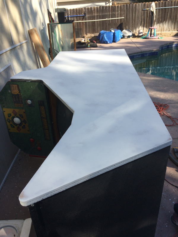

After two days of drying/curing outside, the primed left side of the cab was ready to be sanded. Did I say the cheap Harbor Freight random orbital sander kicks all kinds of ass? Well, here is the proof. You saw all the orange peeling i got in my previous photos right? Well they were all gone in short order; about 15 minutes of total sanding done in like 3 minute spurts while I was working from home today. This was all done with 150 grit sand paper. Since this is not going to be a finish layer, I'll skip sanding further with 220 grit.
As you can see, I did sand down to the wood substrate in some parts. I did forget to mention that while I was working on this cab about two weeks ago, it was exposed to rain!!! Good thing the rain woke me up and I was able to pull it inside and dry it off. Some damage was done but I am think I saved it. But seems there was some expanded wood in some areas. Otherwise, this is very smooth. Temps are dropping here. I am going to get another coat of primer on tonight after all the trick or treating is done. I'll be sure to thin primer to get to the consistency of cold milk to avoid the orange peeling and allowing an oil based primer's natural leveling capabilities to work it out. Then sand. If I have full coverage after sanding the 2nd coat, then this side is fully primed and will be ready for painting. If not, then there will be a 3rd coat of primer on this side.

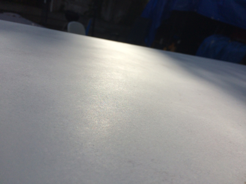

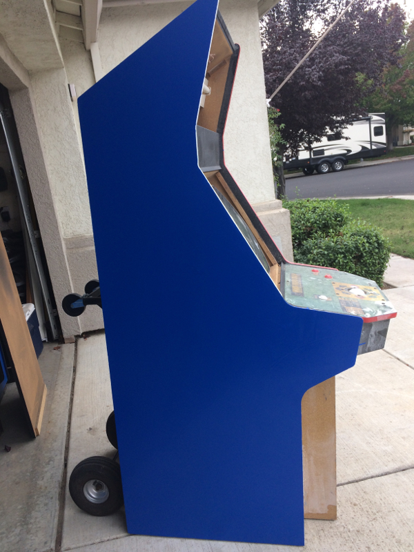

I sanded the 2nd coat of primer today and am left with full coverage of the primer on the left side of the cab! So there will be no 3rd coat of primer needed. Here are some snaps:
I did try to go straight with 220 grit after the 2nd coat of primer. But the cab just laughed at me. So I regrouped and hit it with 150 grit. The sanding with 150 grit was arduous compared the glide back over it with 220 grit. But both were necessary. So remember 150 grit, then 220 grit. Here is a closer snap shot of the cab glistening in the sun so you can see how smooth this is.

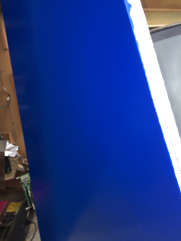

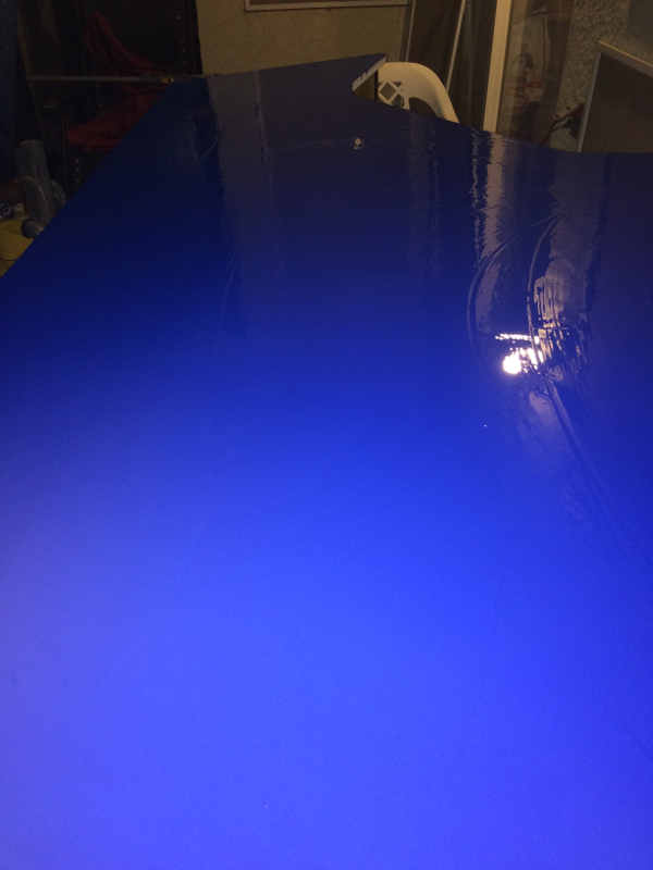

Alright, here are two shots of the 2nd coat of latex paint while still wet. I had planned on not sanding between coats because I feared accidentally sanding down the the primer. But as I was applying the first coat with a 6" foam roller, I got tiny air bubble city everywhere. I sanded lightly after the first coat just to get rid of the bubbles. Then applied the 2nd coat with sponge mapping motion. I did this by using two hands. One to hold and move the handle, one depressing the foam roller so it wouldn't roll. I ended up getting what I wanted. Shot of this when it dries tomorrow. Then I have to go into hiatus since it is going to be raining this weekend.
Alright, latex seems to level out a lot better than oil. Oil-based paint has a better reputation for leveling out (I could be wrong) but in this application, the latex did better. Must be the cooler temps, or maybe I have it backwards. I think I will add a 3rd coat without sanding before I get to sanding. I see some primer showing through in some spots. It would be disastrous to get to sanding and hit the primer. The orbital sander would drive the white primer into the blue paint, then I would be forced to prime and paint all over again. Better to add another coat to be safe. Here are some pics:

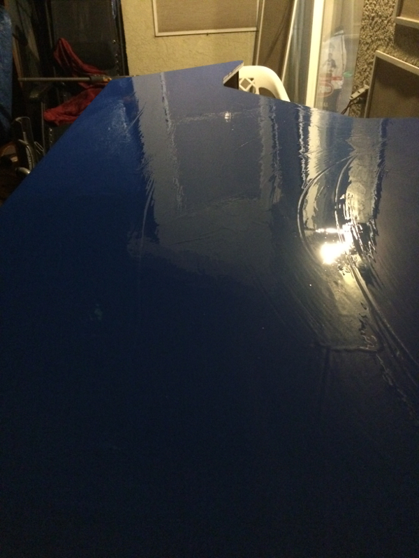

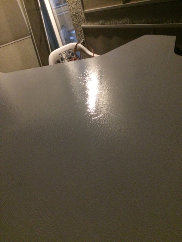

I wet sanded the 2nd coat of rolled on blue paint to get the high paint streaks off before moving onto roll on another 1 or 2 coats of the latex paint. First time I have ever wet sanded any paint application. The process is pretty simple. I have two sanding blocks. One is a 3M block from Home Depot and one a half-as-expensive one from Harbor Freight (love that place) that is of equal quality. I loaded one block up with 400 grit to knock down the high paint streaks. The other block was loaded with 2000 grit to get the final smooth finish. Having two sanding blocks works out great since sometimes you miss spots and have to go back with the lower 400 grit block as you go along. Saves the trouble of swapping out sand paper at a cost of three extra bucks for a 2nd sanding block. Sprayed a concoction of tap water mixed with a few drops of dish soap at each sanding location I was targeting to sand and Daniel-san away I went, alternating between the wax-on/wax-off circular technique and the up and down paint-the-fence technique. Whenever the sanding block got stuck, I sprayed more of the concoction to get it moving again.
I must say, the whole experience of wet sanding sucks really bad. I think I went through 3 rolls of paper towels since you have to wipe as you go along or you'll have an even bigger mess. I still have paint drips all over the place. My gloved hands still have paint on them. To top it all off, it was arduous to boot. I dug down to the primer in some spots, so this definitely needs a few more coats of paint. Here are some pics and my verdict of where I want to go from here:
As you can see, the vibrant blue is gone. Even though the surface feels as smooth as a Formica counter top. I think I am going to regroup from here and put on the brakes regarding this roll on painting technique.
