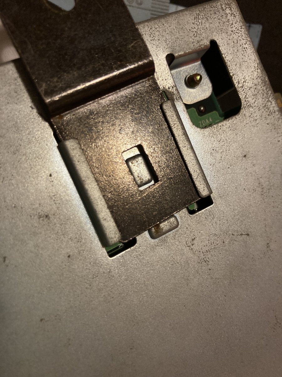

The tabs for the Capcom IO are wider than the Capcom CPS-2 feet. I have a bunch of feet for CPS-2 and they don’t fit right in my Capcom IO at all.

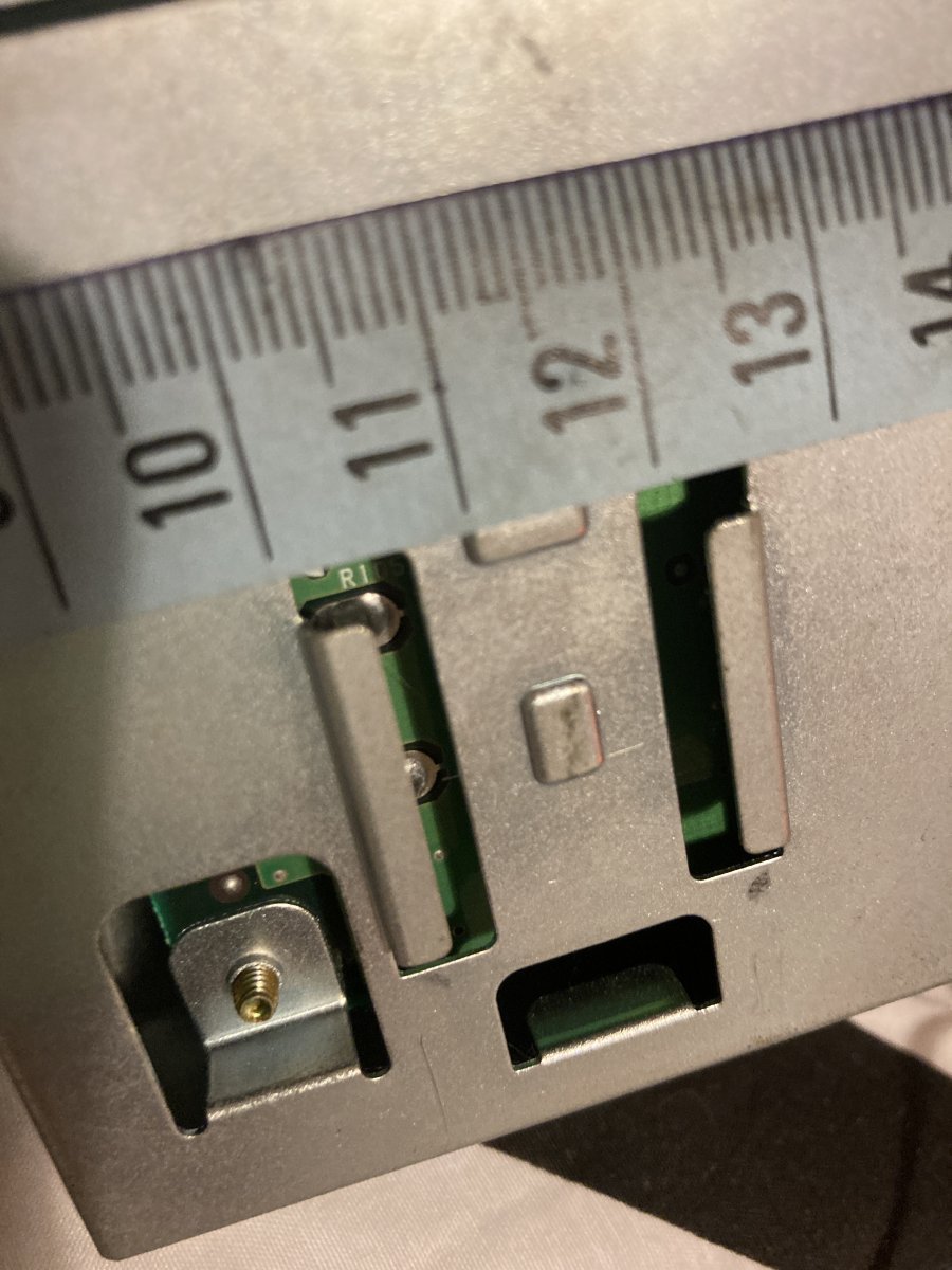

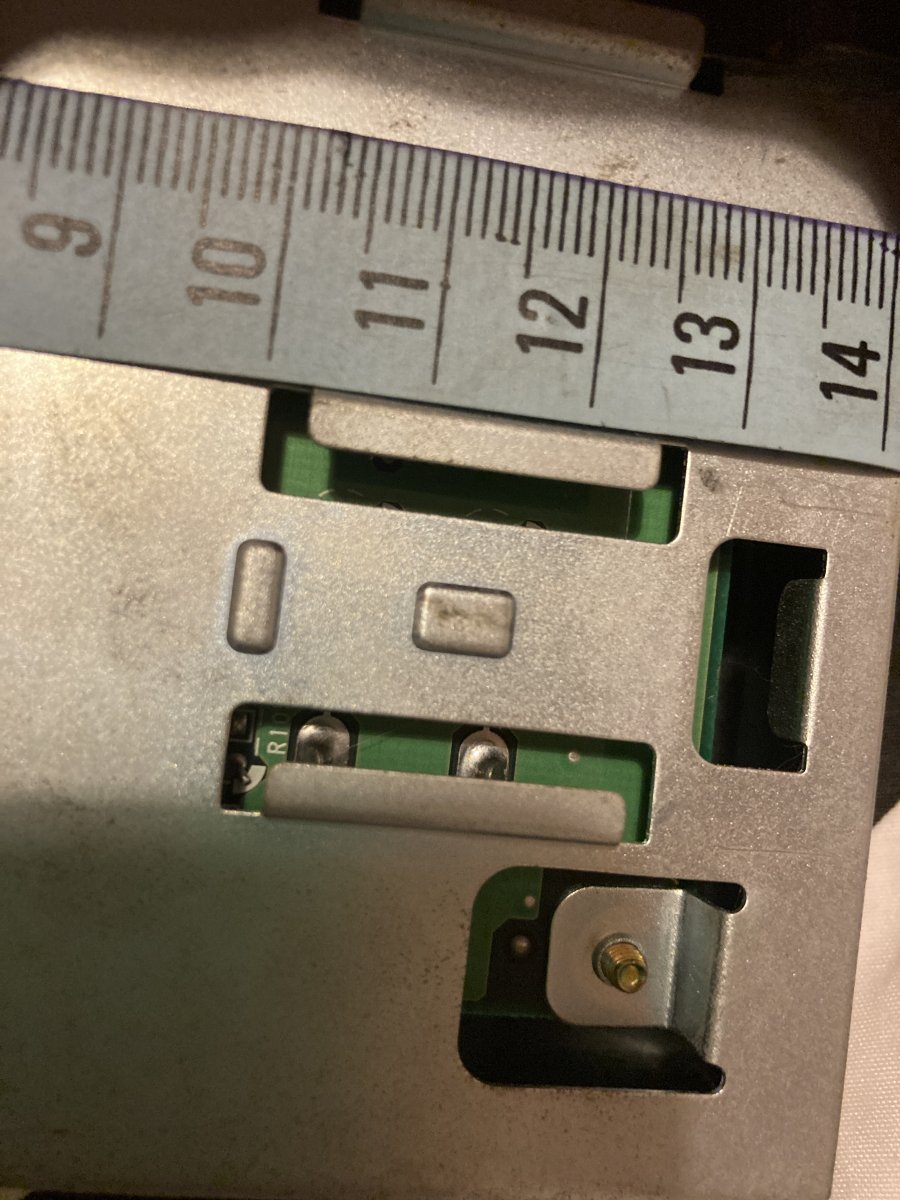

Aha, I had no idea. Can anyone take measurements with a caliper?

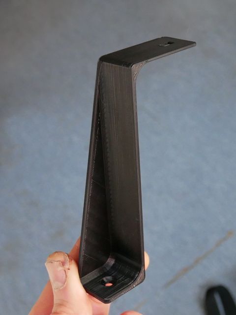

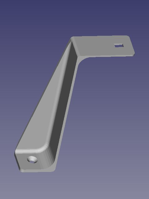

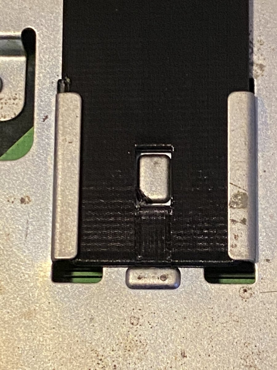

I love the latest design. Thanks so much for doing this!I just finished test printing one. Feels pretty solid.
can you negative scale it to mirror it over the axis you need? like 1:-1:1 to mirror the y axis?These look and feel good! @nem If you could do a design with the support on the other side. We can print up 2 of each type and keep symmetry. If you look at pic#2 on the left we see the front side of the mount and on the right we see the back side. After that I think it is a done deal. Thank you for keeping the designs coming!
