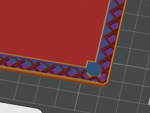

I printed the model cut in half at 0.2 on a A1 mini.

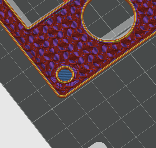

I think I found my problem - the slicer adds wall structures over the holes after cutting the model:

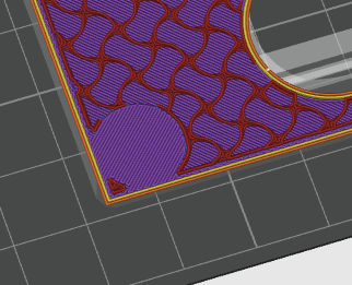

on your original file those structures arent present:
no clue on how I can fix this in the software :(
If you can easily upload your other variant, I could try slicing the model with it and see if the structures get added as well.

I found out what adds the structures over the holes:
Bambu Studio suggests to repair "non-manifold edges" in the model. Doing this causes the closed holes.
I will try to print without repairing the model error.
