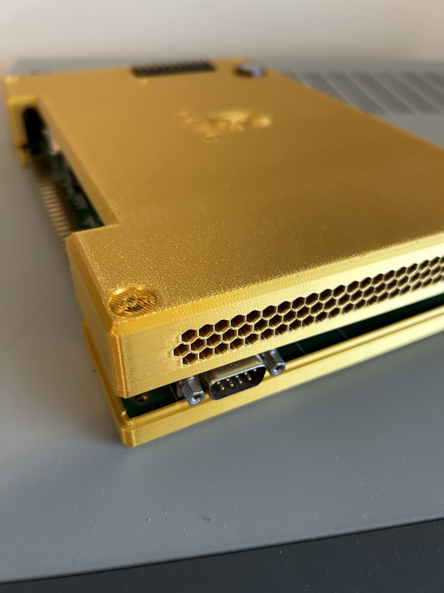

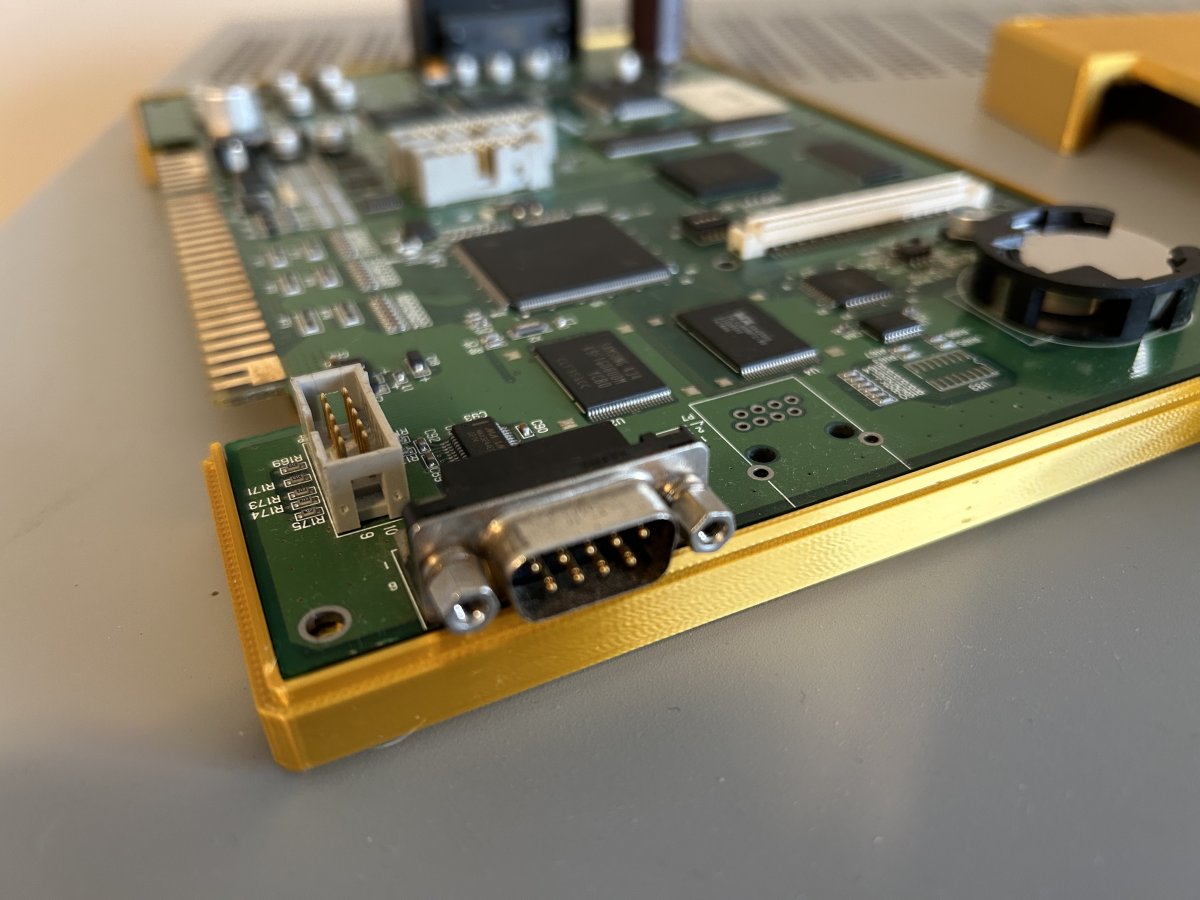

This is a great case. Thanks for sharing the model. There is one outlier pcb, mushihimesama, that has the vga port populated:
Should be pretty easy for me to make an adjustment for this, can you measure the height of the dsub connector?
the metal plate of the connector is 30.9 mm x 12.6 mm, which covers the footprint. Thanks in advance!

It’s technically a serial communications port - maybe Cave had plans for linking two boards together early on. It’s definitely deadweight in the final release of Mushi though.
Uploaded the new variations to makerworld, it should be pretty generous clearance, but none of my pcbs have a DSUB connector to do a test fit with. To be safe it would be worth chopping up the model in the slicer and just testing the spacing first before doing the full print.
