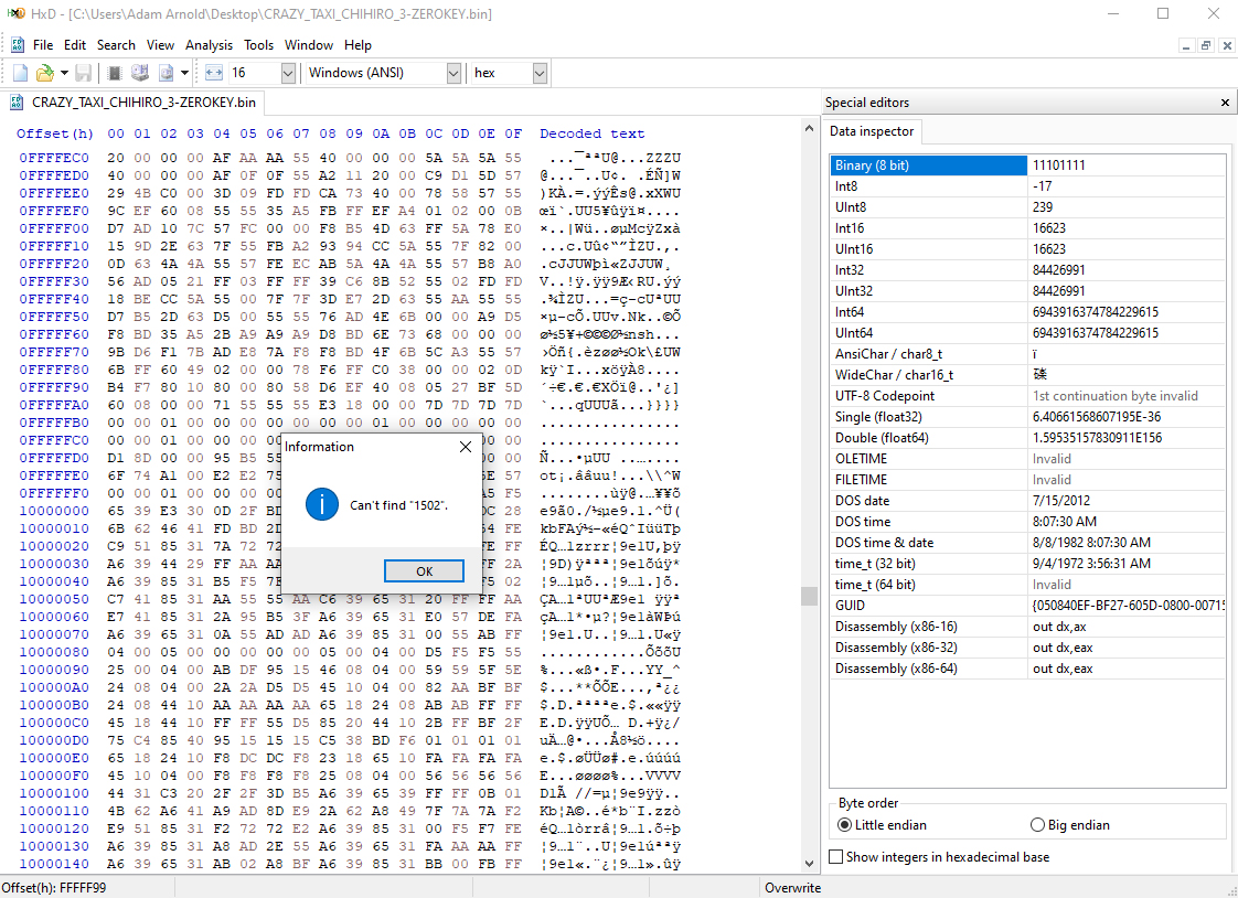

I'm trying to do this and am a bit confused also as it's been forever since I've used HxD. I'm not clear on which Offset line relates to "0x1502E" for the Crazy Taxi fix and trying to find "1502" in a search doesn't turn up any results. Would it be possible to get a bit more direction on where the lines are that need to be changed? Thanks. ?(

IT's 1502E, not 1502. And that is not a sequence that you need to find. It's an OFFSET as @skate323k137 very well said.
use blue coordinates in your screenshot as a map. Scroll up to 00001502 and look over to column E. If it reads 00 change it to 01.
Okay, that's starting to jog my memory.
I only see an offset lines for for "00001500" and "00001510," though.
Do I have my view HxD settings correct? (Screen cap below.)
