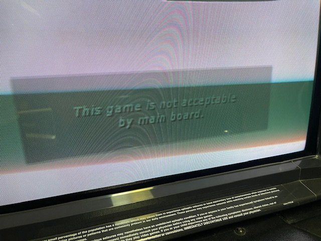

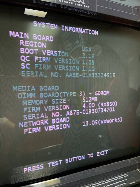

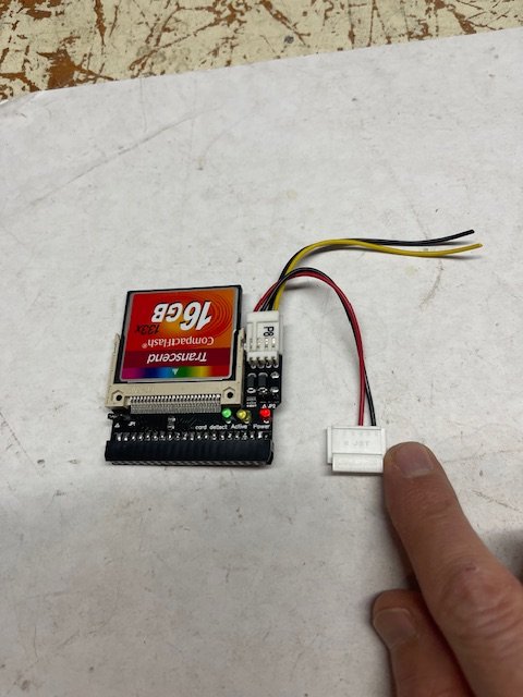

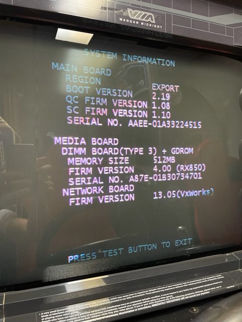

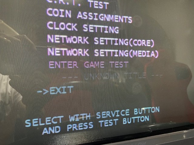

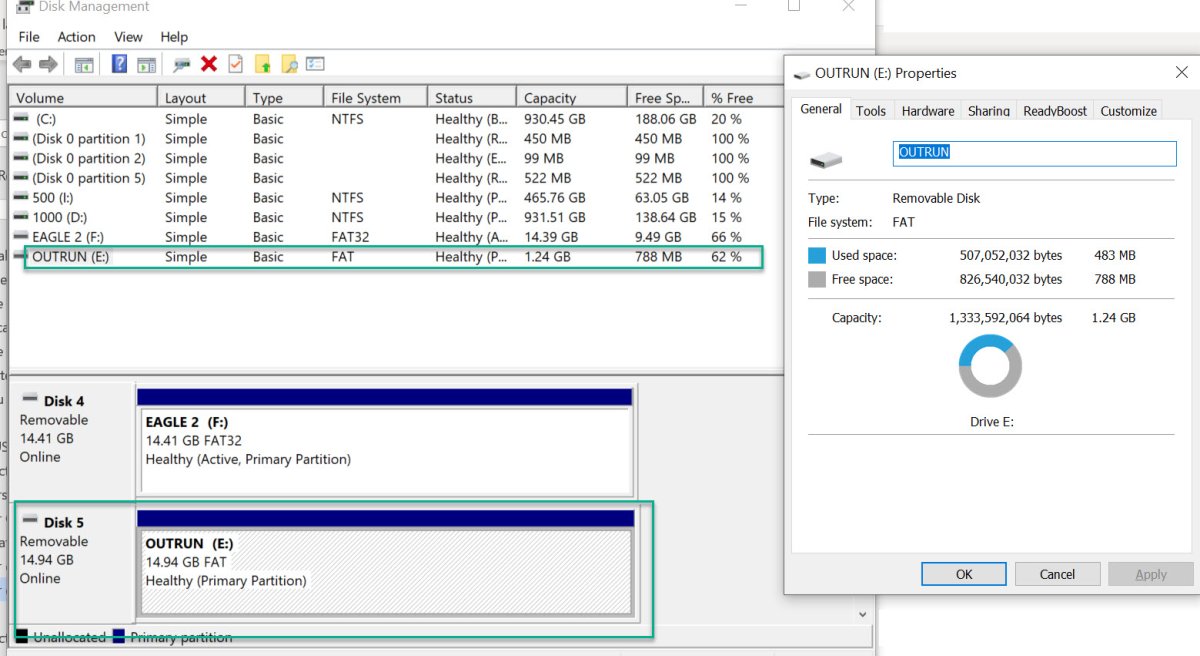

I've read through this whole thread again and couldn't really find an answer. I know this is a "Naomi CF Tool" but I'm wondering if anybody else has successfully burnt other chihiro images?

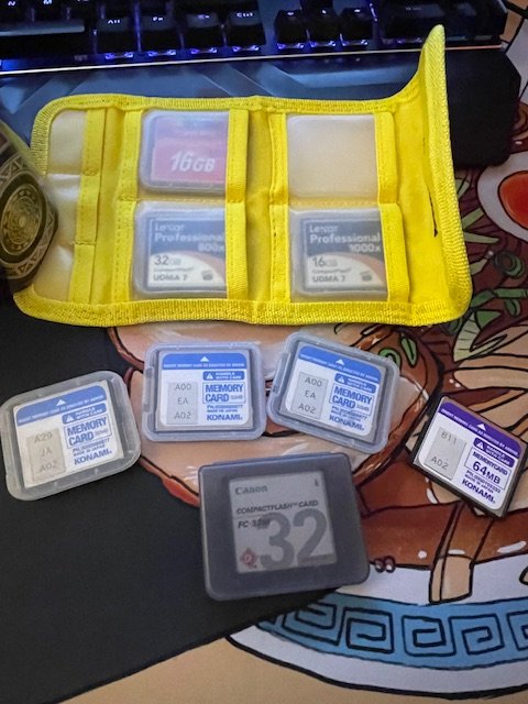

I've tried to write the files below on the same sandisk card and haven't had one successful game written (files are the extracted files from the WiPi image)
Any suggestions? Is it possible I'm using the incorrect files?
Edit: it seems generic cards are the answer for this particular system and card reader as per my findings here

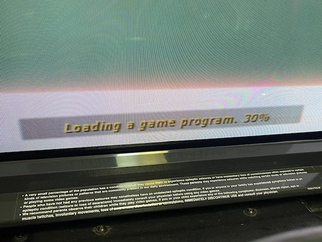

- ch-crazytaxihighroller_512_SBFY.bin (crc32 B0A9C447, would give me error 26 even though I've now confirmed the zero key is operational)
- ch-maximumtune2verbexp_512_SBKD.bin (crc32 303B09AF, starts to load and the at around 3% gives me an error 26)
- ch-maximumtuneverb_512_SBHQ.bin (crc32 D0F6243C, starts to load and the at around 3% gives me an error 26)
- ch-outrun2_512_SGBZ.bin (crc32 23FD2E4B, starts to load and the at around 3% gives me an error 26)
- ch-outrun2specialtours_512_SBJE.bin (crc32 961FBE5A, starts to load and the at around 3% gives me an error 26)
