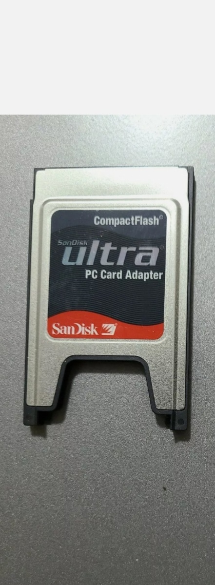

What kind of adapter are you using for the CF cards ?
I will also have a CF adapter.
