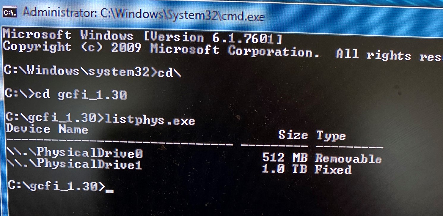

For some reason my Startech PCI-E to IDE card insists on making the CF card Disk 0.
gcfi -r -p -s 0x3232 -d f:\ -l ABC.BIN -g OR2SP.bin

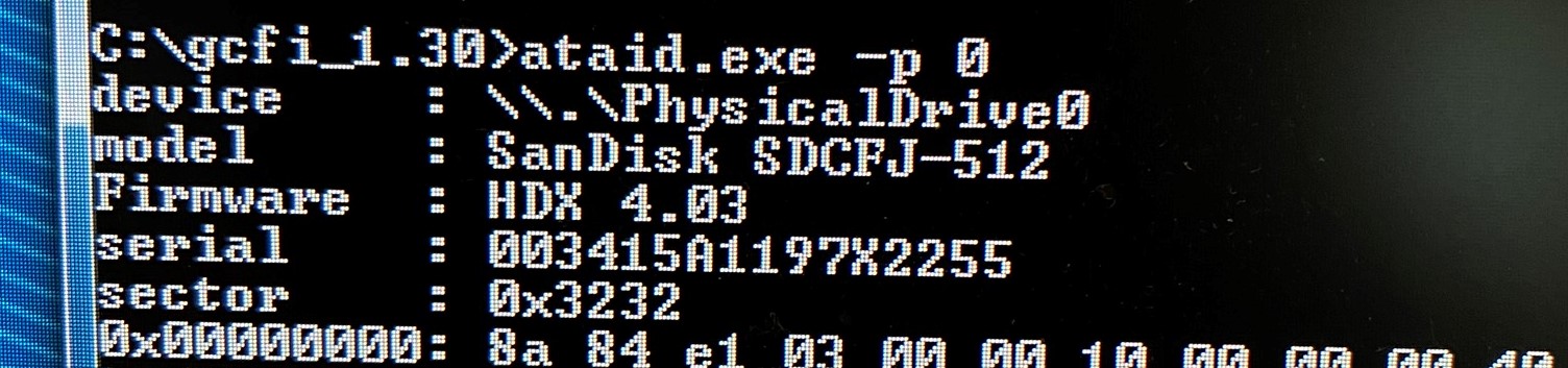

Interesting, can you run the command: listphys which is included in the gcfi archive ?
And then paste the results here ?
edit:
And please run ataid -p 0 as well :D
