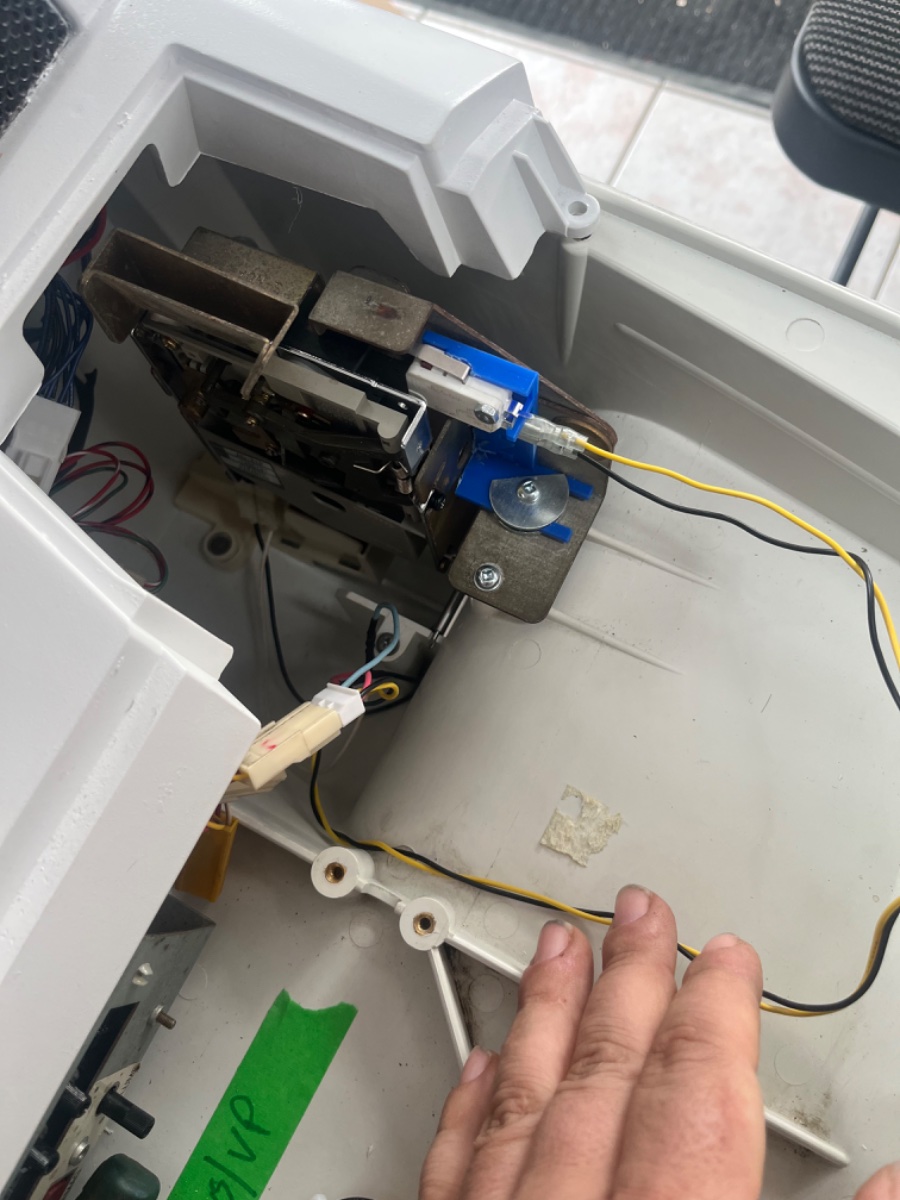

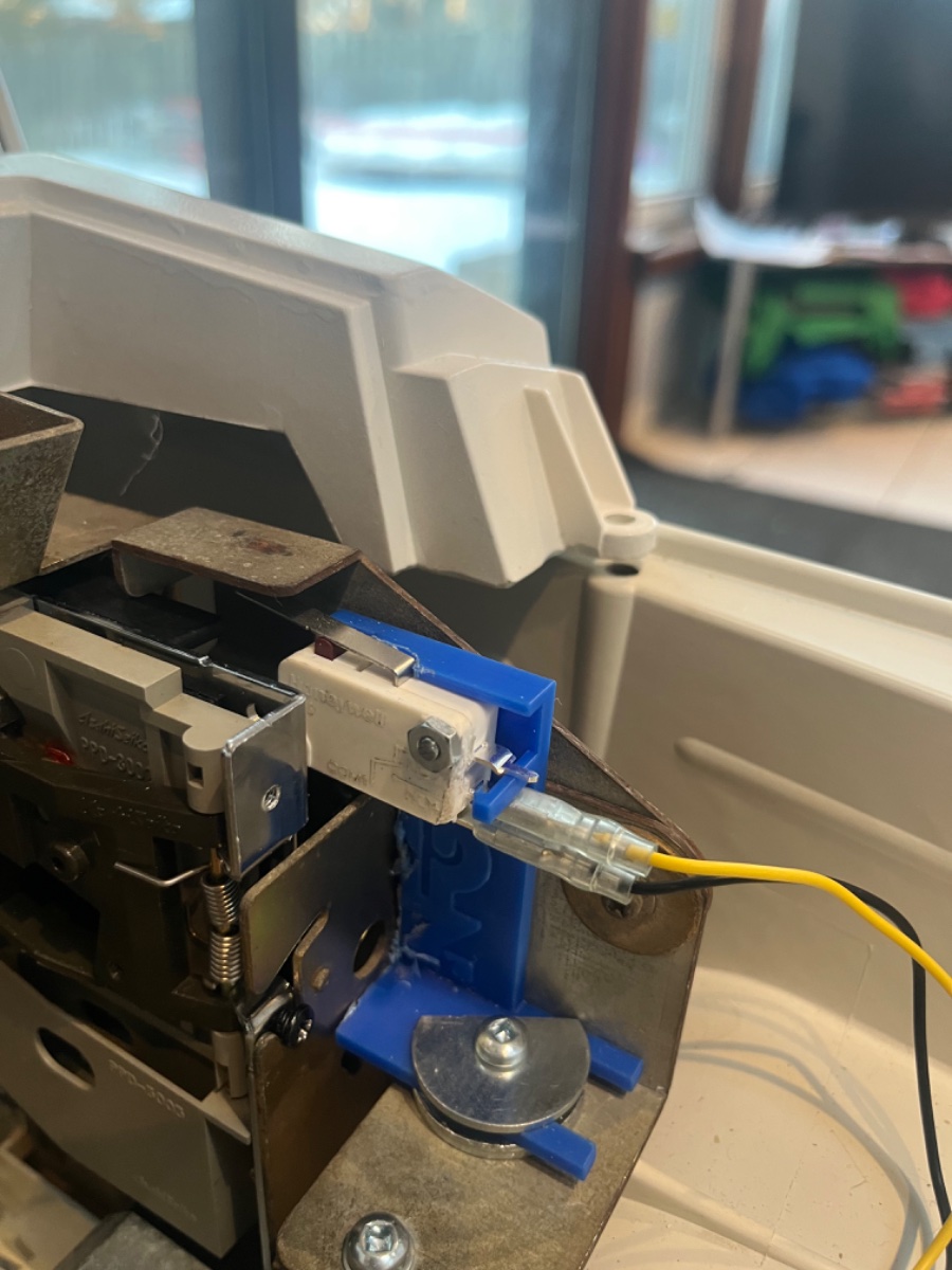

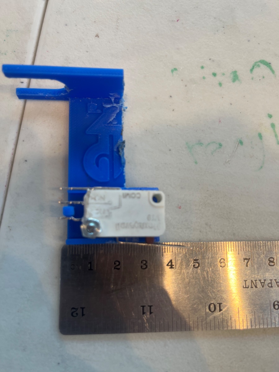

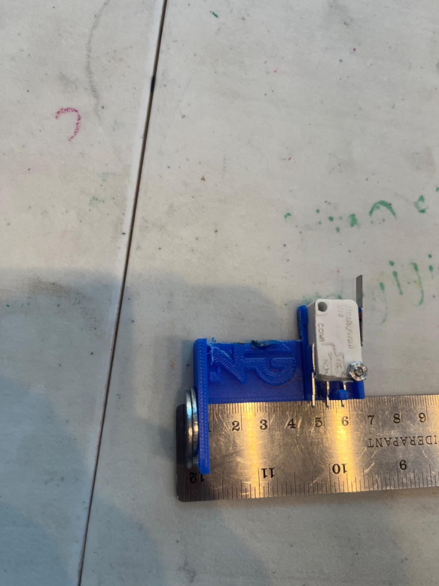

Macgyvered your version and made it usable keeping the coin mech in place and splicing the wires into a connector. Now you can credit up from the reject button or coin. Thanks @NFGx
For reference I used the other coin reject 3d prints you did for Sega and snk cabs, because they were taller and easier to fit.
Good work!

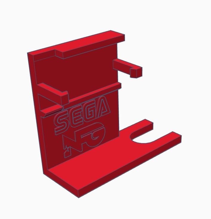

If you get a chance, can you show me a photo of the MacGyver'd monstrosity you've created? I might try and make up a proper design for it.
The horseshoe cut out at the bottom isn’t required just make it all square and put 1 hole in it for the screw. You can get rid of all the washers that way

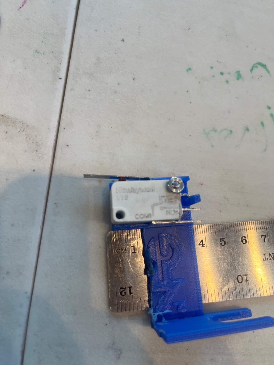

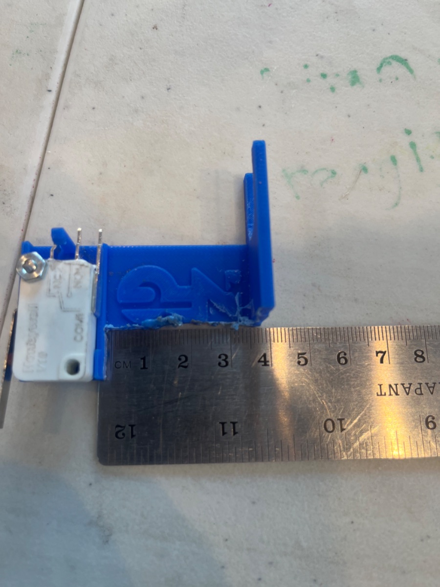

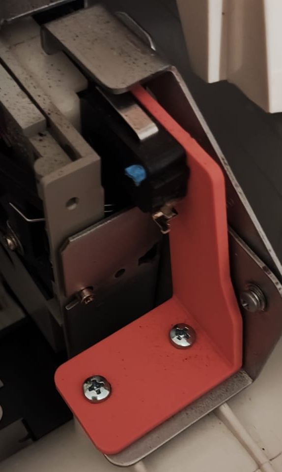

Made this one, I can share the STL if you want
