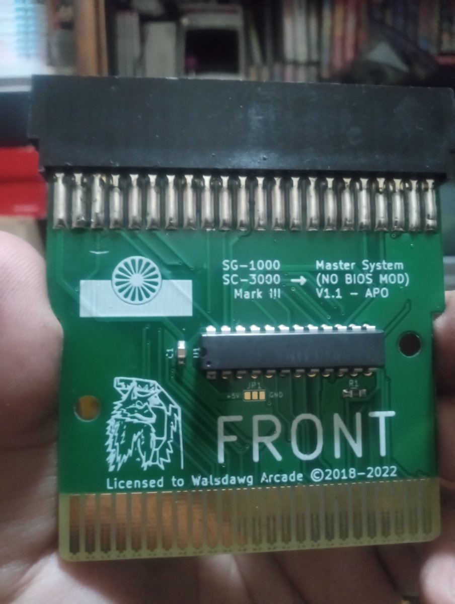

So I won't need to do anything? My adapter is #18. I opened it up and it looks like this. Also I can't get Hokuto no Ken, The Ninja, Ashura to work. I know my carts run fine on my Japanese MK-2000 Master System. For some reason they will not work on my Master System II with the adapter.

Yeah your cart was the first sold with the fix. Let me see what Apocalypse thinks about those games. Do you have other games that ARE working?

I have Rygar, Fantasy Zone, Fantasy Zone II, Space Harrier, Aleste, Shinobi. The all work. My SG-1000 carts Pacar, Safari Hunting, Pop Flamer, Sega Flipper, and Girl's Garden they all turn on just fine. What I would love to know is if a SG-1000 card catcher will work on a SMS II with that. I got a bunch of SG-1000 and Mark III cards. Still need to find a card catcher.

Yes. Card catcher will work.
One simple thing to try is to insert the adapter and cart then pull up on it a mm. We didn't have a ton of original carts to test on the adapter but it's possible to improve compatibility even further!
Does anyone know how to open these carts? Pcb pictures of your not-booting would help us improve the adapter!
