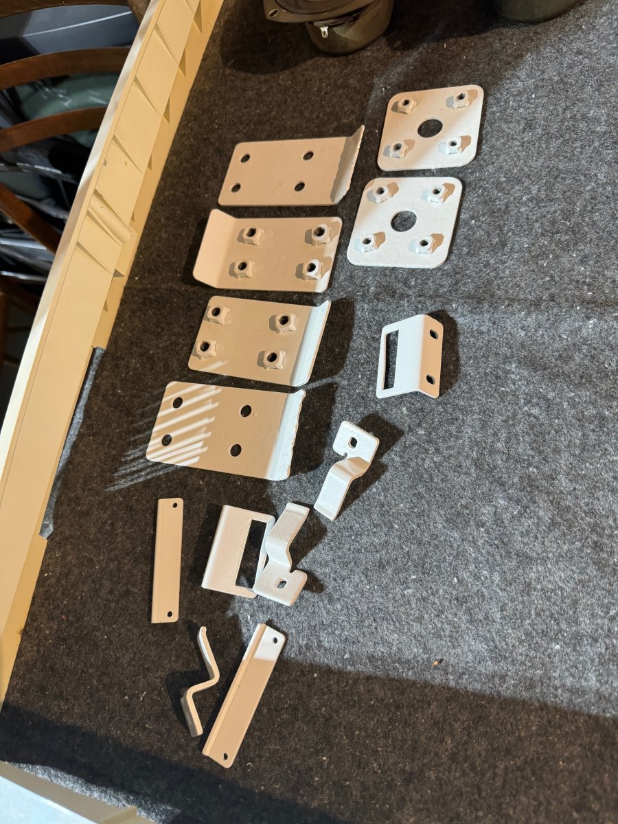

I did get the tube frame/handles rust free and polished :)

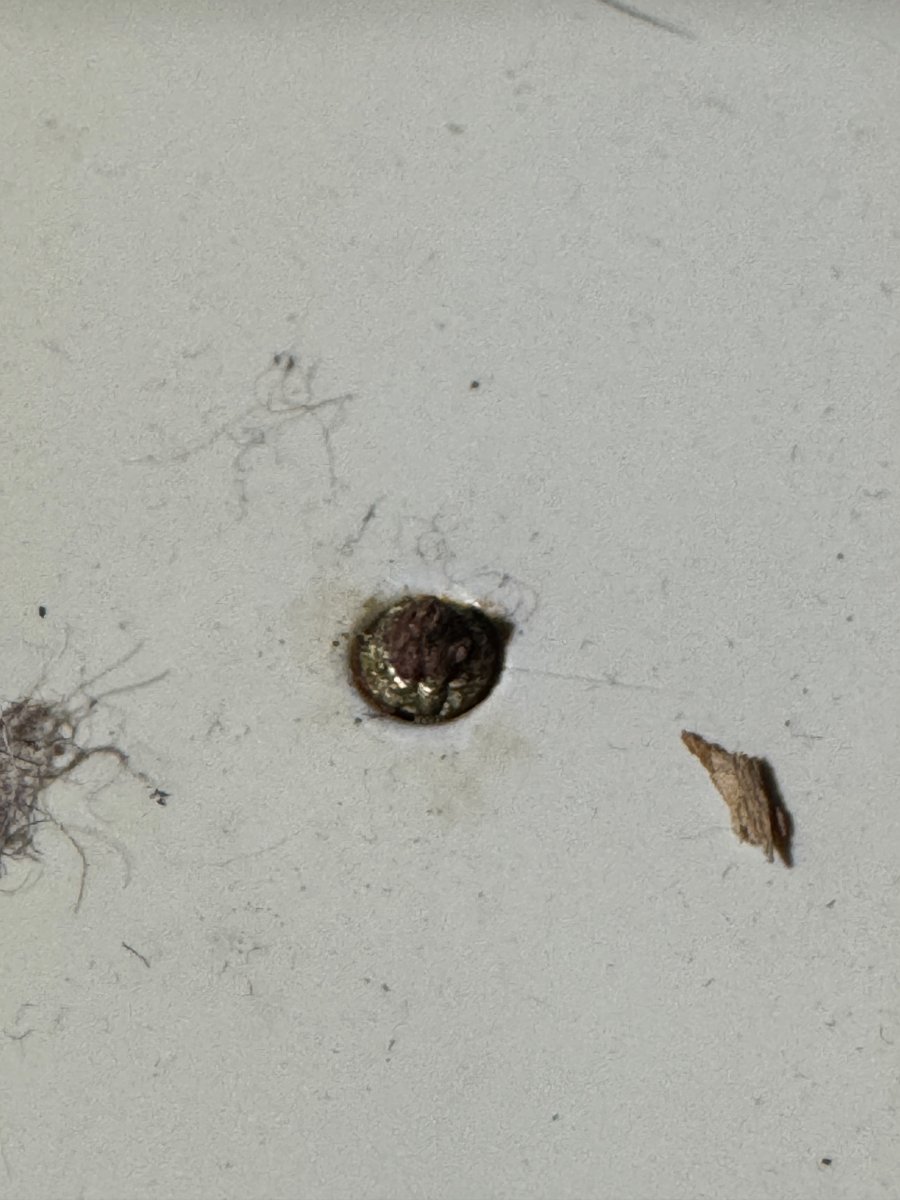

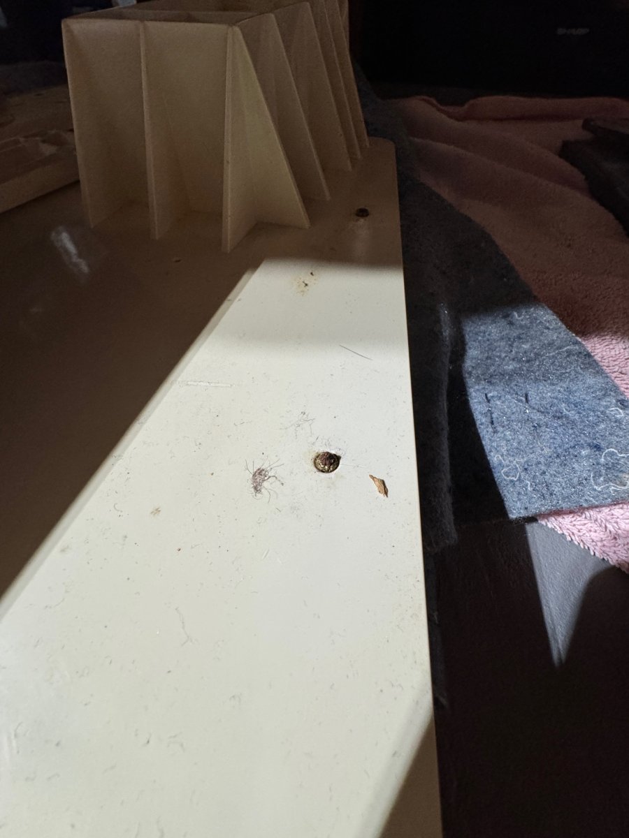

Got most of the rust removed then painted. My big pain point is similar to what you or others mentioned above. I had so much rust during disassembly I broke off quite a few screws, like totally the heads are gone and now just the heavy rusted shafts are stuck down in the brass inserts. I bought a screw removal tool, but they are so tiny, I dont want to crack the plastic and even after that i for sure am going to need to replace those brass inserts, no idea where to source them.

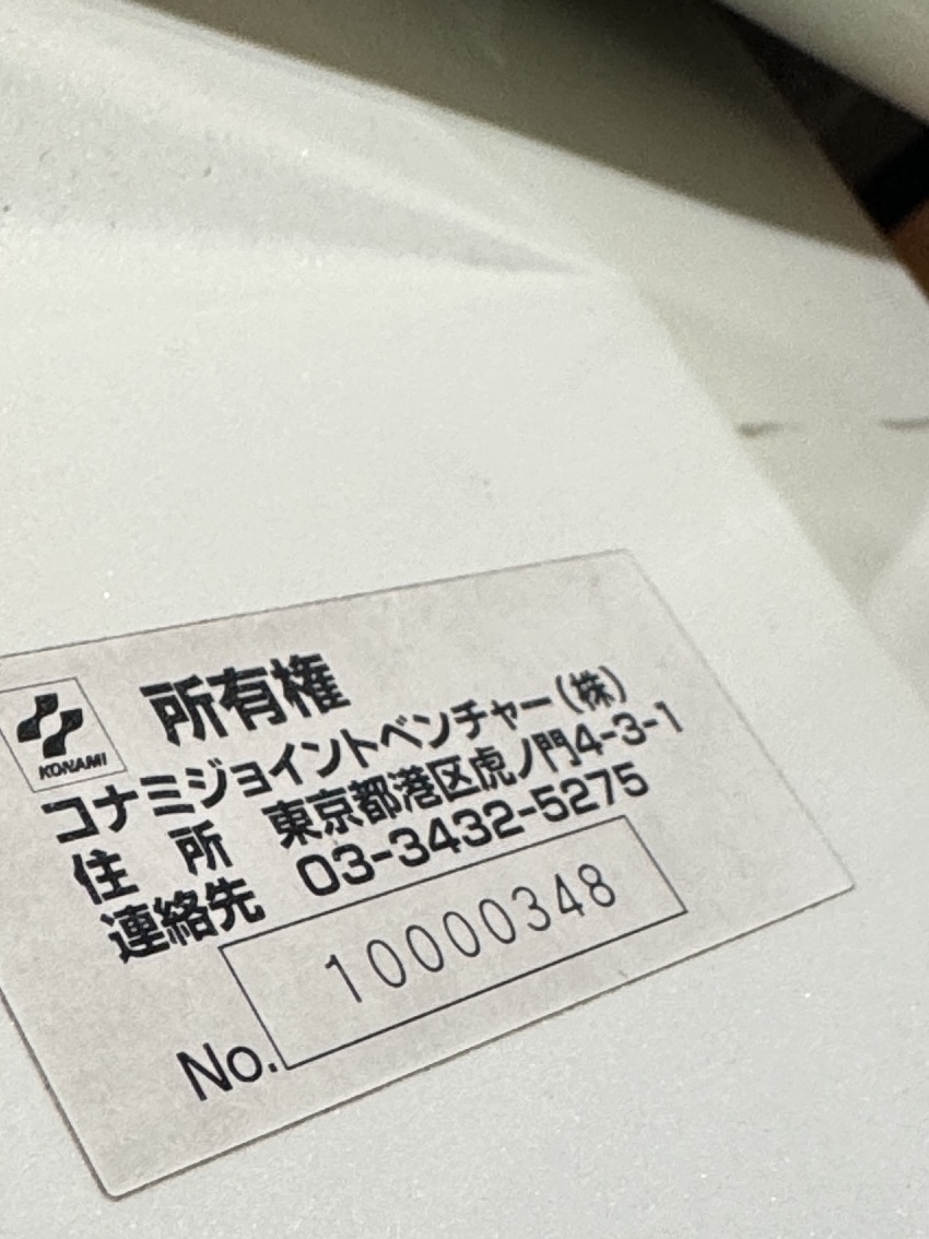

Whats your serial, just curious. My girl has been around!
The inserts can be easily found at somewhere that carries metric hardware. I’m not sure where you are, but we have Ace Hardware here in cali, and I’ve been able to find most of my missing screws and fasteners for arcade cabs.
Here’s my serial #

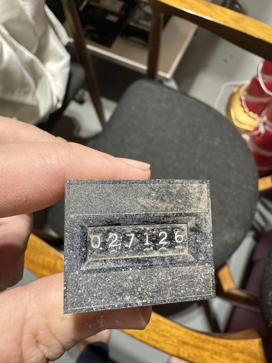

What’s your coin counter at?
Mine has seen some plays.
Here’s my serial #
