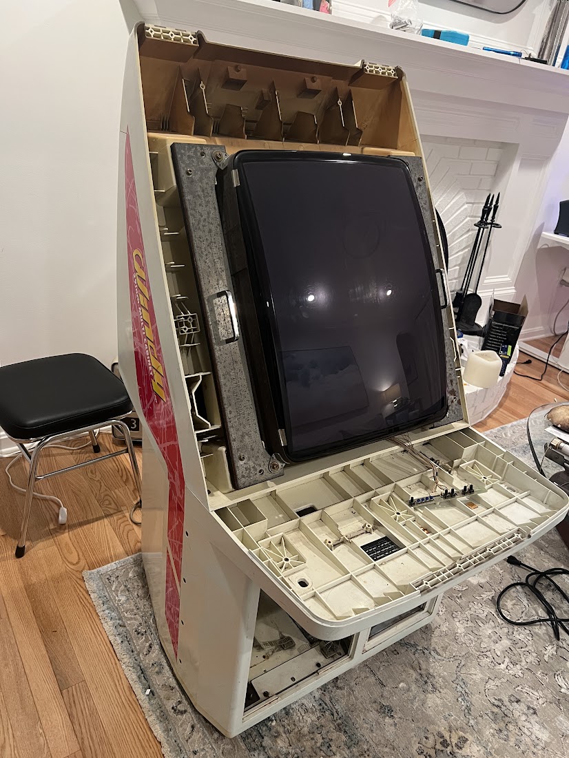

Picked up this beat-up Konami Windy locally for cheap. As you can see, she needs some work.
I love these cabs, been wanting one for a while, but they rarely pop-up. They're made of all thick ABS Plastic, barely any metal, has an awesome shape that's close to the dimensions of an Astro City, but thinner in the profile dimensions. Time to give it a new lease on life! Shhhh, it's ok, Windy. You're in a safe place now. The bad men can't hurt you anymore.
She's been used and abused. Scratches from vandals tagging her up. Scuffs, crust, gooey and rusty, security bars. Let's assess the damage and figure out a plan of action.
First, here is the more egregious damage to the plastic shell, the rest are minor scuffs or leftover adhesives but these are the deeper scratch issues:
Lots of tagging, and I removed one side of the security bars so there are holes to fill. All this damage is fixable with a little JB Weld products and a repainting.

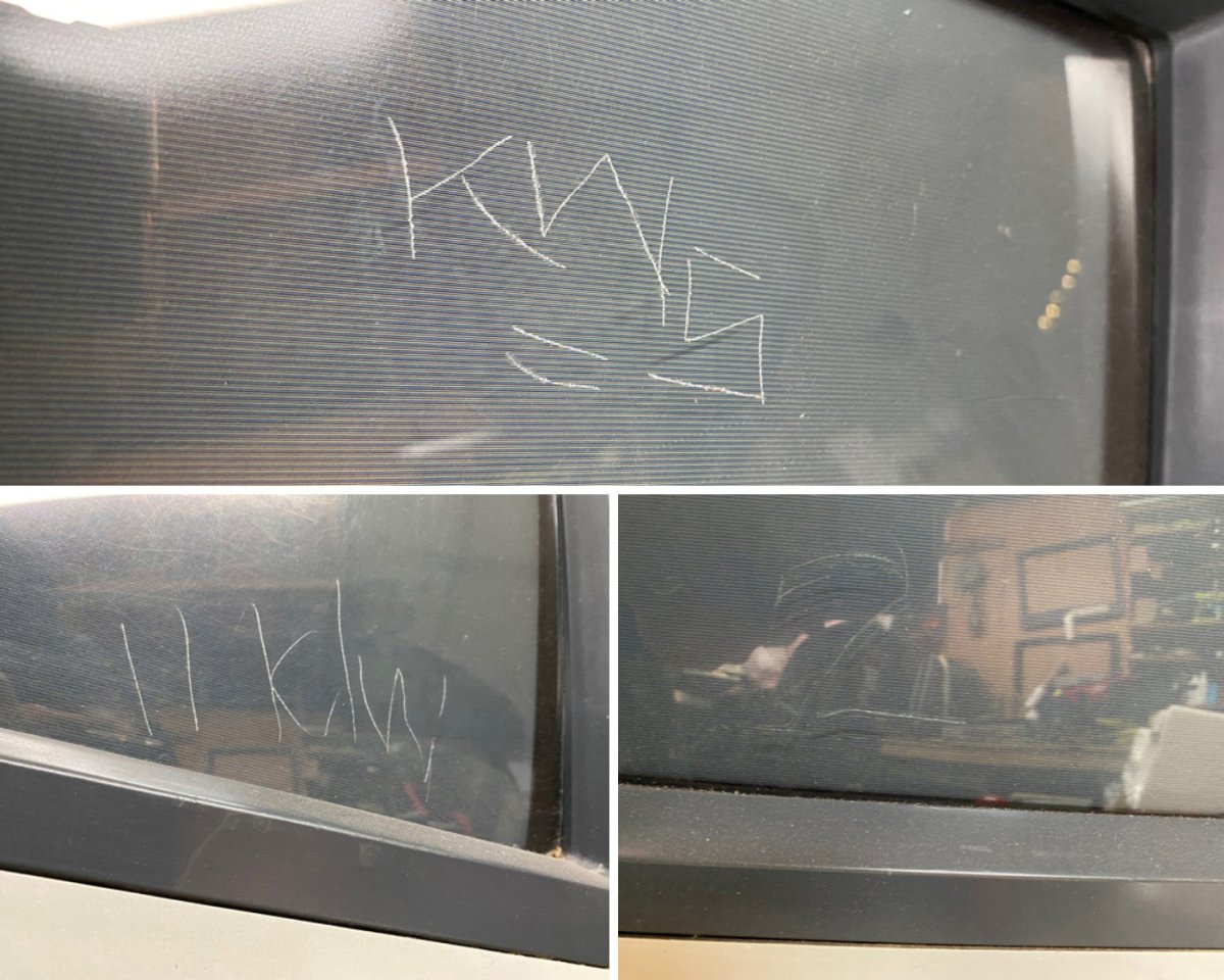

Speaking of tagging, there's more on the monitor glass. Now this will be harder to fix. Assholes. I'm going to see if I can buff them out. They don't seem too deep, but I might not be able to remove them completely. Maybe lessen their depth:
The monitor is the original Toshiba tube, PB6640 chassis. Great scanlines and brightness when this monitor is working. This one unfortunately doesn't power up. I'll dig into this and see if I can get it working again. If not, I could always put my spare Nanao-MS9 into it. But I'd prefer the original monitor setup.

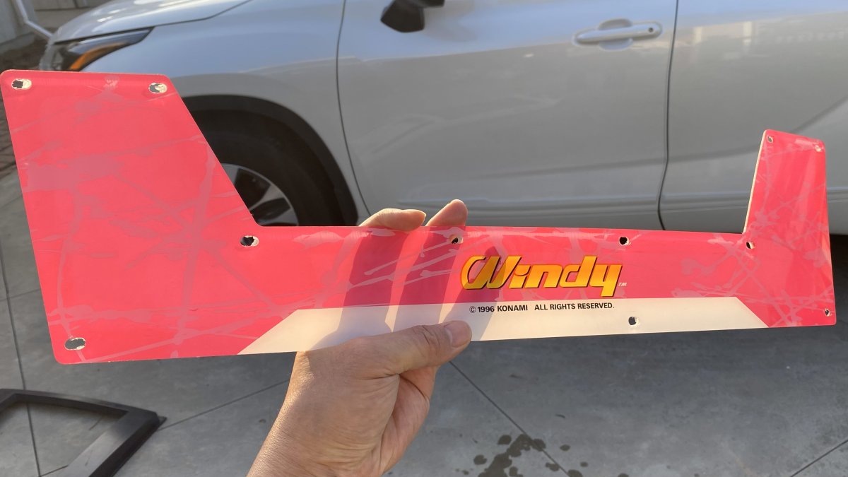

The marquee area is probably the best part of this cab right now, the acrylics look good:
Of course the cab is missing the plexi marquee art holder, those things are pretty hard to come by for a good price. But it's also missing the 2 legs in the front, and both back wheels. Luckily it has the mounting plates for the back wheels, and I've already ordered replacements based on @Asobu 's great write-up on his restoration.

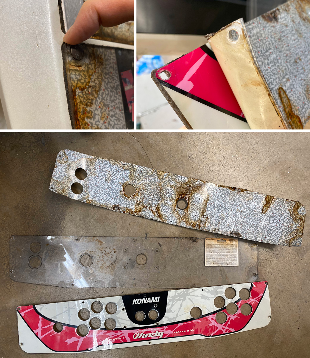

I took apart the control panel. I had to drill out the standard cam-locks that were on there, which wasn't a big deal with my carbide metal bits. You can see from the top, some dingus spilled soda or something all over the CP. It's all gooey and sticky under there. The panel itself looks to be a 2L12B that has been bastardized with a Happs IL 4-way joystick and buttons, probably to run a cheap x-in-1 multi board.
Also another security prevention feature, no plastic coin entry, just this metal plate with a slot. Well at least they didn't mangle the slot, just gotta fix those new screw holes.
Aside from the awful kitchen counter vinyl overlay someone put on this, it also has plexi over the CPO which isn't flush and extrudes out. After removing it and peeling back the gross sticky patterned vinyl, the original panel's CPO is revealed! It's too bad whoever converted this removed the second player's joystick mount. I might see if a metal worker friend can help me weld a mount back on it, because the metal of the panel itself is in pretty good shape. Just gotta fix the new holes, and get an overlay. Though, it might just be better to get an Alberto repro and save the hassle.
She's already looking like a Windy again!

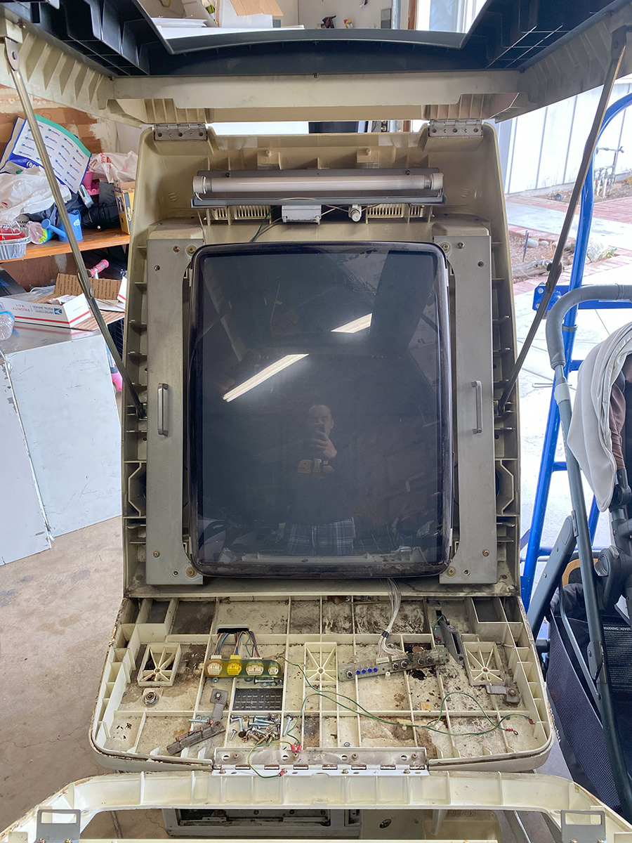

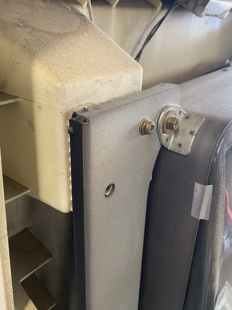

Opening the monitor shroud/bezel shows off how the monitor is mounted.
I can see what people were talking about with this monitor being easy to neck, the monitor is mounted directly to the cab! And there’s no frame for the tube, it’s just a couple metal plates with handles that are bolted to thick plastic mounts of the cab itself. I'm going to have to take it really easy when I remove the monitor to work on it.

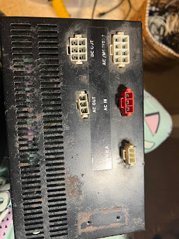

This Remote board has seen better days. looks like a coupe of resistors fried from soda or whatever was spilled over the CP. Corossion everywhere. I'll try to clean it up and fix it, but might have to find a replacement instead.

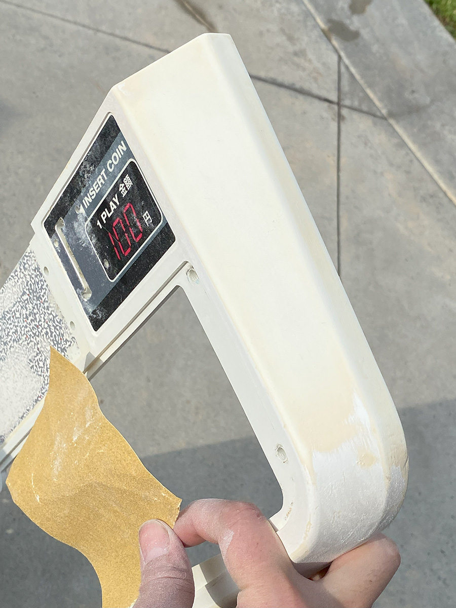

I also took apart the CP top and cleaned it as well as repaired the scratches.

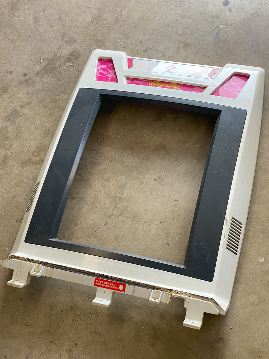

Luckily these scratches were shallow, so I decided to just sand them down starting with 120 grit sandpaper, then going up to 800 to get it smooth. The Windy is all about thicc ABS, so I’m not worried about thinning it too much.

When I pulled the coin cover off, I needed to remove the coin decal since it's trashed and has additional holes. these additional holes will be filled, and I'll get a new repro label for the coin decal.
You can also see the original paint under the coin decal. This is a White pearlescent paint, which has a slight sparkle to it. I'll have to look into reproducing this.

Toshiba tube is manufactured in March 1997 witch is great . Anyway , beside that scratch marks , the screen looking great imo :happy: Its great cabinet for your collection !
Thanks guys.

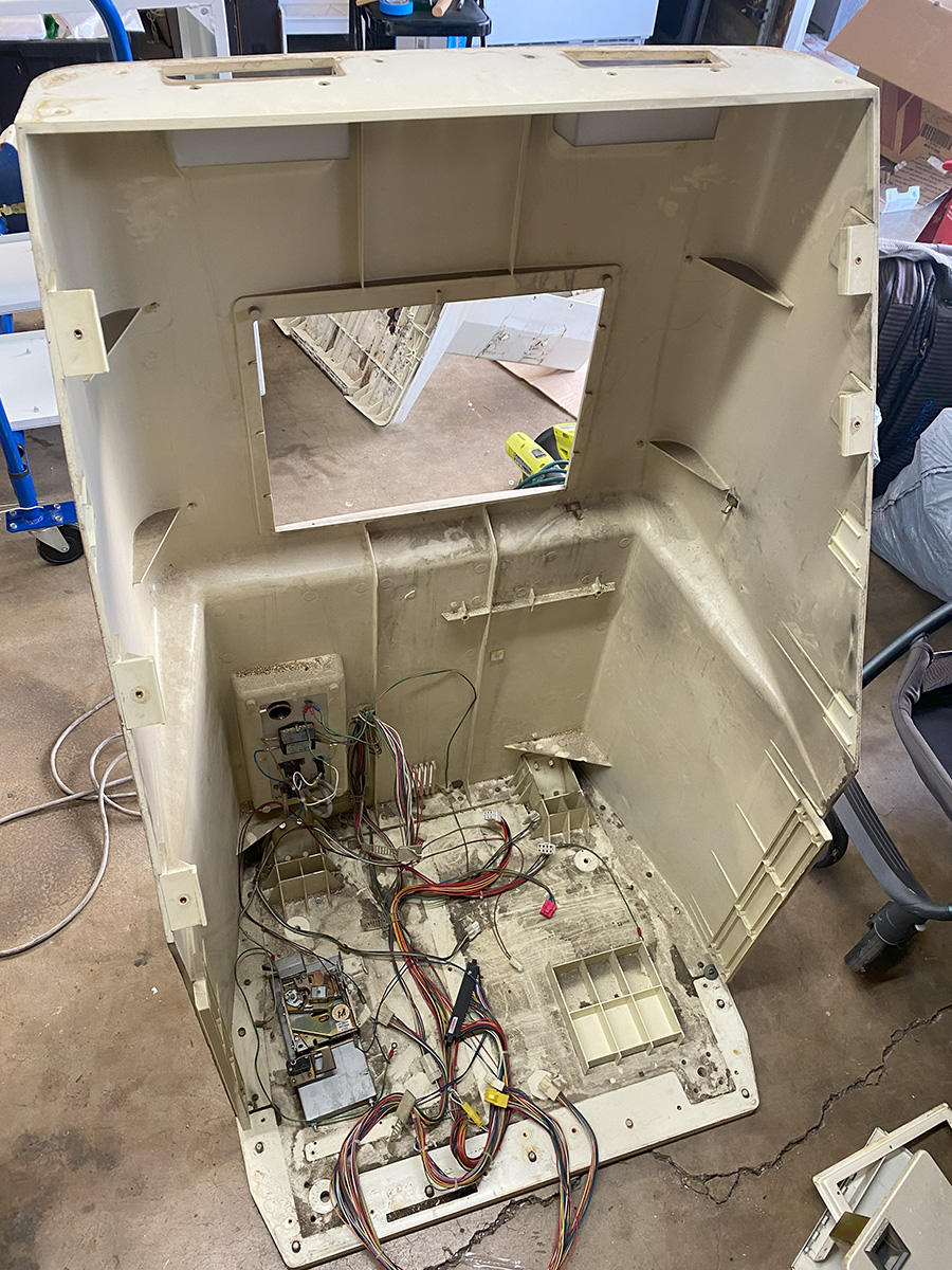

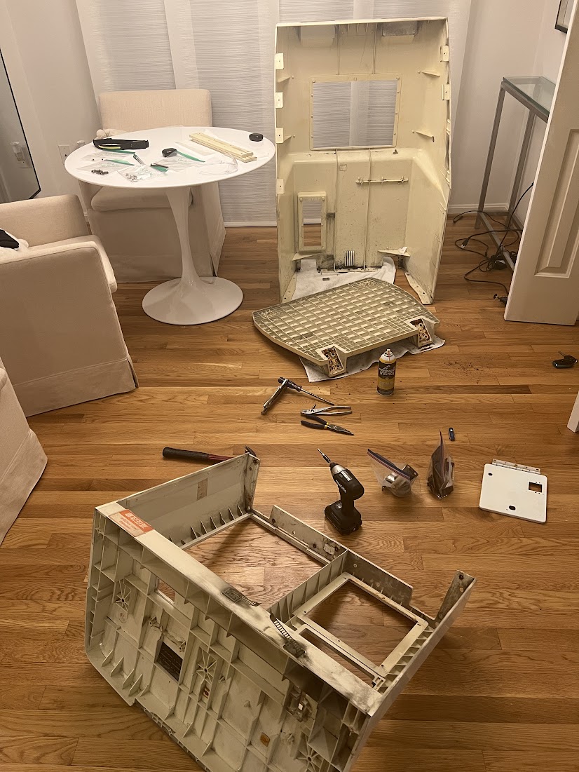

More progress on disassembly and cleaning today. I carefully pulled the monitor, as I mentioned above there is no frame on this tube, which is probably why people warn about damaging the neck. I decided to put the tube down on it's face for now, while I figure out a safer way to have this sitting on my workbench for servicing.

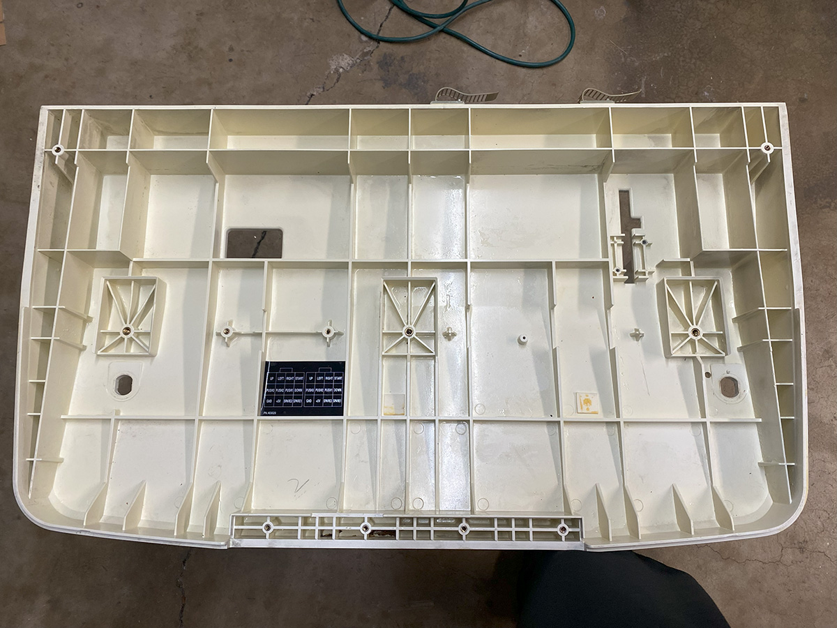

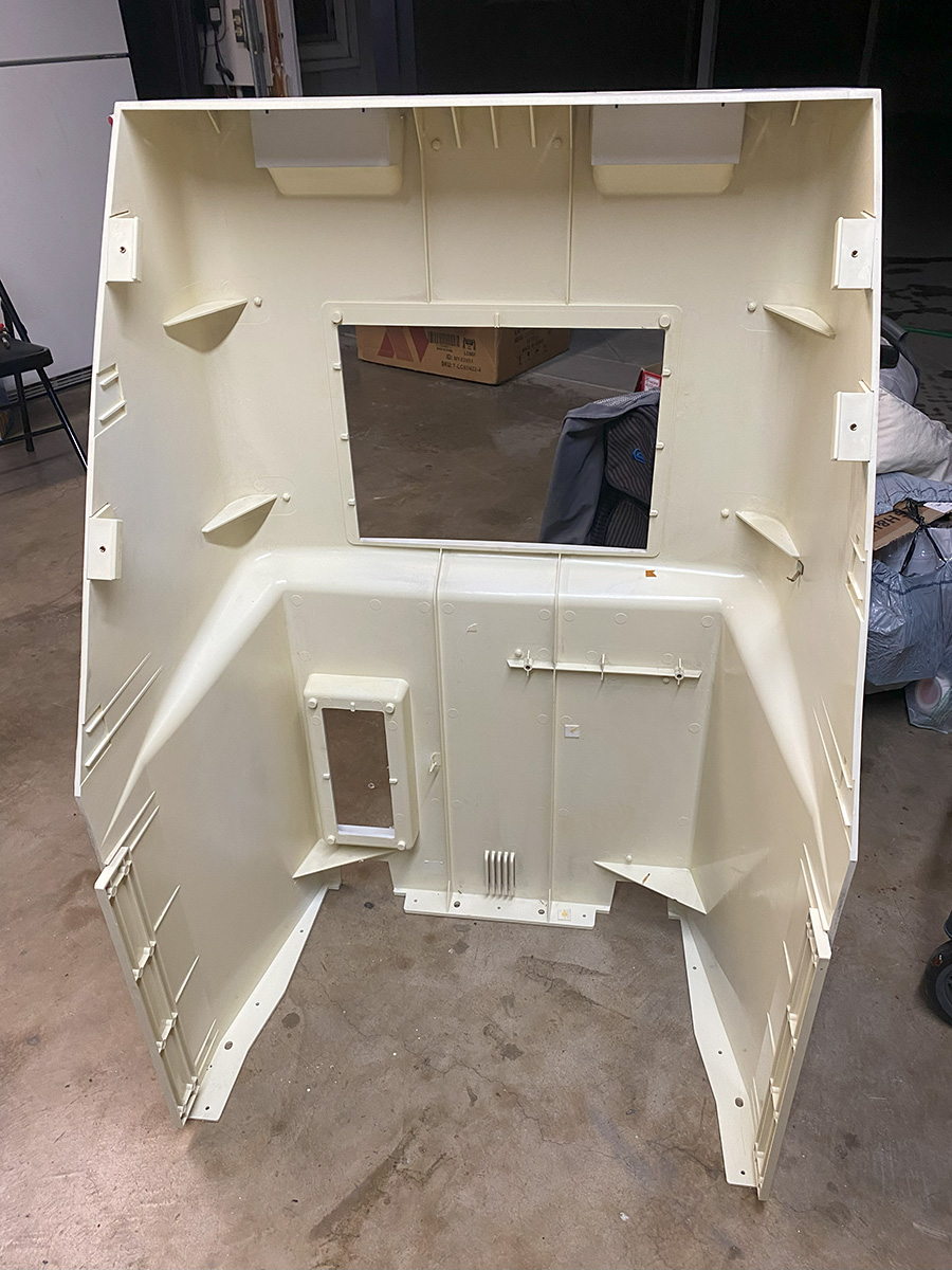

I really like how easy it is to take this cabinet apart. There is not much to it. it comes apart in 5 sections: the CP top and bottom, the monitor shroud/bezel, the front and back shell, and the base.
Pulled the front shell off, which gives me easier access to the wiring, which is very simply laid out.

Ready for more cleaning.

Hosed it down, sprayed with Simple Green, then got to scrubbing.
So fresh and so clean clean.
For the CP bottom section I still need to get into some of tight spots with a toothbrush to get out some of the residual dirt and dried soda sludge. But overall it's a huge improvement from the nastiness that it was.
Gonna let it sit and dry overnight.

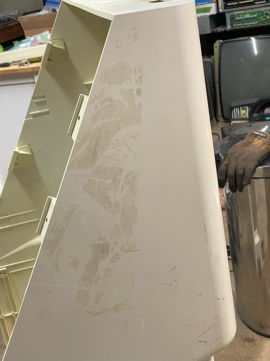

Next I removed the remaining artwork and leftover adhesive residue. This took a bit of patience and a hot air gun to help get the old artwork off. For the adhesive residue I used Goo Gone, let it sit for 20 mins soaked in that stuff, then used a plastic scraper to get it off.
After another round of cleaning, I started fixing the scratches and sanding down the rest of the shell parts. Smooth as silk. This part is ready for new paint.
Most of these scratches were shallow, so I just needed to sand them down with 120 grit , then smooth it over with 800 grit
This part is also ready for new paint.

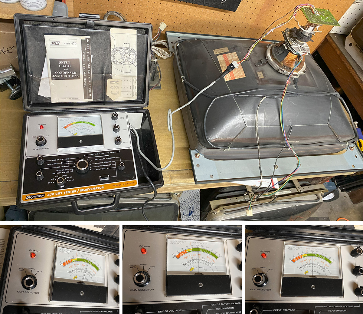

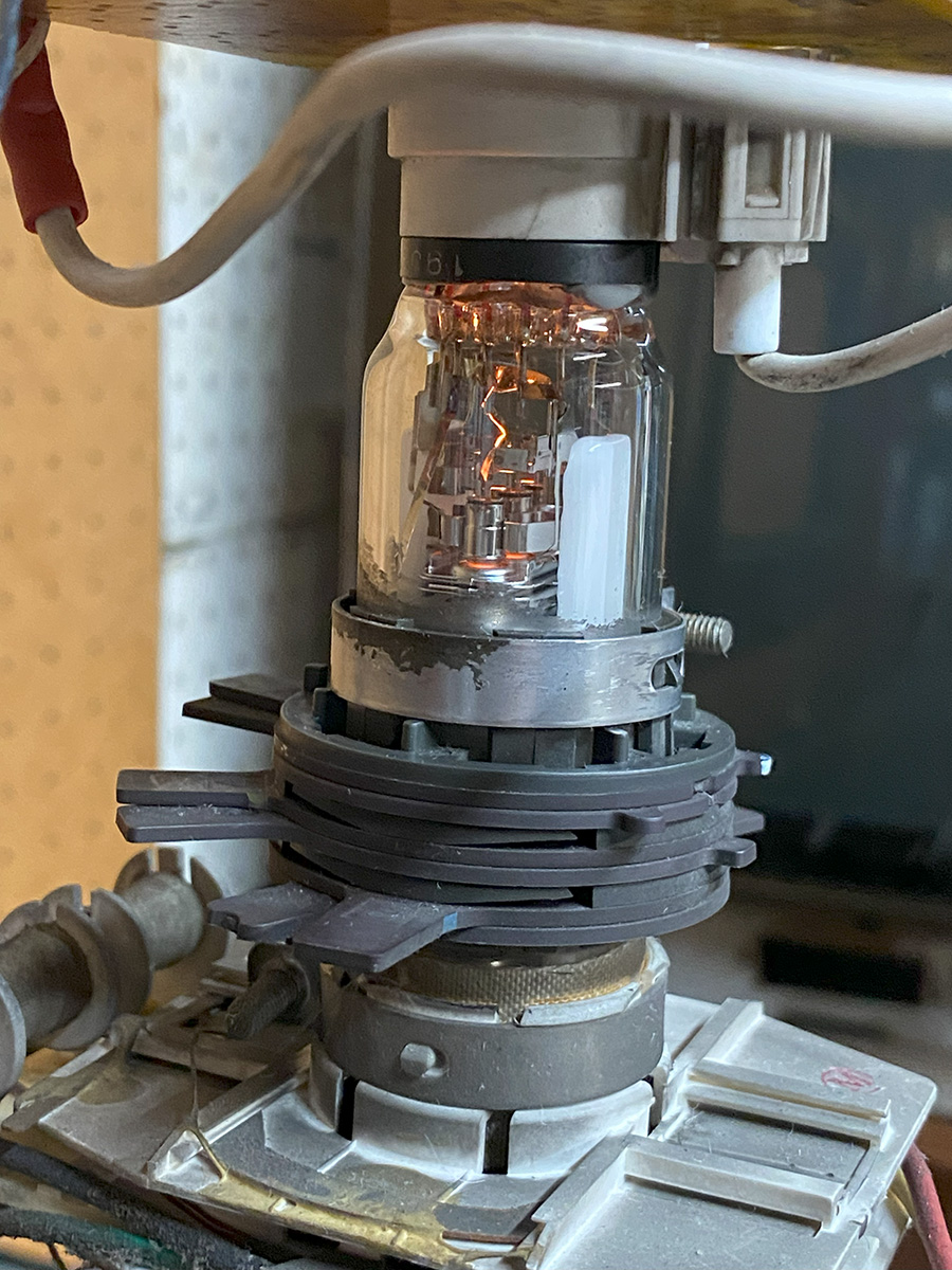

Moving onto the monitor momentarily, I decided to at least test, clean and if necessary rejuv the tube. After a few cleaning passes and removing shorts, I'm happy to report that the monitor is in healthy shape! All guns are in the green!
Good neck glow:

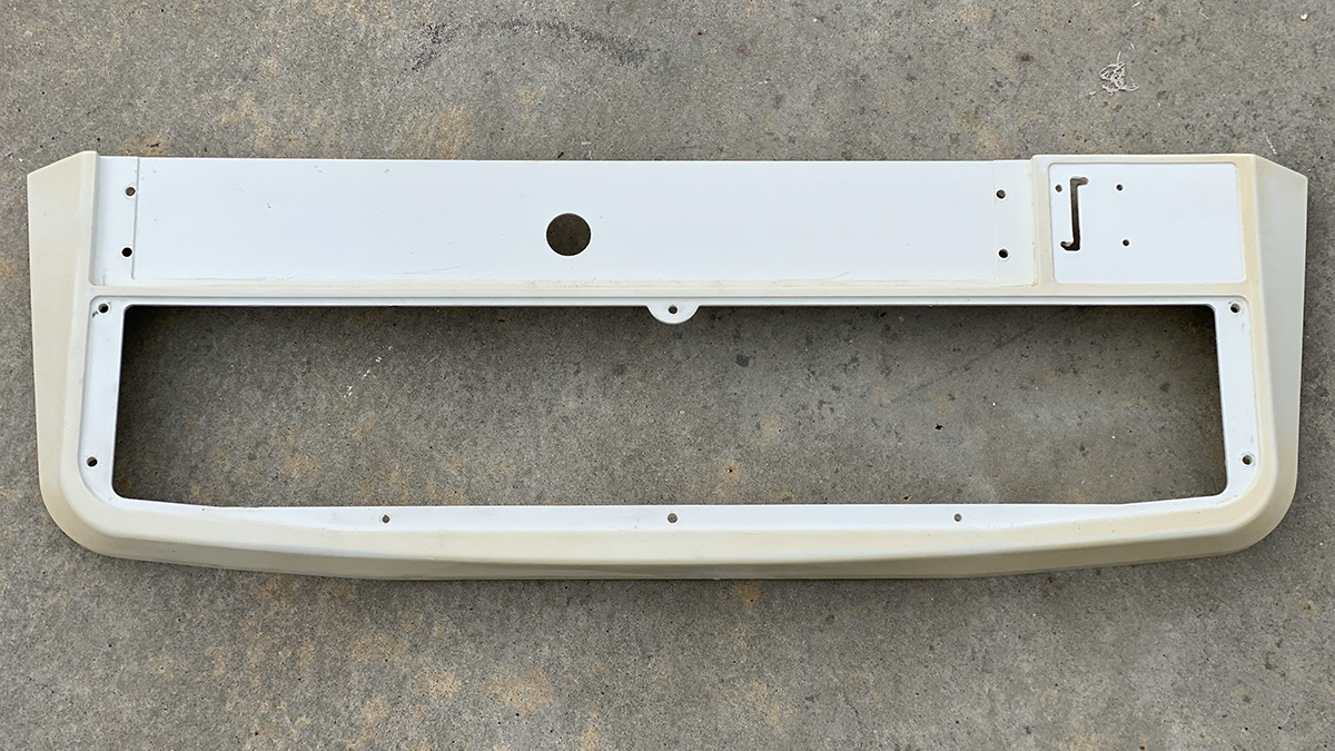

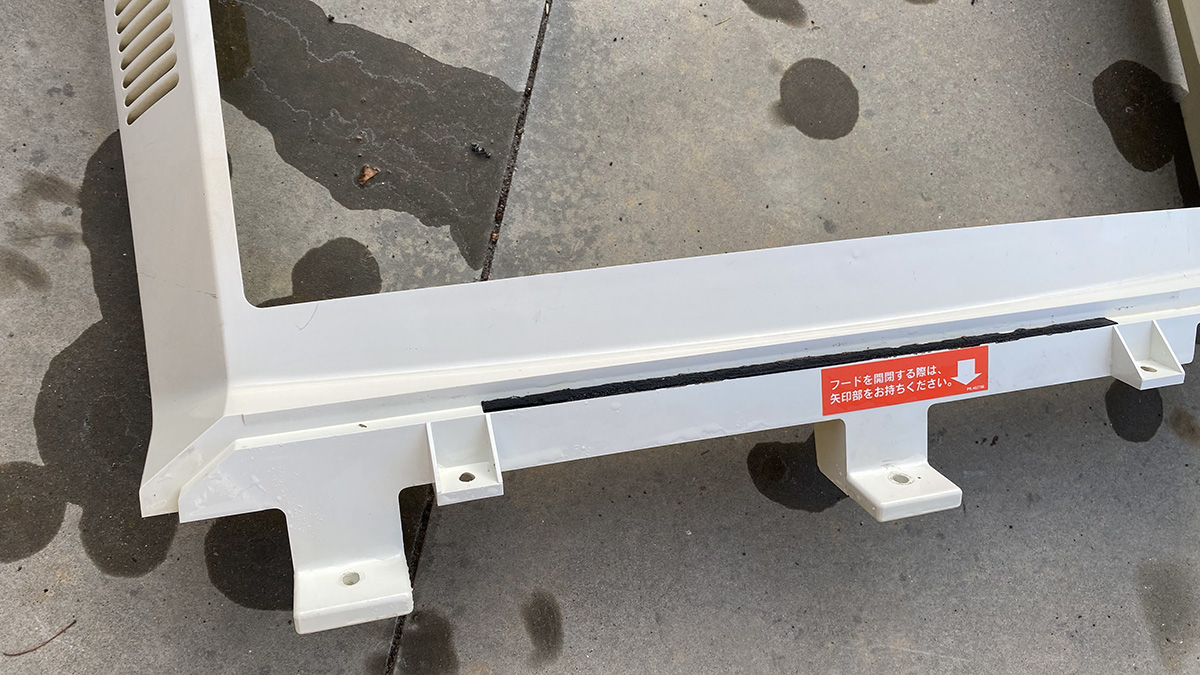

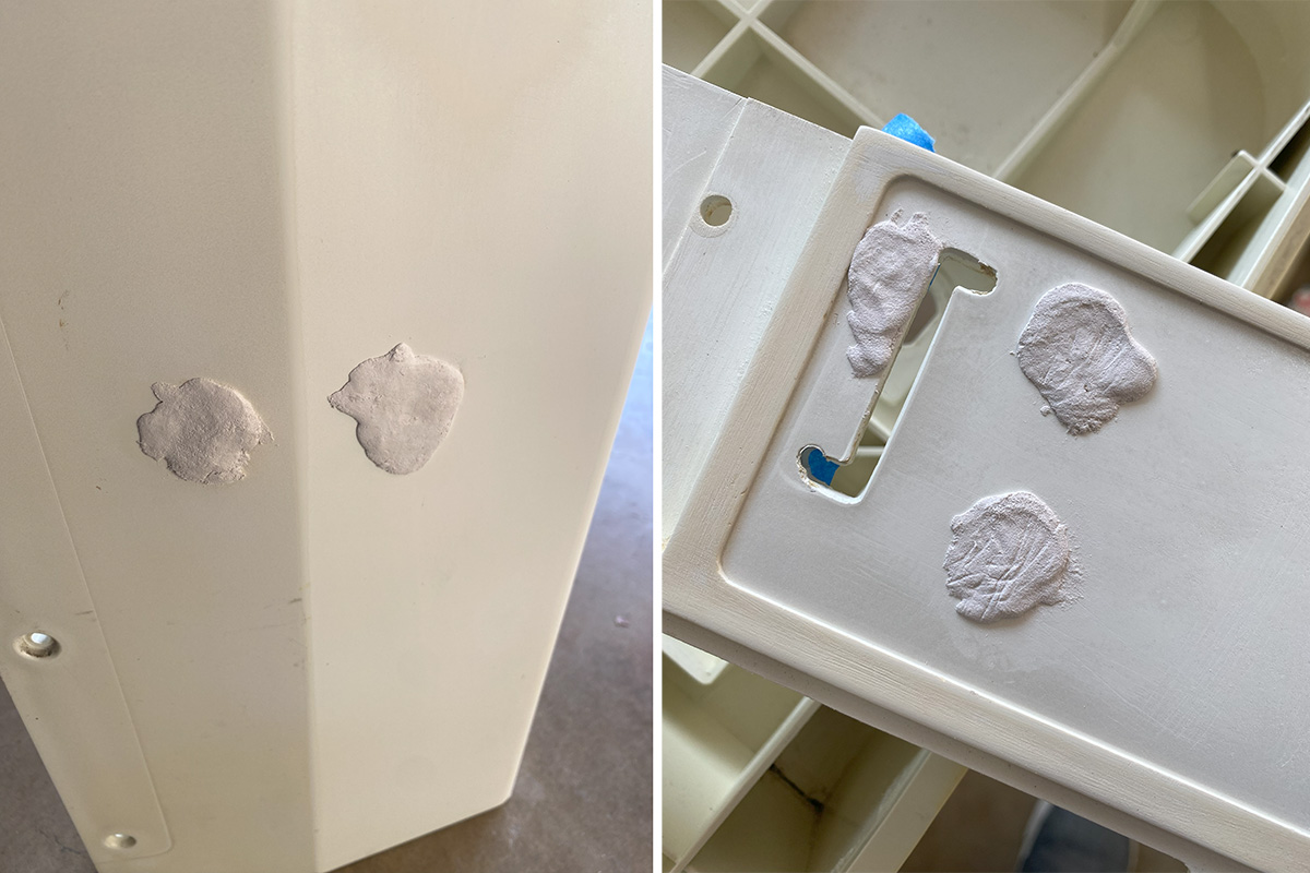

Today's task was to fix holes.
I usually go with bondo, but this time around I wanted to try something a bit different.
For filling I'm using plastic weld putty, then reinforcing it with epoxy.
Just fill it up, and overflow it onto the sides so it has the full coverage and sealing. This may have been a bit more than I needed since you got to sand it away after.
Behind the holes I put temporary tape to stop the putty from passing through the hole when applying it.
After sanding it smooth, no more holes! This putty kinda feels like bondo when I sanded it. Easy to shape or smooth down.
removing the tape on the back shows this:
But as I mentioned, a bit of epoxy to seal the back and reinforce it so it doesn't get punched through or slip out. these holes are small enough that i don't need to use any kind of mesh or wire to back it. putty and epoxy seem to be good enough.

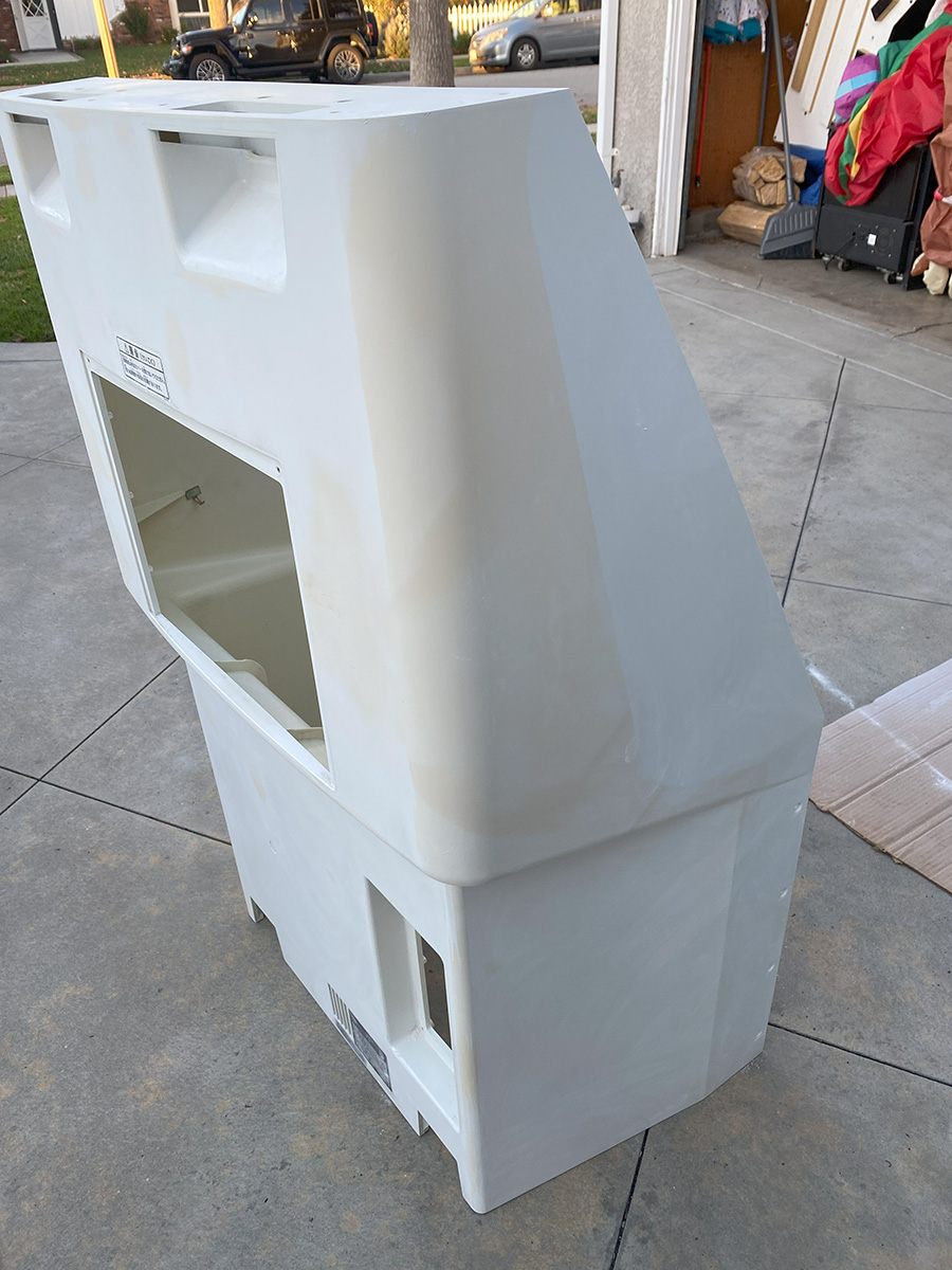

Now that the this is done, the cabinet is ready for paint! Windy's had a pearlescent white paint job, similar to a lot of white cars you see on the road these days. they have that sparkle to it. I have to decide on a course of action, either I do it myself, which will require I pick up a new skill of using a paint gun and compressor (also gotta buy those things), rather than my comfort zone of rattle cans and wet sanding. Or get a body shop to do it.
I'm leaning toward the latter.
