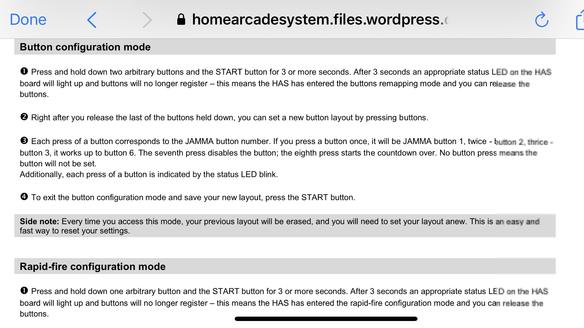

Just had a chance to test out the ez boards with Mc Cthulhu on NES. I purchased some rj45 to NES cables from jasens customs. The A & B buttons are mapped to jamma buttons 5 & 6 which is fine for a usb fight stick but not fine for a jamma cab with no kick harness. It looks like MC Cthulhu is not programmable so assuming I would need to recrimp the rj45 connectors so A & B are mapped to 1 & 2? I realize I should have listened and made the cable myself from the beginning... :)
Did you buy the button remapping add-on when you purchased your Jammaizer?
Upgrade Options:
Button Remapping and Rapid Fire IC: Designed by "RGB" creator of the HAS supergun and RECO PCB. Allows full remapping and rapid fire programming of buttons 1-6 for player 1 and 2. Rapid fire modes can be toggled between different speeds and can be toggled between V-Sync locked timing and asynchronous timing depending on your needs. Frankly this upgrade is a must. Upgrade priced at $25
It looks like I did but I didn’t realize it! Thanks. The button config the same as the HAS?
