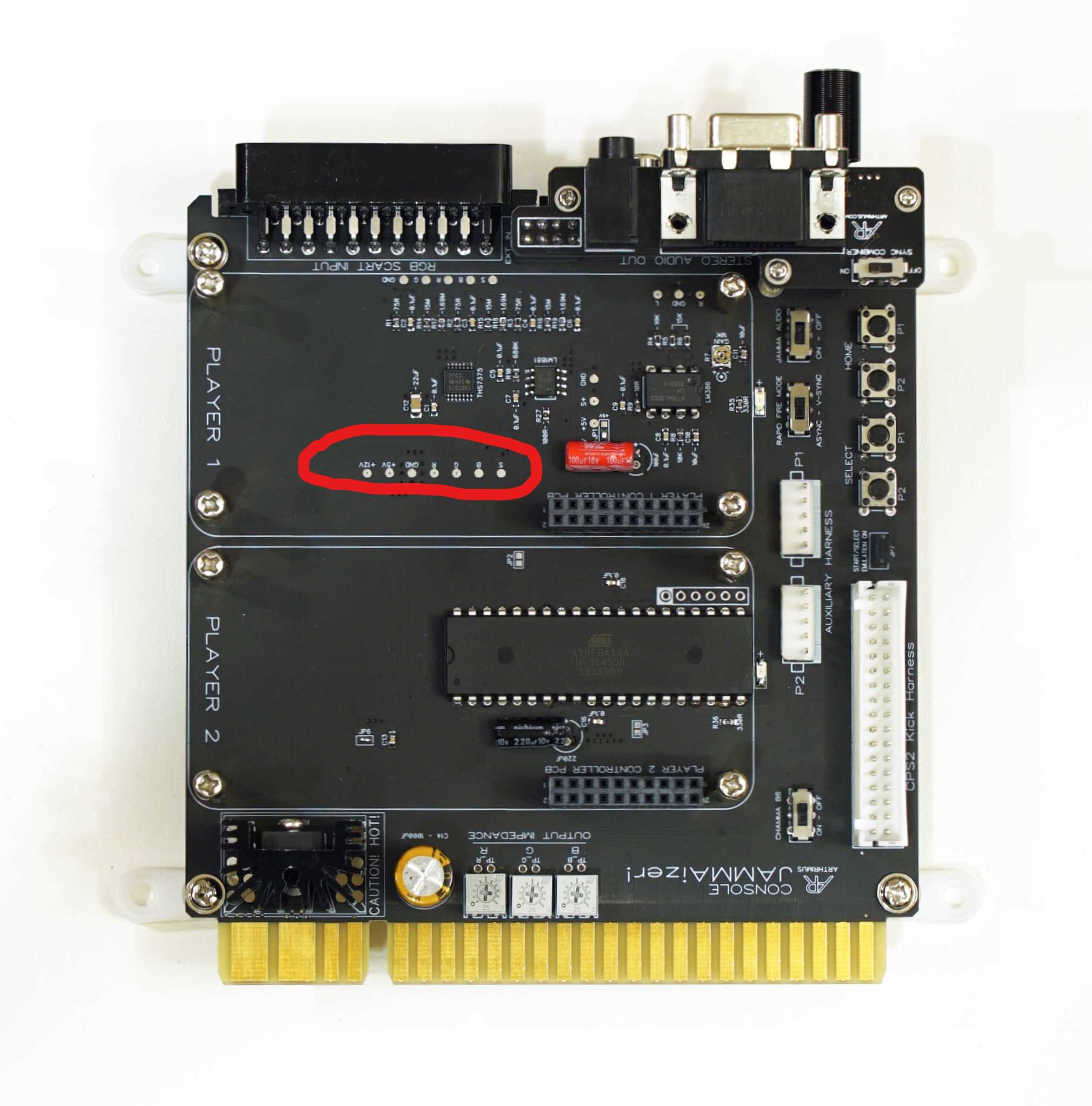

I lucked out and found an ultracade uvc and I want to pair it with my jammaizer to convert my 480 to 240. Can I connect it to the circled portion in the pic
Video off the UVC is already amped/clamped/DC restored down to 240p, right? If so, I wouldn't pipe the video off UVC through JAMMAizer's video circuitry. Pipe the video direct through to the JAMMA harness.
Build one of @Frank_fjs JAMMA Adapters. Don't solder in the jumper bridges for R/G/B/Sync/VGnd (red box). Then bypass the jumpers and pipe UVC video directly onto the tap points for R/G/B/Sync/VGnd on the JAMMA Adapter (green box). Solder the jumper bridges for all the other inputs. You can even tap 5vdc and 12vdc for the UVC off the JAMMA adapter. Best of all, it is reversible and you can still use JAMMAizer for the audio and controls.

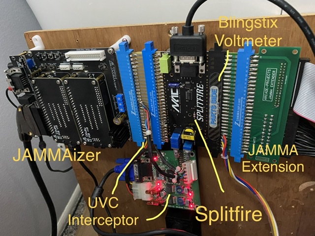

I ended up building a “UVC Interceptor” JAMMA Adapter. It only passes the inputs and sound across and cuts the video feed and replaces it with the UVC’s.
Don’t mind the crazy JAMMA chain here, it’s not that crazy

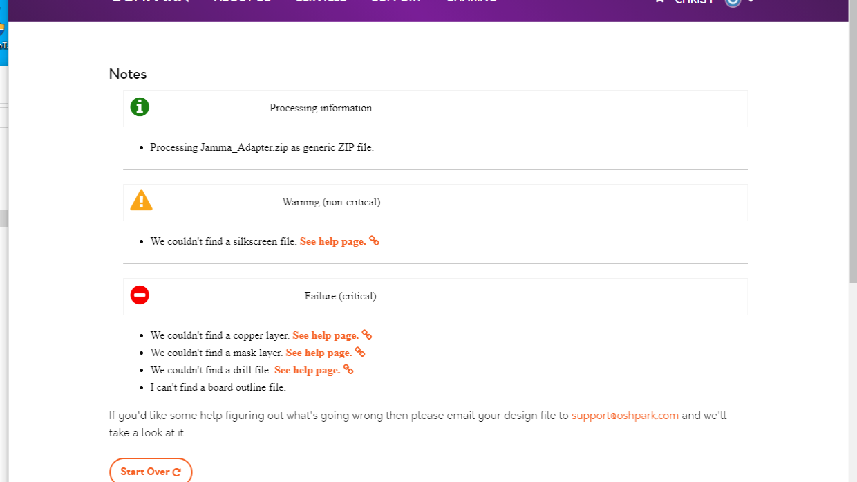

I tried to upload the jamma finger to oshpark and I get this error does anyone have a spare one of these lying around
