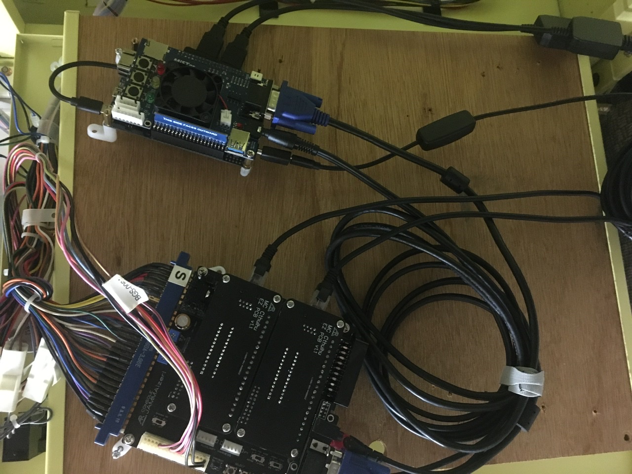

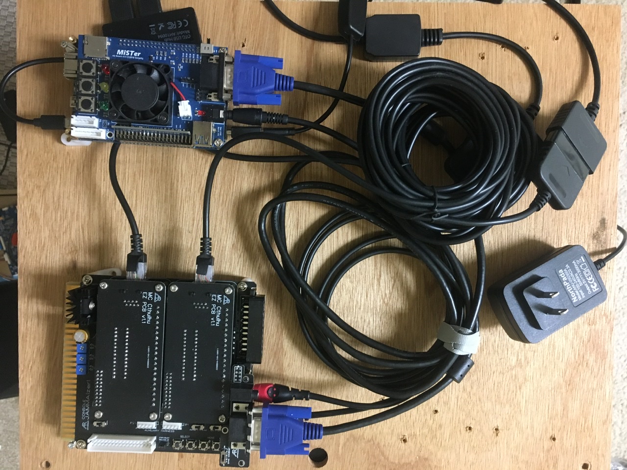

I’m happy to report the Jammaizer paired very well with my Mister FPGA and 2-player Blast City cab. I currently use the McCthulu EZ-PCB for controls. Specifically, I have some Playstation cables going to USB converters to connect to the Mister. I might experiment with the Brook boards in the future.
I forgot to ask, but pics of your physical coupling of JAMMAizer + MiSTer and screengrabs of it in action please. Maybe a video if it is not too much to ask?
I take it you’re not having to worry about the video frequency since the Blast has a Tri-sync monitor?

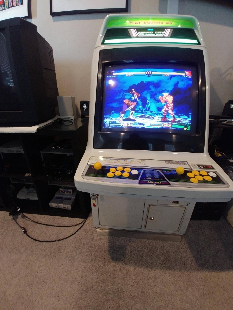

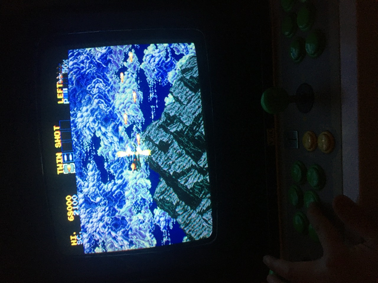

Well, the Blast is gone. These latest photos are on a different 15khz cab. Just be sure the Mister ini has forced scandoubler off, composite sync on, and ypbpr off. That will send the 15khz rgbs video signal.
