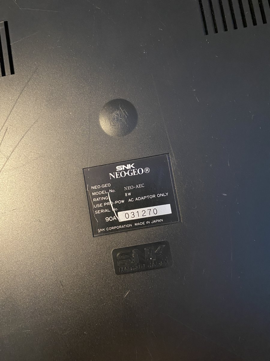

bottom sticker says NEO-AEC 90A (S/N in 30k range)

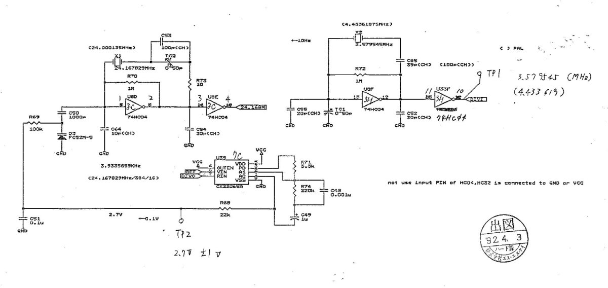

According to the available schematics, seems like only the 2 crystals and a capacitor differs, but that might be depending on board revision?
