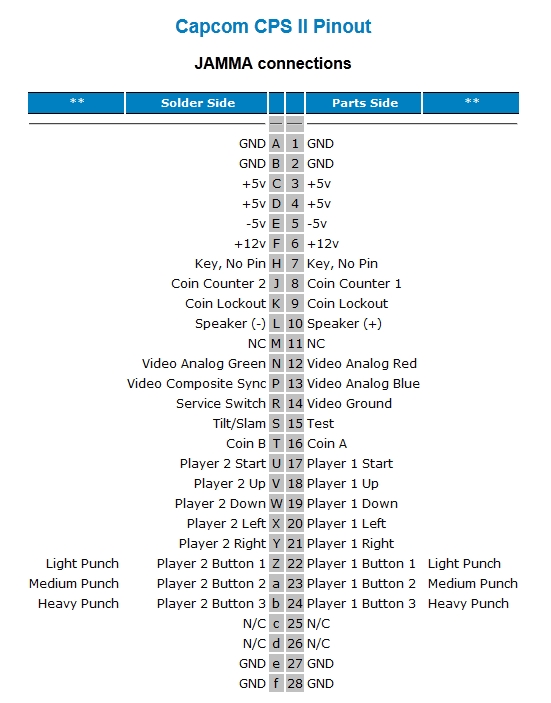

So mine's buttoned up and I can't tell you 100% sure what I soldered the ground to, but it was one end of the buttons (I THINK it was the side farther from the jamma edge)... I just pulled out a multimeter and checked continuity from one of the ground pins on the jamma edge.
@KingSopz what is that a pinout for? Never seen +5v on pin 5 before. Or all 6 buttons like that.
