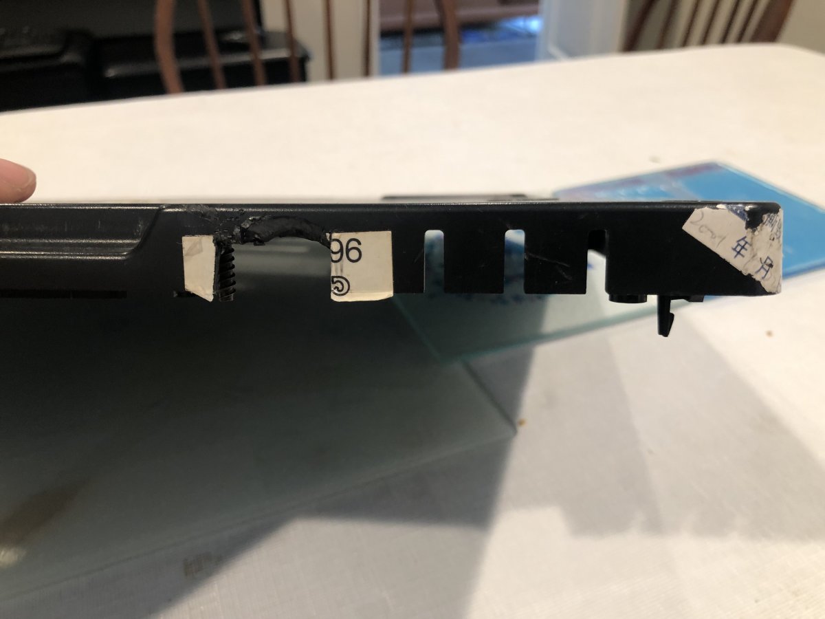

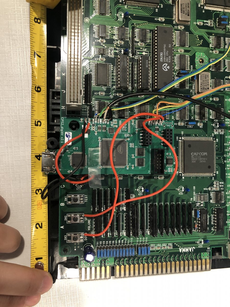

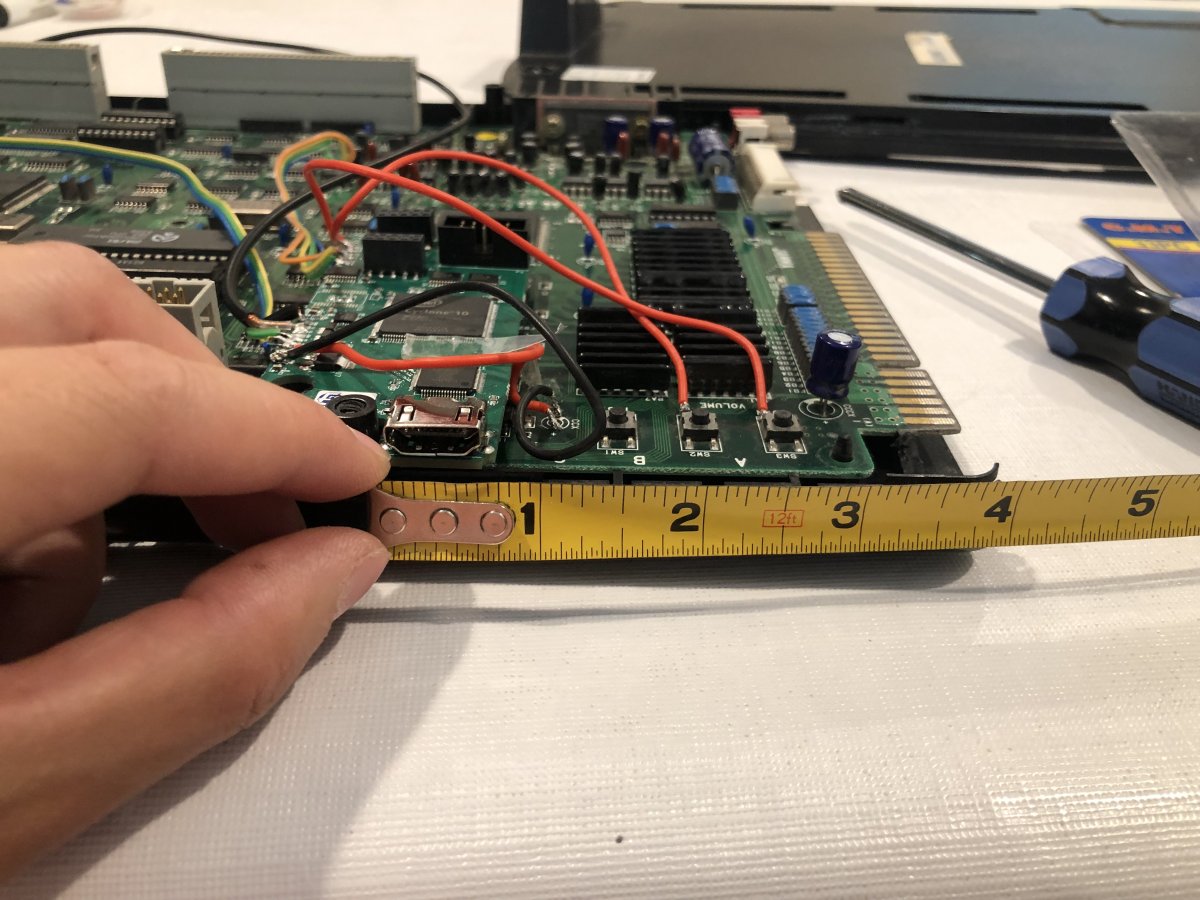

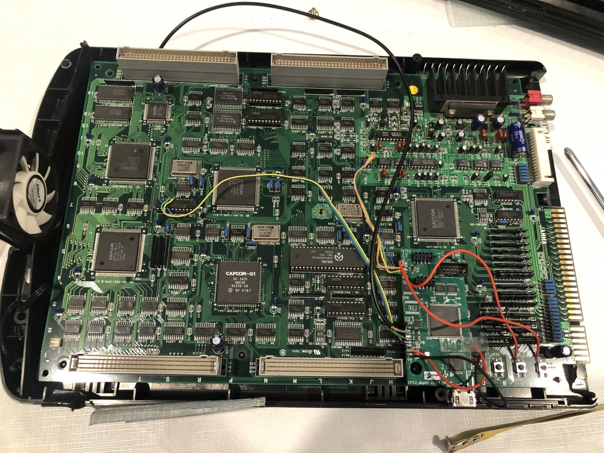

Is there a way to add additional port on bottom side of A board for HDMI out from digiAV board?
@hursit any plans to have an HDMI drilled out for this case also?
Oh shit hahaha ok. Let me do some studying and see how other people have their HDMI's setup.We have talked about it million times in this forum, but nobody tell me or give me the exact place of the HDMI hole in my CSP2 case
i can add it easily but i have to know about the place on metal case.
Here are some pictures of the position. I hope that helps.
