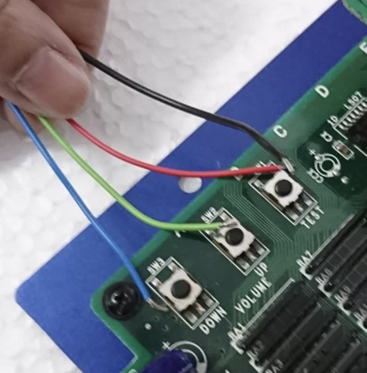

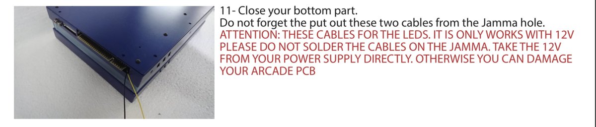

I got the case and things were going smoothly until it asked me to wire the buttons..
(my image hosting site is down, please check attachments)
How do you guys connect the 12v and ground if you’re not supposed to connect to the board itself?
And where is the TL;DR best location for those wires?

LEDs have very low power draw. I would solder the wires on the board.
That's what I did. I didn't have any dupont connectors handy so I made my 12v and Gr wire 2' long so I could open my case easily.

I soldered 12v and ground lines to the board...put a 3pin jst connector in between, and then attached the other end of the JST to the wires on from the LED.
Works fine, with no issues.

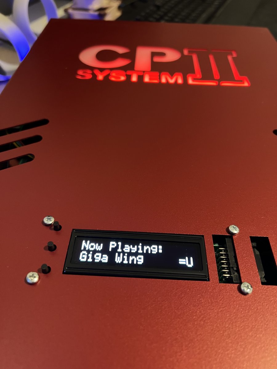

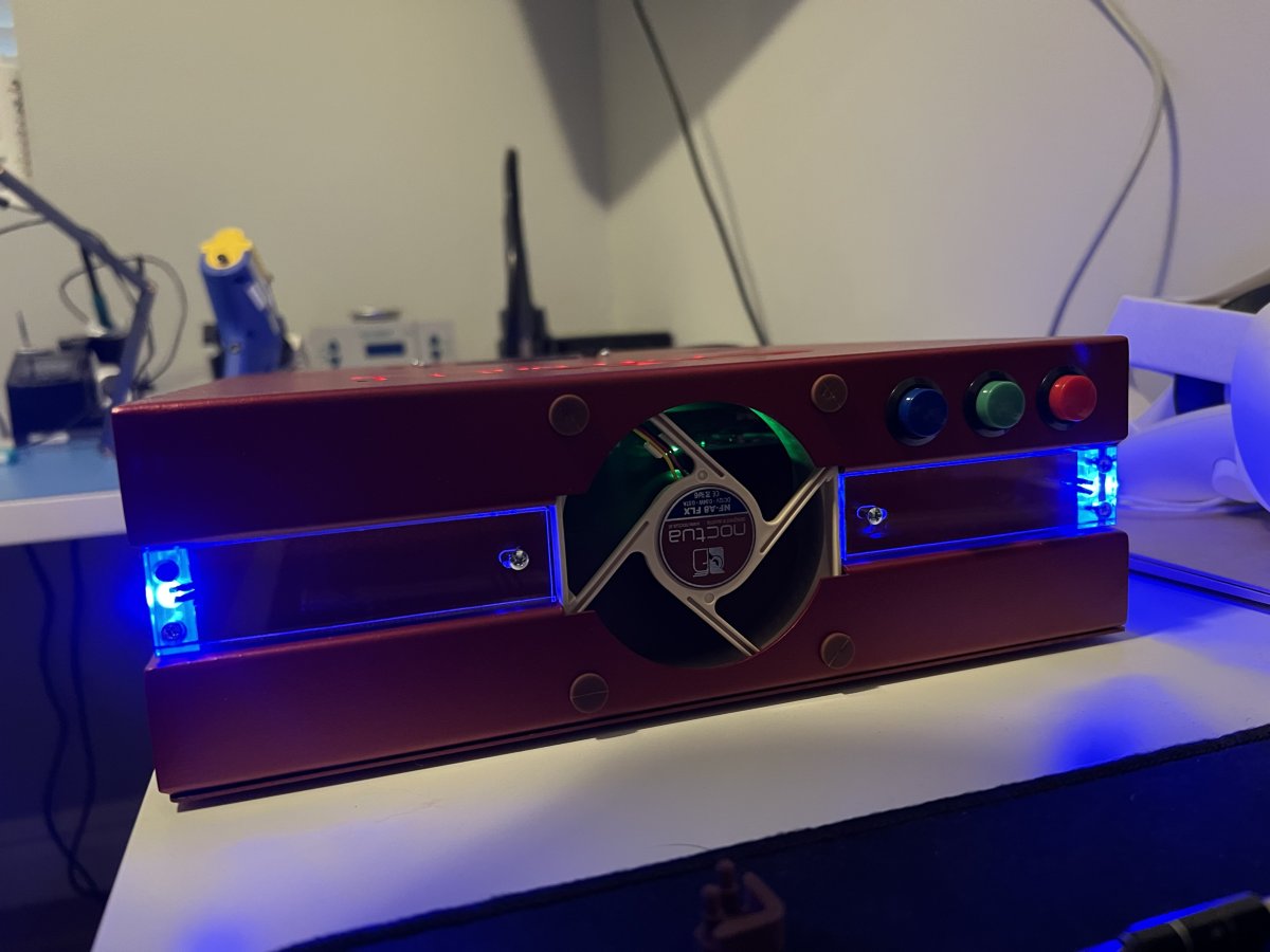

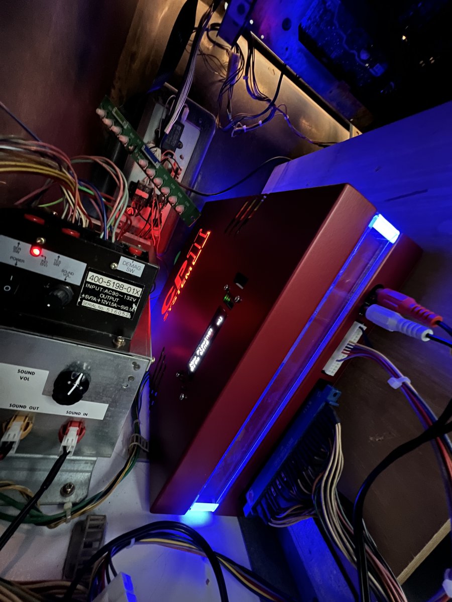

Received yesterday. Thought I’d share some photos. Pretty cool! I’m going to have to get a red OLED to replace the white, methinks.
Somewhat related question...who sells replacement selector boards for these multis? I'd like to get some in different colors.
This OLED one I use.
https://a.aliexpress.com/_mPzjt8C
Otherwise it’s a 16x2 HD44780 which is pretty standard. Just gotta de-solder the old screen to put the new one on. Having a vacuum solder sucker like a fr-301 is helpful!
