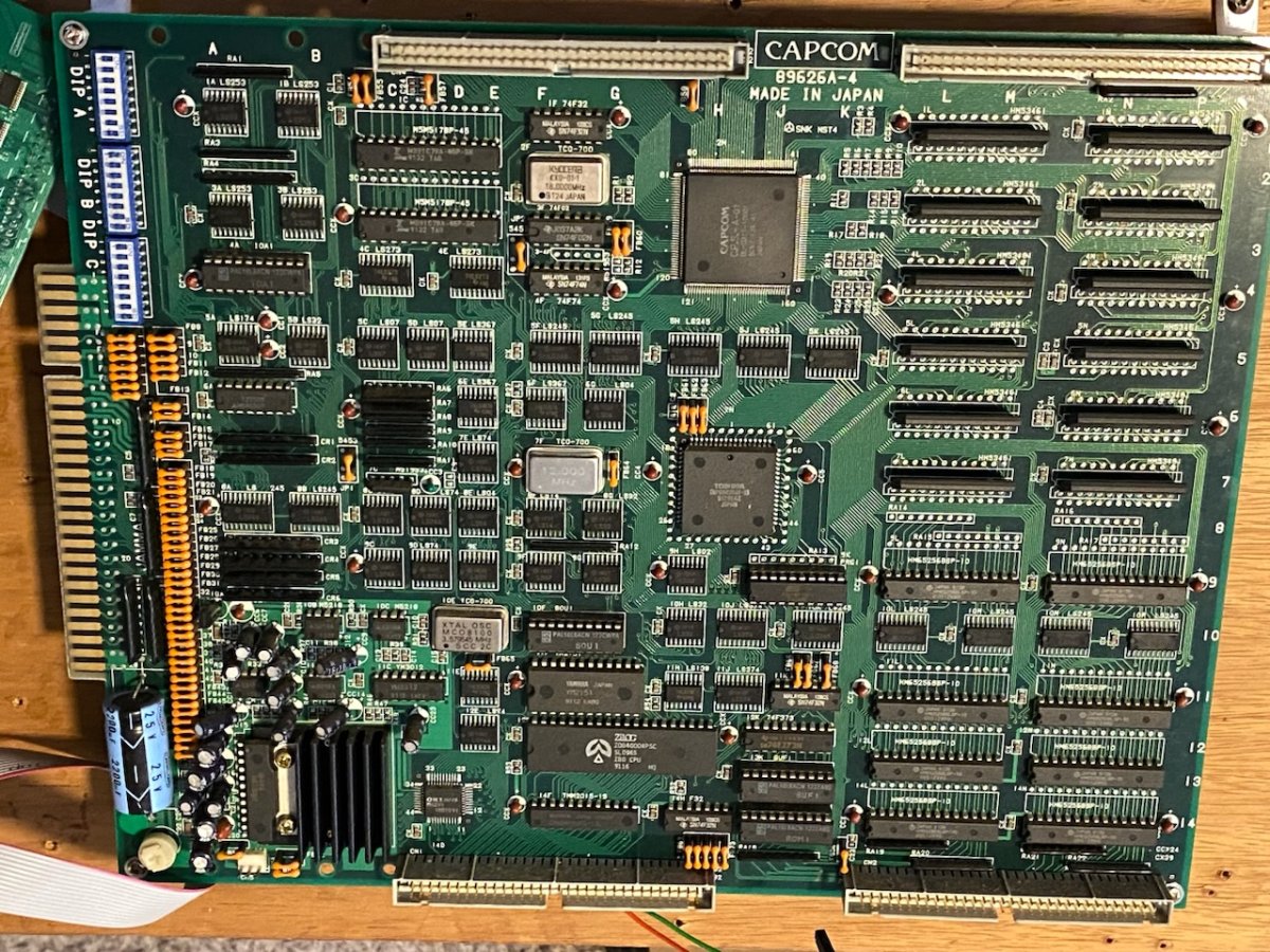

This one runs at 12Mhz. I'm not sure how the conversion was done. Can you show a picture of the A Board?
I converted it myself. Replaced the 10Mhz crystal with a 12Mhz. Not much to it.
I posted about it on my blog: http://the-artcade.blogspot.com/2018/06/cps1-dash-kick-harness-upgrade.html
Here’s a pic of my A-board. Serial # 89626A-4
