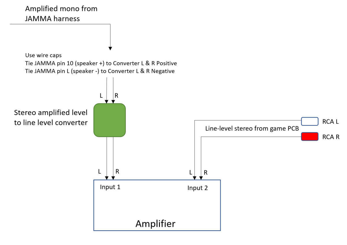

Can I bother you for a rough wiring diagram?
Here is my top-quality wiring diagram:
Here are the specific components I use - naturally there's plenty of alternatives.
Stereo amplified level to line level converter:
https://www.amazon.com/gp/product/B000LP4RMQ
Amplifier:
https://www.amazon.com/gp/product/B003NVN1PY
The amplifier is both powerful and compact - it fits nicely on top of the coin box on an upright cab (I use velcro to secure it) or off to the side in a candy cab.

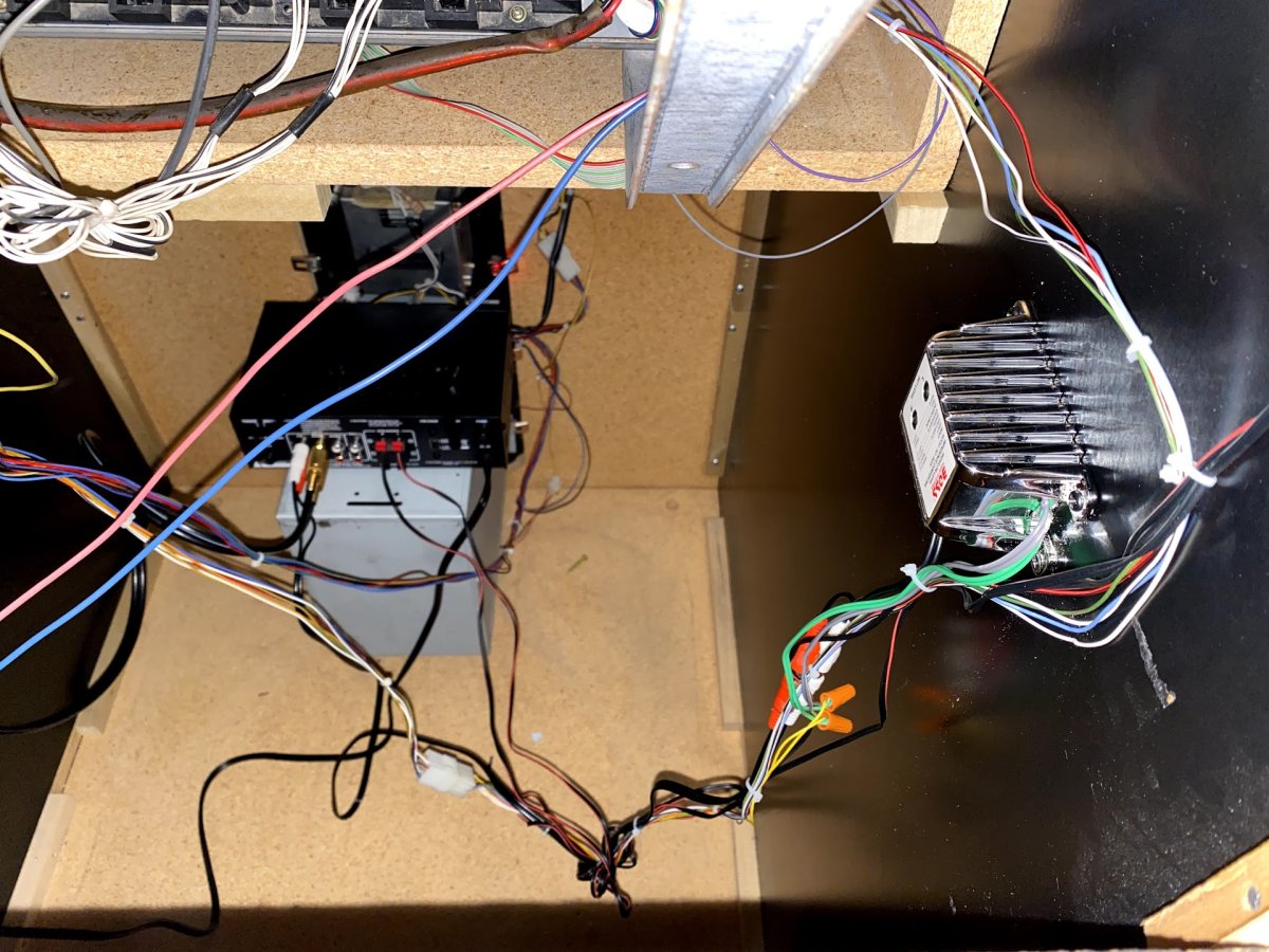

And here's how the wiring looks with the line-level converter from the back of the amp inside my upright Dynamo cab.
Later on, I squeezed in a subwoofer too. :thumbup:

Thanks so much for this!
I have my new project to tackle 😉

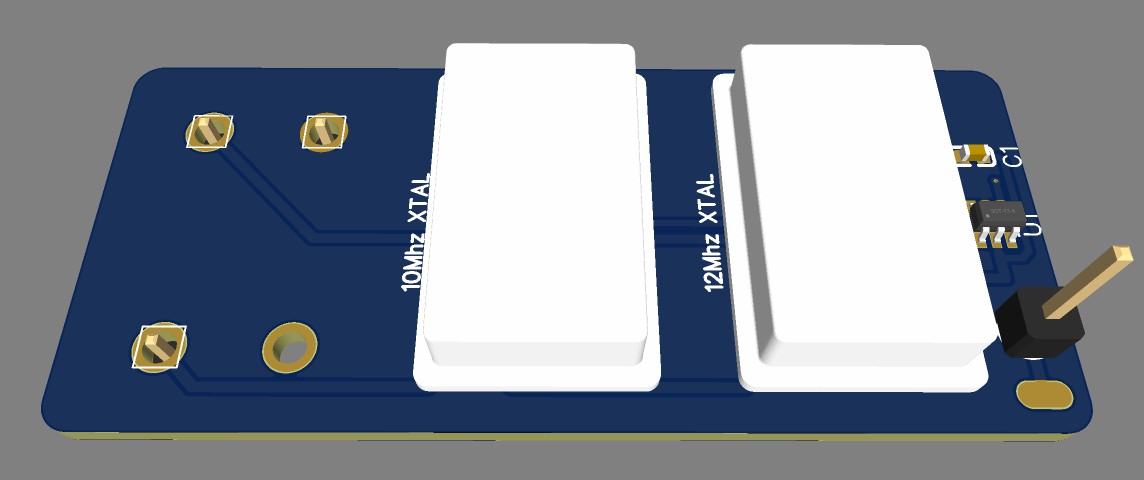

I know there are solutions for the crystal question being worked on, but I whipped this up real quick to do my own testing.
Still need to work on the layout/install, just wanted to get a working circuit put together.
I still think a DFO is the way, but this was simple to put together/test with.
