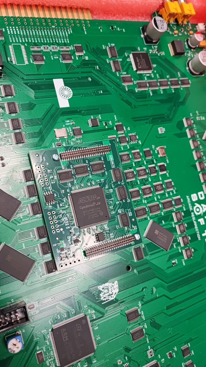

This is the reason why the FPGA solution if implemented correctly, will work the same as the original QSound Q1 chip. @Darksoft, working with @jotego, has already tested and verified that the FPGA solution works exactly like the original.
So as long as you have a stereo amp/speaker setup you should notice the Qsound 3D effect. Will it sound better? That's up to the listener :P

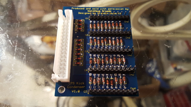

With so many cool multis out with the LCD panels, is someone out there planning on making an LCD condenser (so only one is required per cab)? If so, I’d happily purchase one before I mickey mouse one together.
Much like the kick harness condensers:
Darksoft needed to laser-etched the Altera chip as "DARKSOFT - Q1" :D
That's a nice idea :)
The beauty of this plug-in module is that if the original Q1 chip fails, you can easily plug in a replacement. @Darksoft thinking ahead just in case, thats what I call added value :thumbup:
Yeah, you could do that, but for now the FPGA is only available for CPS1 Multis.
