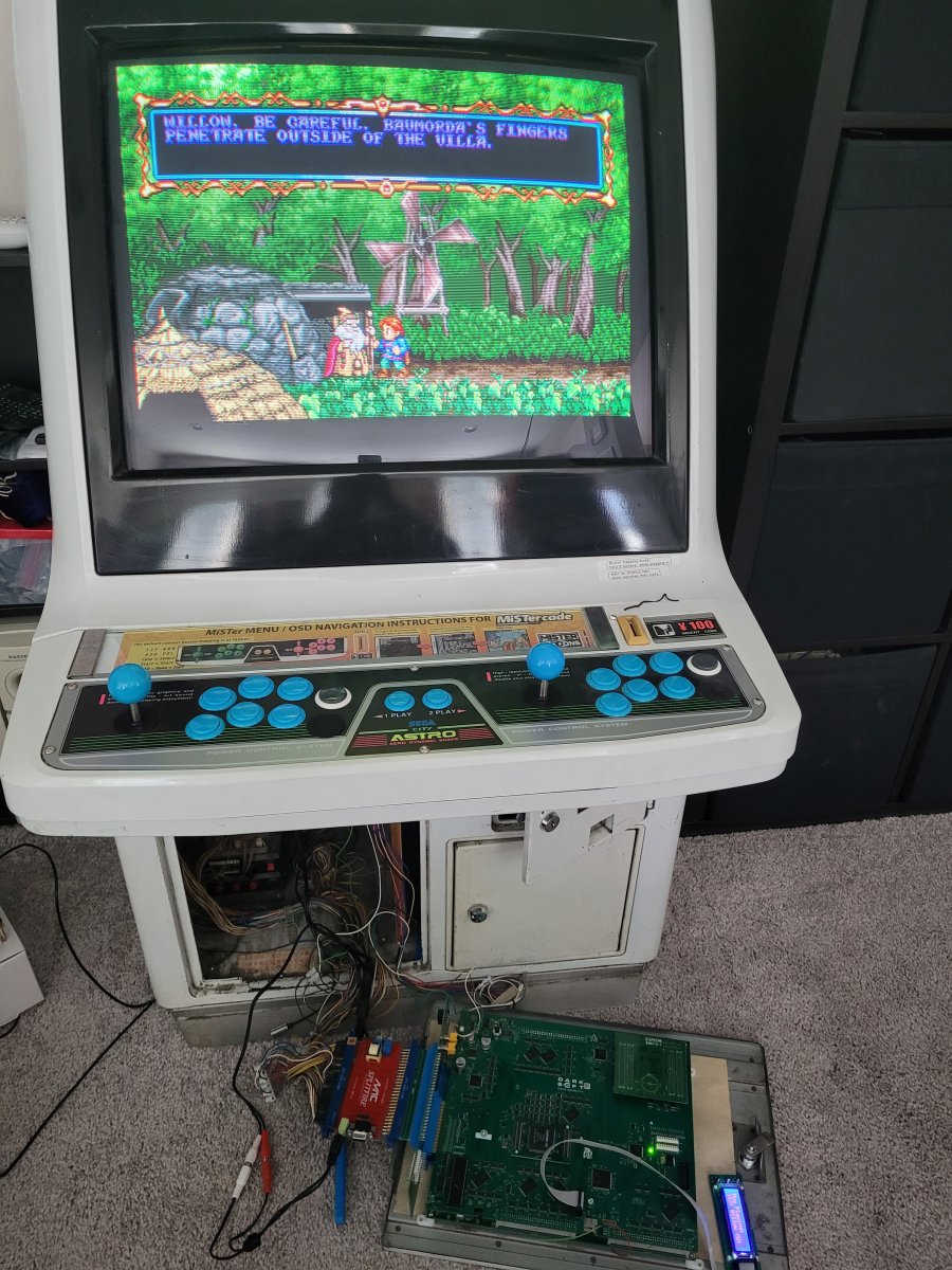

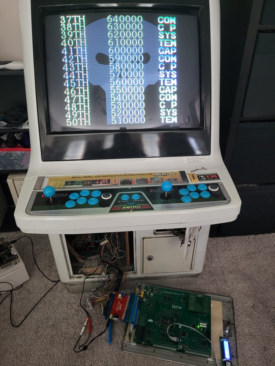

Received my kit about a week ago and finally found some bandwidth to do the install. No real hiccups even for an admitted amateur such as myself. If I can do it, anyone can do it.
Components:
  • SF2 CE (USA) w/ dash 12mhz A board
  • 92641C-1 C board (unmolested, purchased from I believe sheep_nova?)
  • old 2GB SanDisk microSD
Only "mod work" done was the wire soldering and removal of the C board battery. Everything else was straightforward according to the instructions and forum support resources.
Now I wait impatiently for the necessary add-ons (spinner interface, 3p + 4p adapter, dual crystal board, proper case). It's ok, been waiting impatiently for about 5 years and now we're here finally. This is especially sweet for me, as the donor SF2 CE was my first ever board and it came with the cab in pics, which was also my first. Everything feels complete now.
Big thanks to @Darksoft and everyone else who made this possible. Gonna be a fun holiday weekend for me.

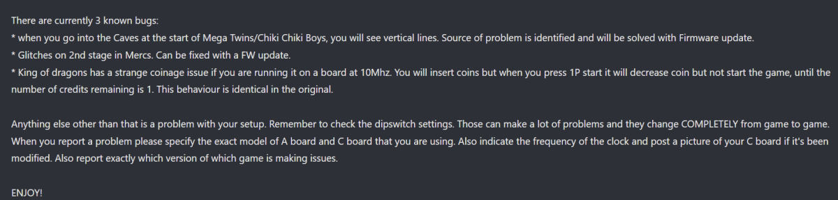

Where can we report bugs?
Not sure if this has been covered yet but...
Mega Twins (USA)
On a 12mhz-A
Minor grafix glitches in the last background layer of level 2 (Cave level in-between the pillars).
Flickering credits/picture-tiles on the ending/completion sequence.
Mega Twins (USA)
On a 12mhz-A
All issues go on the support thread,
But that bug is known
Didn't mention the ending credits flickering, but yea its prob known as well.
Yup, report on the support thread still, but I think its most likely related to the same bug.

@Epyc is trying to see if anyone else is having this glitch:
All games have been extensively tested. That glitch would be like a punch in the nuts. We would have noticed. the problem is most probably in your setup.
Yup! We are leaning towards the problem being with the A board?! Every other game works, besides the known bugs of course.
