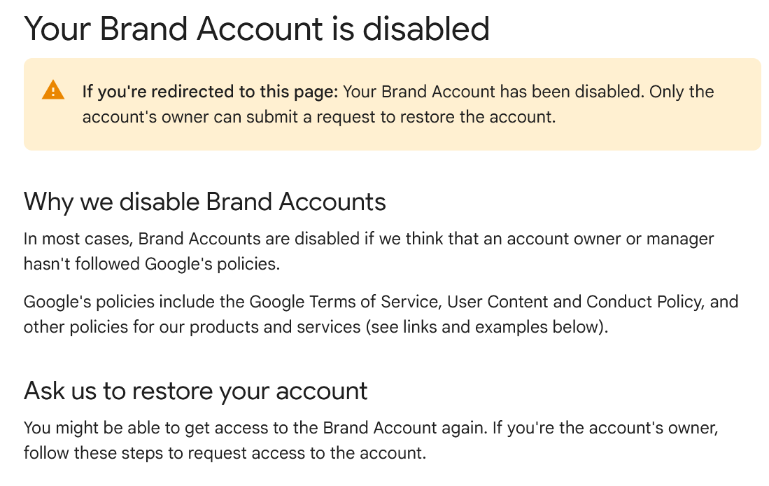

FYI: YouTube just took all of my videos offline, including the CPS1 Multi Tutorial video. I don't know why yet, but I've submitted their appeals form. In the meantime, if anyone needs the installation tutorial video for the CPS1, Namco System 1, Irem M72 or System 16 Multis, shoot me a PM.
I was still able to view your videos but your channel icon showed as backslash-user icon.

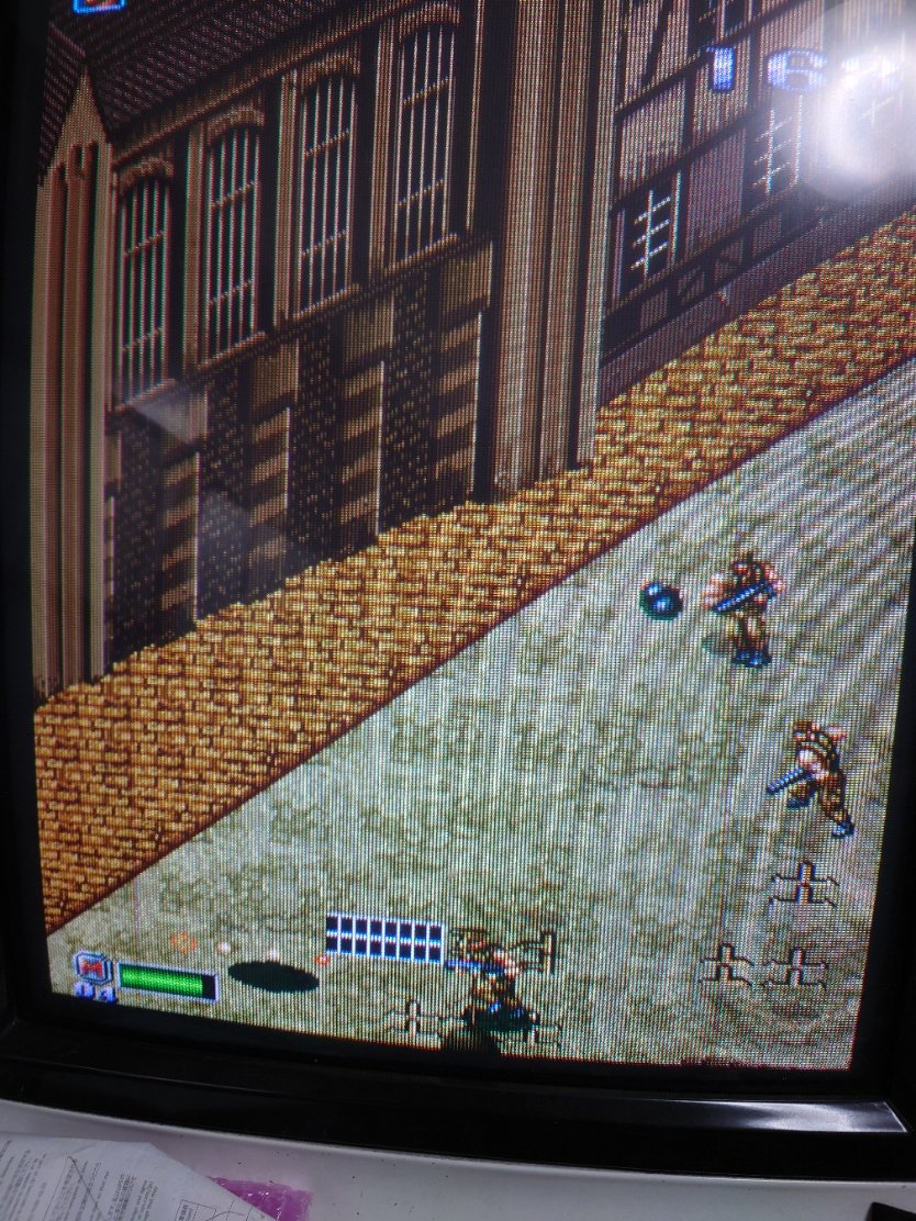

I played it immediately and found that the background was strange in stage 2 of MERCSJ.
My board is the 12Hz version.

This is one of the 3 bugs specified in the list of issues.

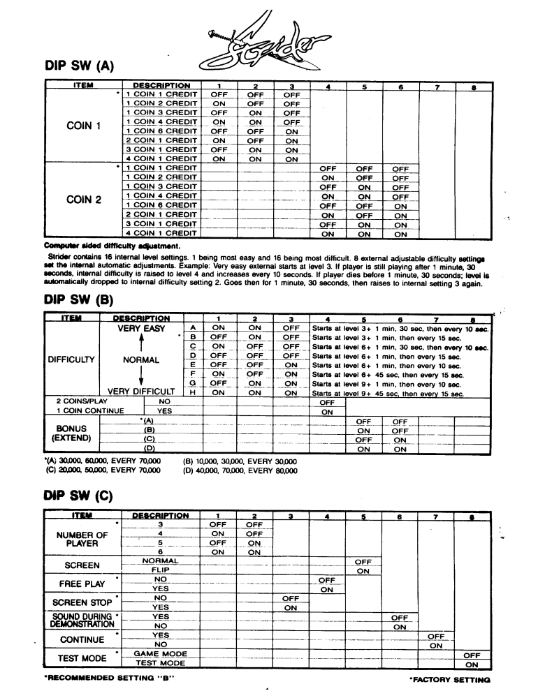

I'm going by what's in MAME which shows something kinda different to the manual (all were set to defaults by pressing enter on each item). The "Internal Diff. on Life Loss" isn't even mentioned there so I really don't know which one is correct:
Anyone with advanced knowledge of Strider or a picture of the JP instructions? Wouldn't be the first time a US manual had an error, but also MAME gets stuff wrong too, so I don't know which one to believe.
Strider is only on dip switch A, number 8.
This is the difference between table or upright specifications.

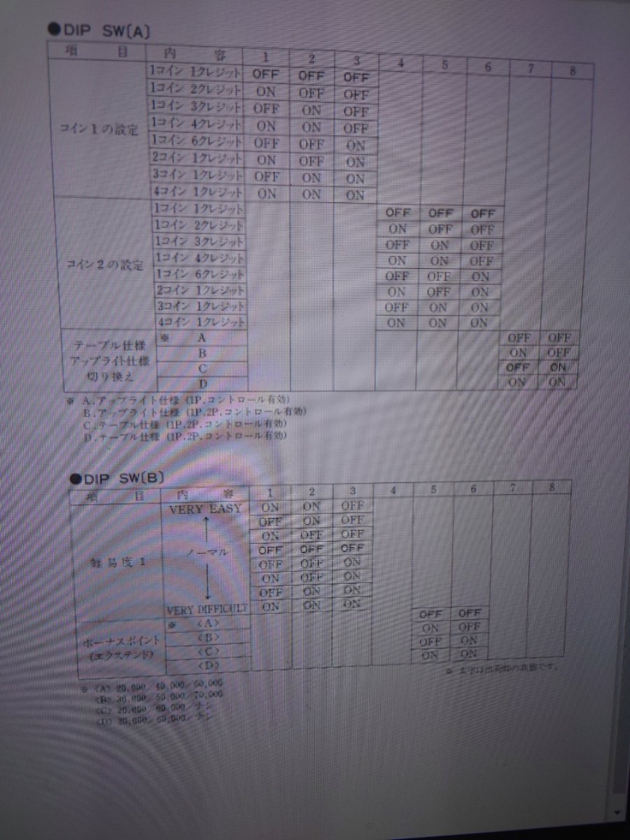

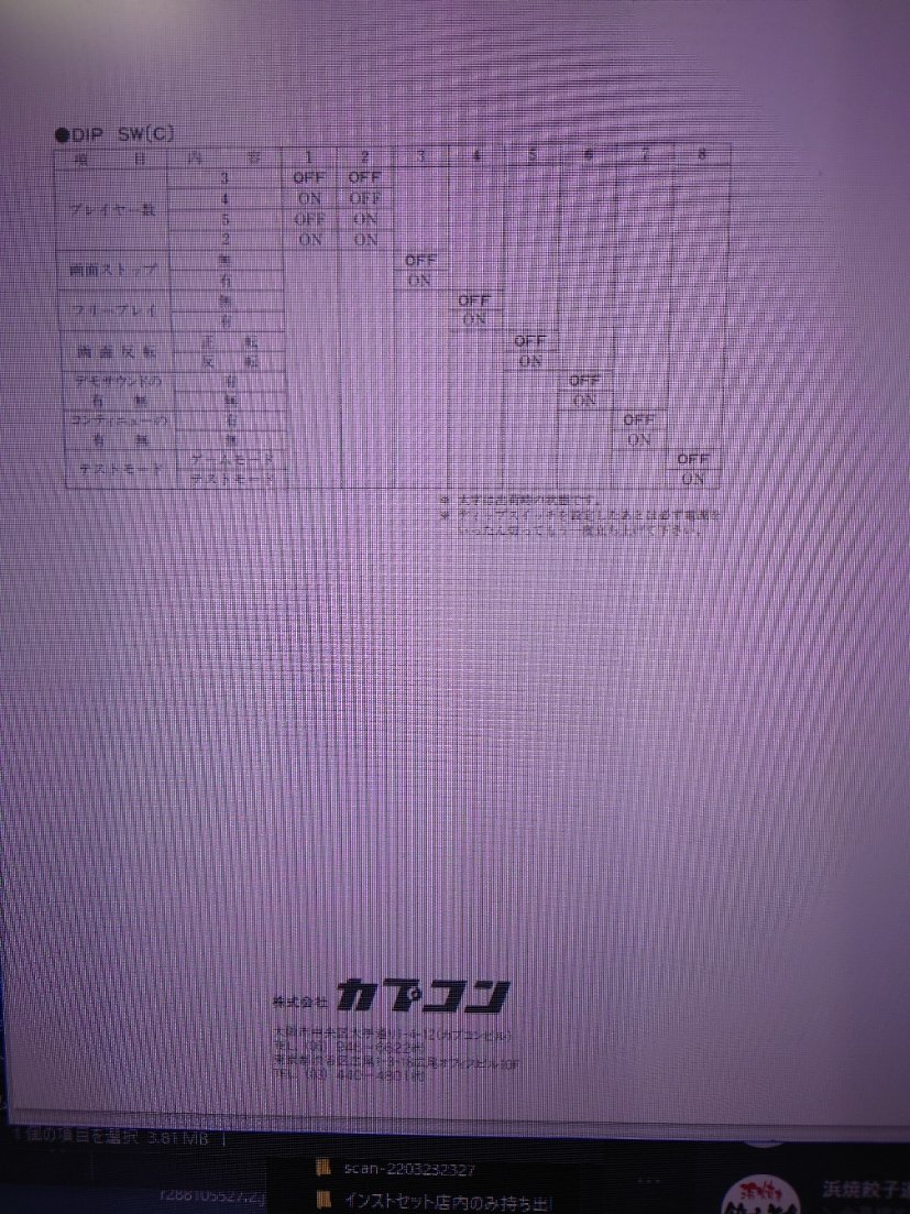

I don't understand your post can you please clarify? Also, your scan of the JP manual doesn't seem to have any indication as to what factory defaults are.
Here's a cleaner picture, defaults are marked with an * (and we really need a google sheet or similar database of dip settings).
Yes this source is what I was using, but @dos found that MAME has a different default setting (must be a mistake) and we were inquiring if someone maybe had a Japanese manual that had different settings. (which I cannot tell if it does because it's in Japanese with no asterisks)

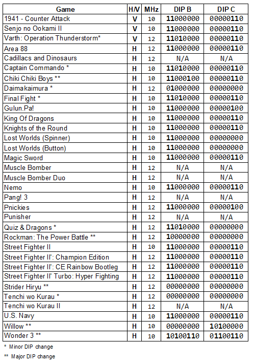

Regarding DIP settings: is there any possibility for a text file in each game folder to contain the settings and override the hardware switches? I'm assuming the answer is no unless modded ROMs were made, correct?
Also, what are the plastic standoffs provided with the kit for? Are they to help support future add on boards?
Only IF each game was patched to behave this way.
That would interduce another problem/issue... We would need to decrypt the ROMs to patch them, and then re-key the ROMs.

Thanks @TMF68k I'll revise my list. For all wondering, it's hard to see but defaults are bolded in his pic.
EDIT: Basically Japanese default DIP settings for Strider are all off. This sets the rank to 6 at start but subtracts 3 when losing a life. The DIP A defaults to a table cab in the JP version because table cabs were default in the 80s. Setting DIP A to all off is correct for "upright" (no flipping per player).
EDIT2: Leaving my "default" DIPs set for strider takes it down to the easiest difficulty level, still a major change in my opinion.
Wow, so the USA manual, JP manual and MAME all have different default settings listed :D
I think I’ll continue using the USA manual listing, that makes the most sense to me I guess.
Yea I'm seeing some issues myself, I say we re-test these DIP setting on actual hardware.
I suspect the MAME team may have inverted some banks.
