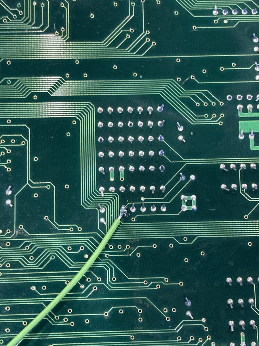

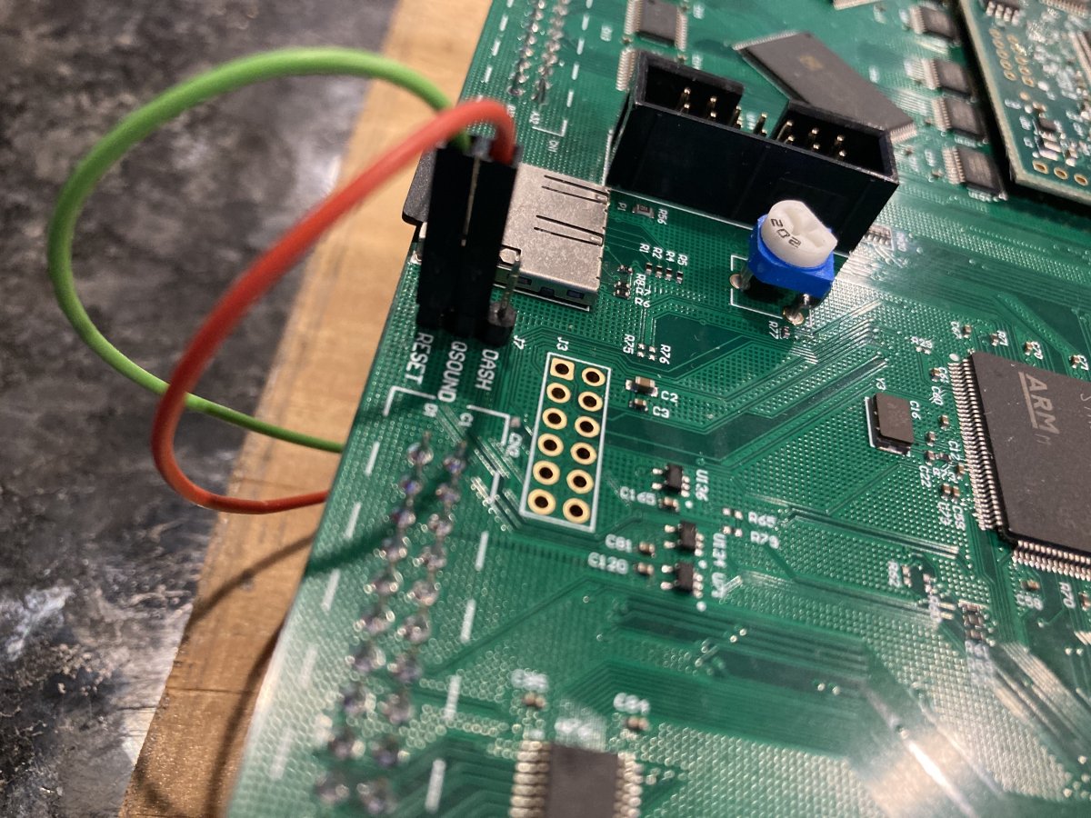

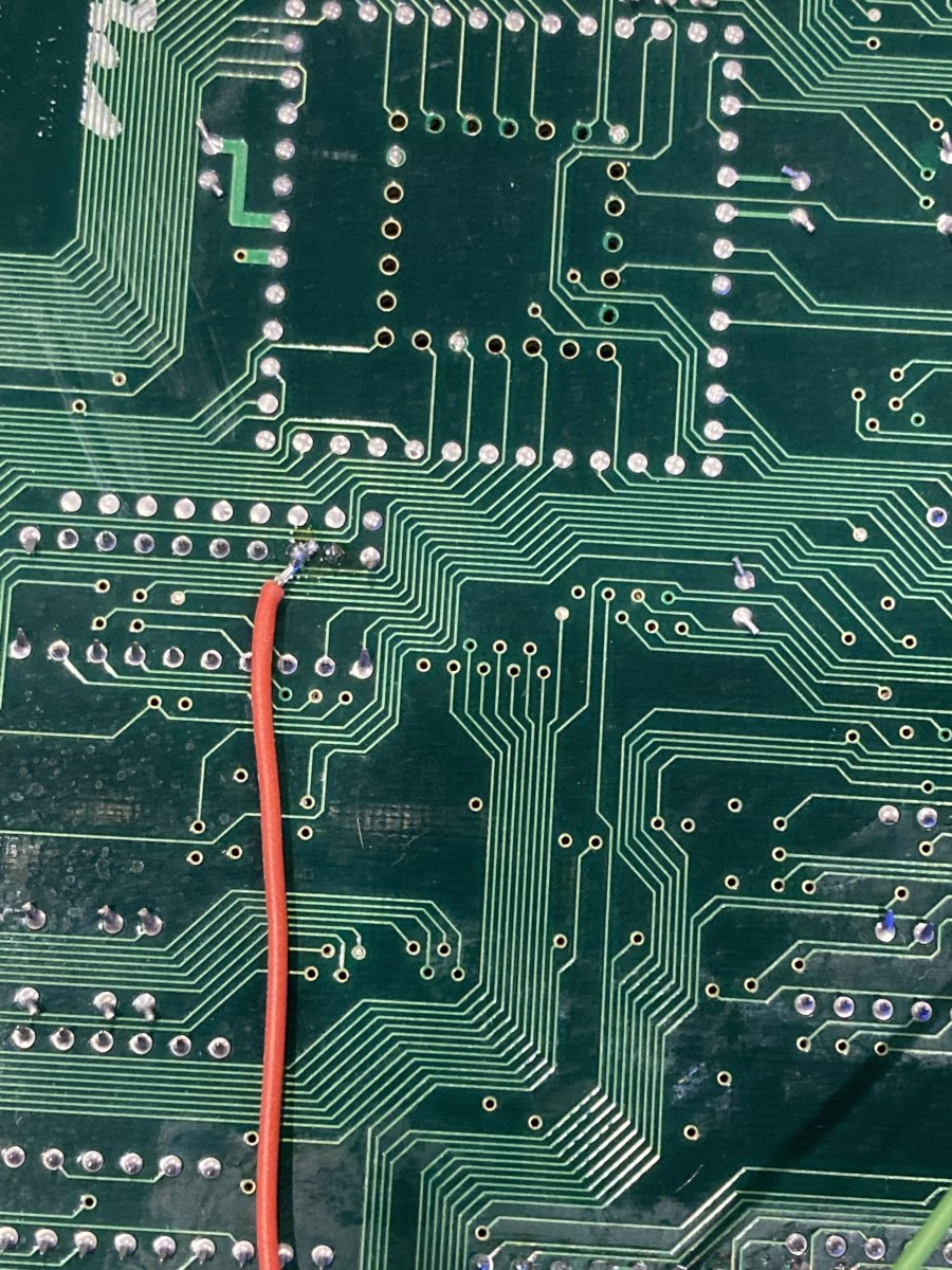

@obitus1990 to me it sounds like the reset wire is not installed properly. Perhaps reset and qsound are swapped. Pics of the install would be more useful than just A board eBay photos to confirm that though

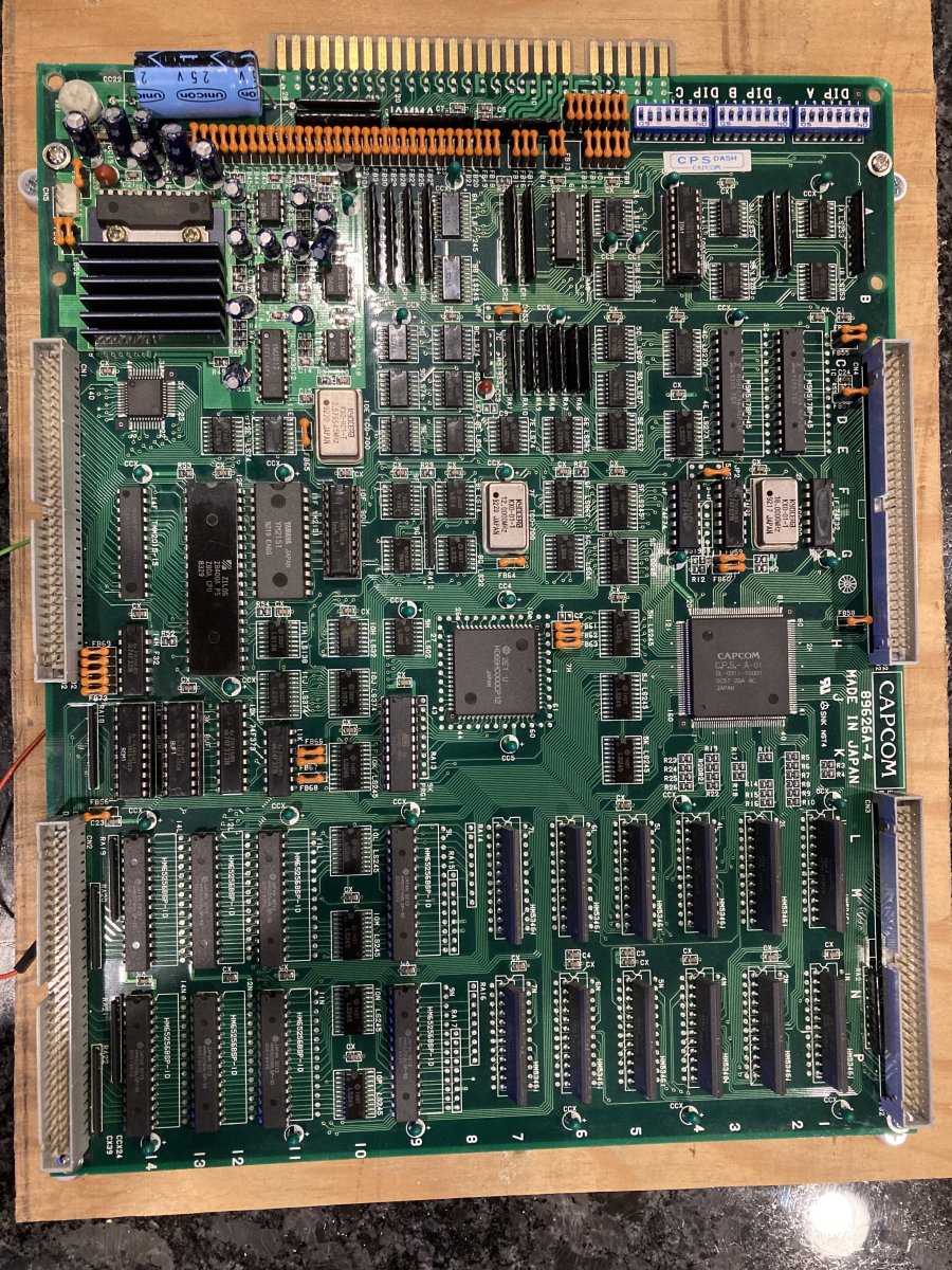

Give me a few to go remove it and take a photo. I triple checked to make sure that each wire was connected to the proper points, including soldering longer wire in its designated position per instructions, etc. I tried Final Fight as well, and had no issues with sound/music, nor with Punisher.
Do you need to see more than this (from the eBay listing where I purchased it)? If so, I'm going to have to go unscrew it from the cabinet and disassemble the whole multi to get anything further.

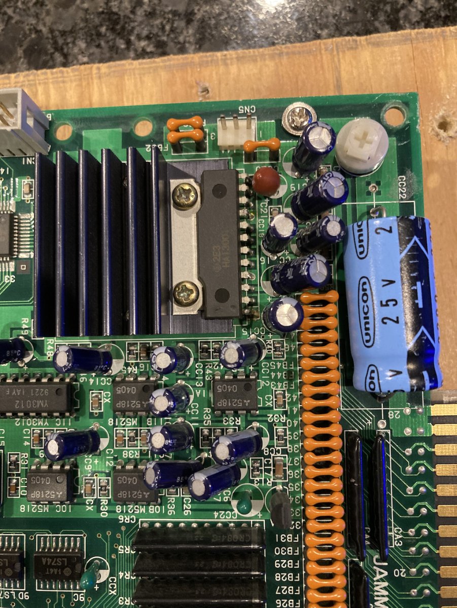

I wanted to see the amp section to verify that it was not using a low quality amp.

Photos as requested.
Your A board looks pristine. Please check 5V and 12V on the JAMMA edge as well.
