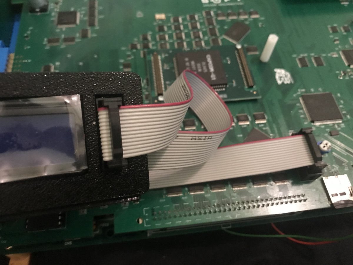

-Was able to reverse the LCD cable. I had thought it would only insert the one way, there's no mention of the order in the manual so maybe this doesn't affect performance either.
What? Can you send a picture of the cable?

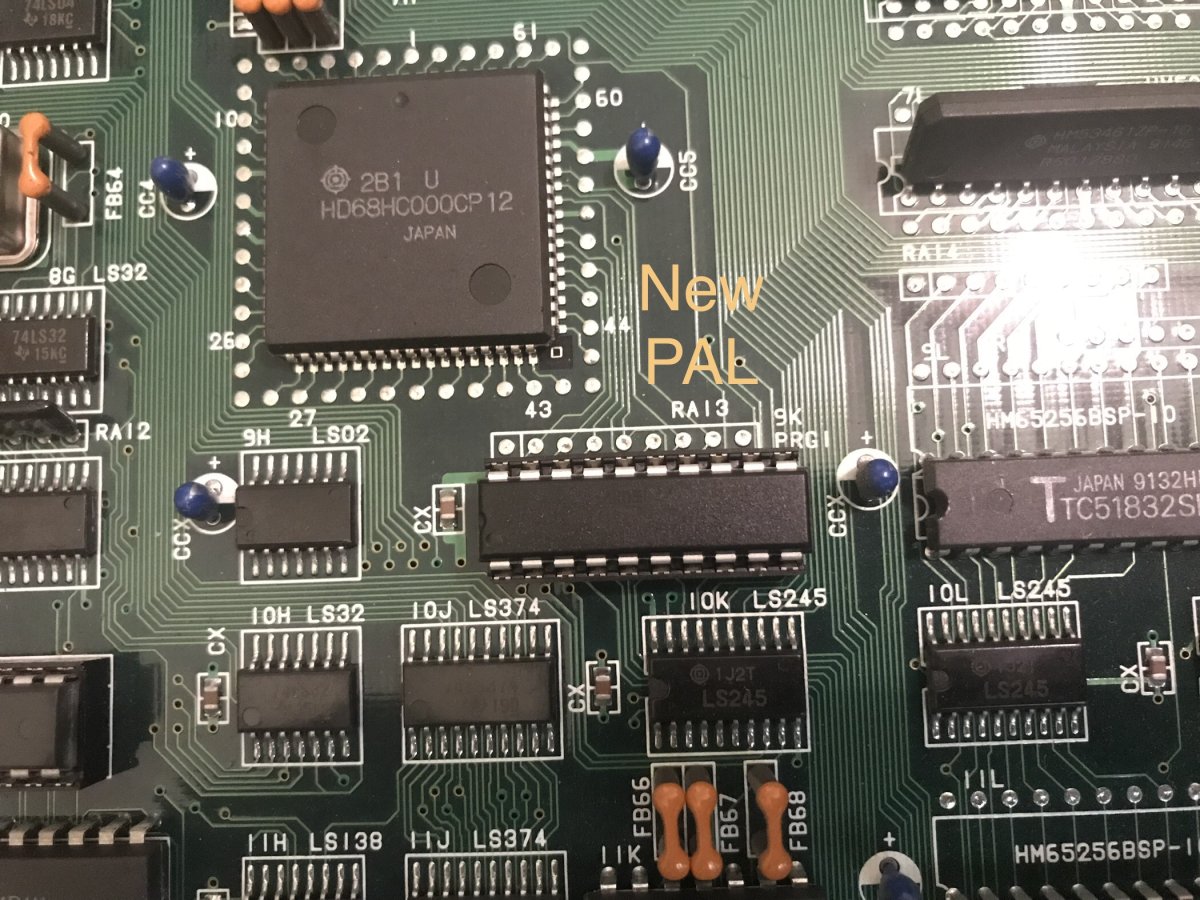

The two issues from above happen exactly when you havent changed the PAL in the A Board or you gor the wrong one. Sorry for the noob question but did you insert it properly. Can you post a picture?

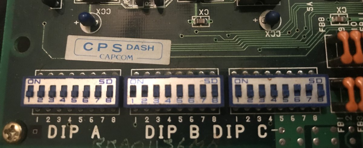

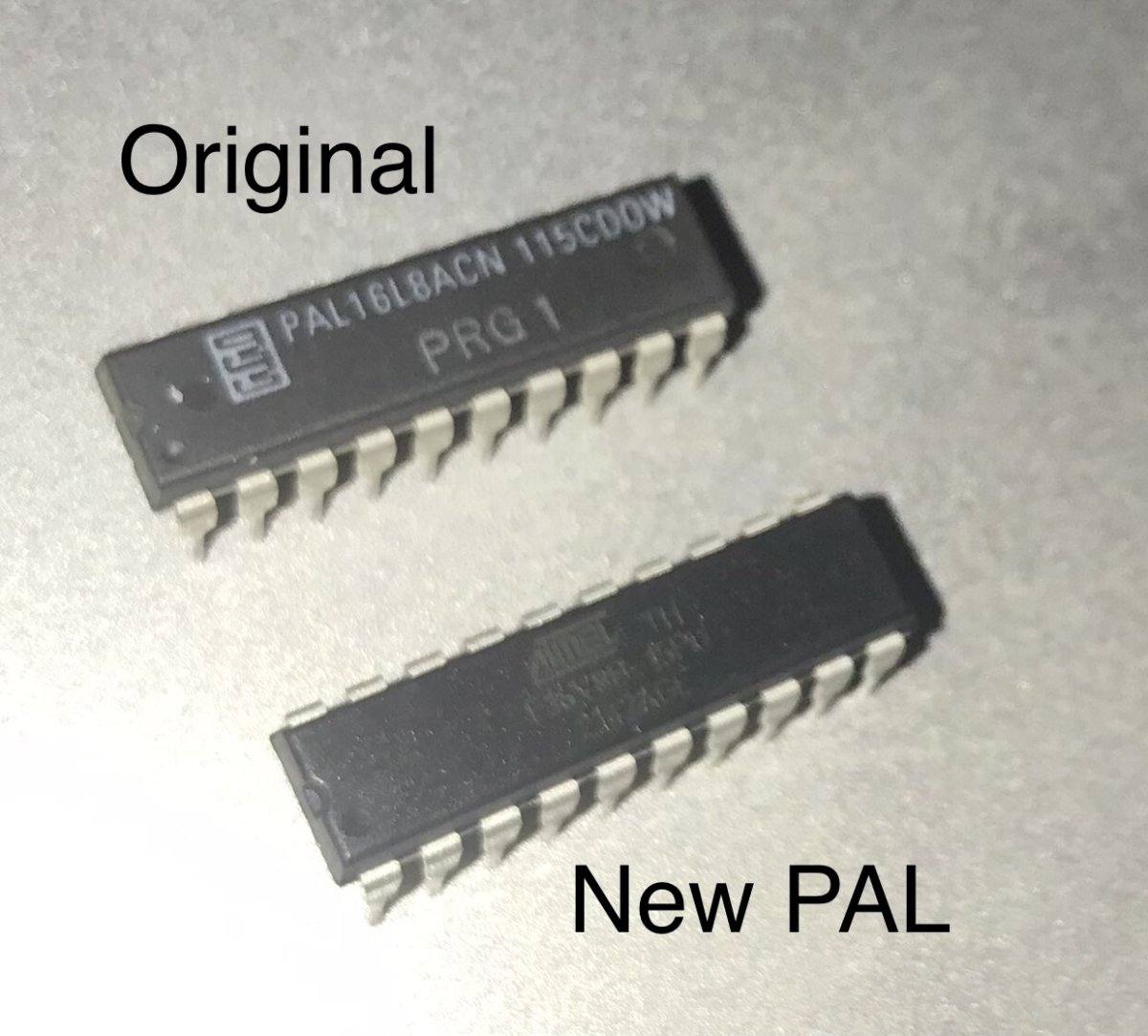

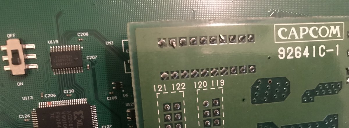

Here are a couple photos of my install with PAL, cables, and C board with switch to ON and one of DIP settings. Maybe there is something obvious I overlooked.
I tried putting the original PAL back in, but then no other CPS 1.5 games load (just to make sure I was using the new one)

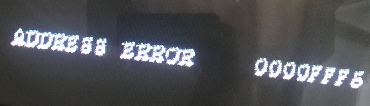

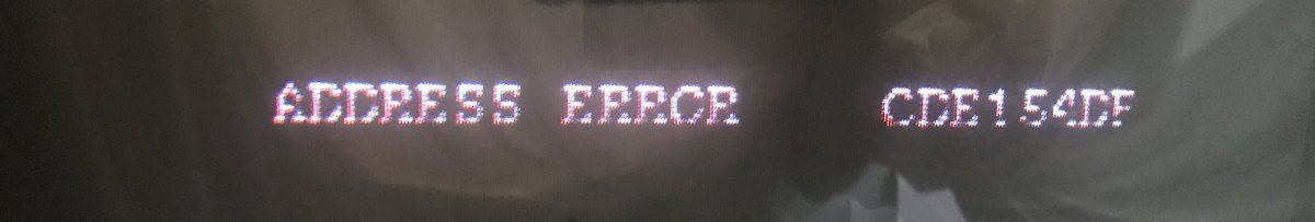

With the new PAL, all CPS 1.5 will load except Musclebomber/Slammaster games. Though no CPS 1.5 games have audio through JAMMA edge. Also here is a screenshot of the address error when loading a Musclebomber game.
The LCD cables seem fine, both orig cable and extension cable are pinned the same way and I have the red wire on top.

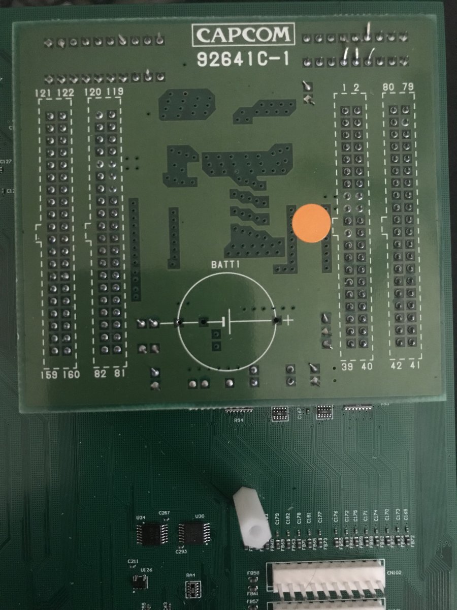

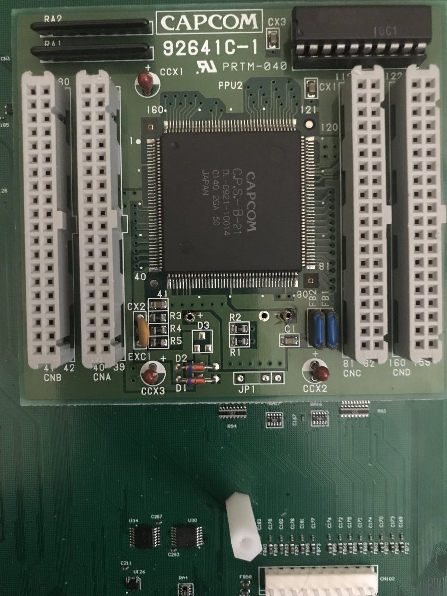

It looks good. Send me a picture of your C board both sides please. Also those dip switches, I'm not sure if they're OK.
Cps1.5 settings are managed by service menu. Cps1.5 A-board doesn't have dip-switches populated so it would be wise NOT to assume they won't interfere with normal behavior, in fact there's a case that prevents any tampering other than volume knob. Please dont take for granted there's a default dip-switch default for all games unless 100% tested.
Here are C board front and back photos. With Cadillacs and Dinosaurs, in the system config menu I attempted to change from Qsound to monaural. On my stereo only cab, this made it so there was no sound. Then moving the board to a JAMMA edge sound only cabinet, there yet is no sound. I turned the Qsound pot on the multiboard back and forth the entire movement to test.
I'm not sure where your problem comes from. Everything looks good. Can you look for sometthing odd, like bent pins on the Z80 or something similar?

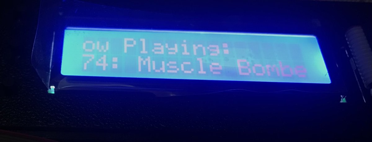

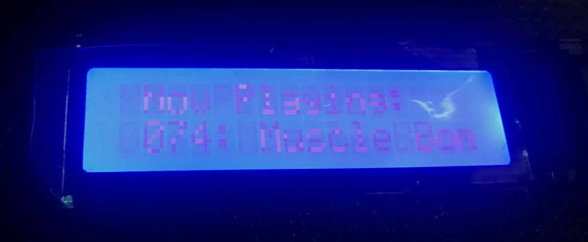

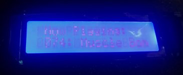

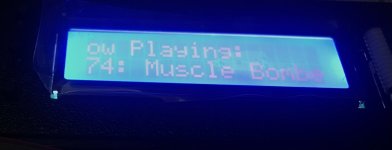

When running 74 Musclebomber Duo this error appears on screen currently.
Perhaps I could reformat and reinstall files on the SD card one more time. It is the card provided from highscoresave.
