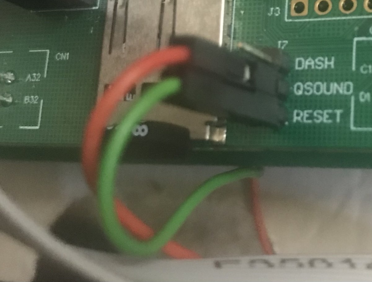

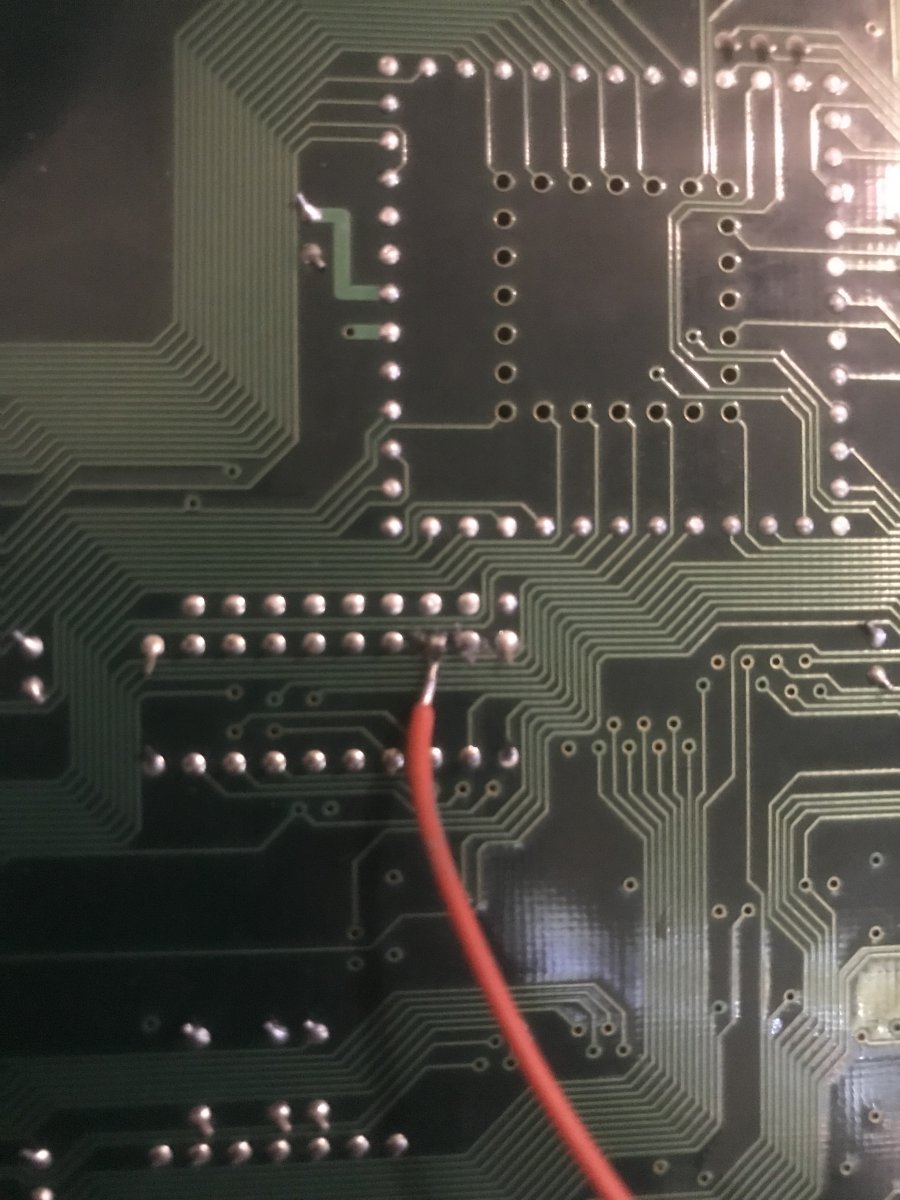

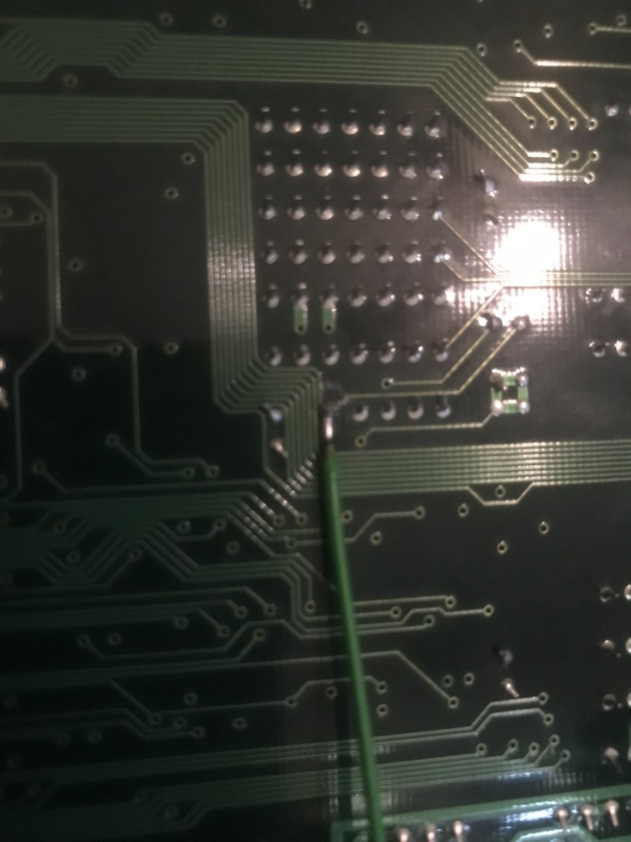

I would re-check step 2 and 4 of cps1 multi guide. Check the cable, check each end with multimeter, check the reference photo for the exact point, maybe you missed something, try resoldering and reconnecting to Q-sound pin.
Tested volts and received 11.66v at the 12v spot.
The solder points for Qsound and Reset are as shown. I used the red wire for Qsound as it was too short to use for the Reset. Using a multimeter continuity test shows good connection from the solder point to the underside of the pin that the other end of the wire plugs into. Using a multimeter also shows the soldering is clean and is not mistakenly connected to additional adjacent pins.

so you plug the red where it says Qsound, right? and the green where it says Reset?

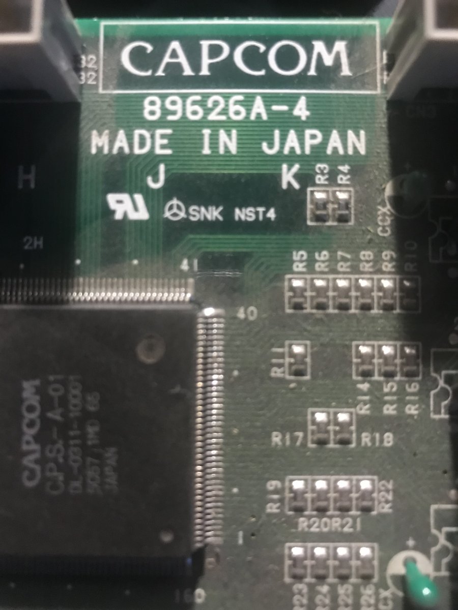

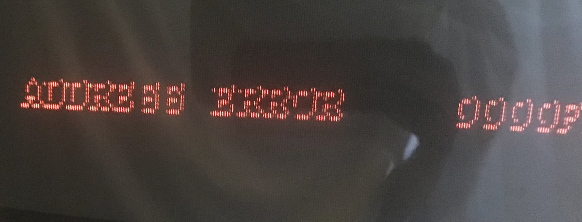

Update: I tried another A Dash 12mhz board that was tested working immediately before from a SF2CE (photo shown).
Unfortunately I am getting the same results. When I booted 74 Musclebomber I get the same visual blocks as when I had tested the other board using the PAL that originally came with the A board. Attempting 72 Musclebomber gave me this Address error shown in the photo which is similar to before when using the new PAL.
Wondering if the new PAL sent to me with the multi is bad or incorrect, or where to go from here. Due to the fact that all Musclebomber and Slammaster games do not run there would seem to be something special going on with that. Punisher and C&D play fine but no sound.
Or a C board issue?

I would say that maybe your C board is bad. If you can try with another one, that'd be great. If the behavious is still the same, then pack it and we'll have a look. I wonder if @Mitsurugi-w would have some free time to have a look?
