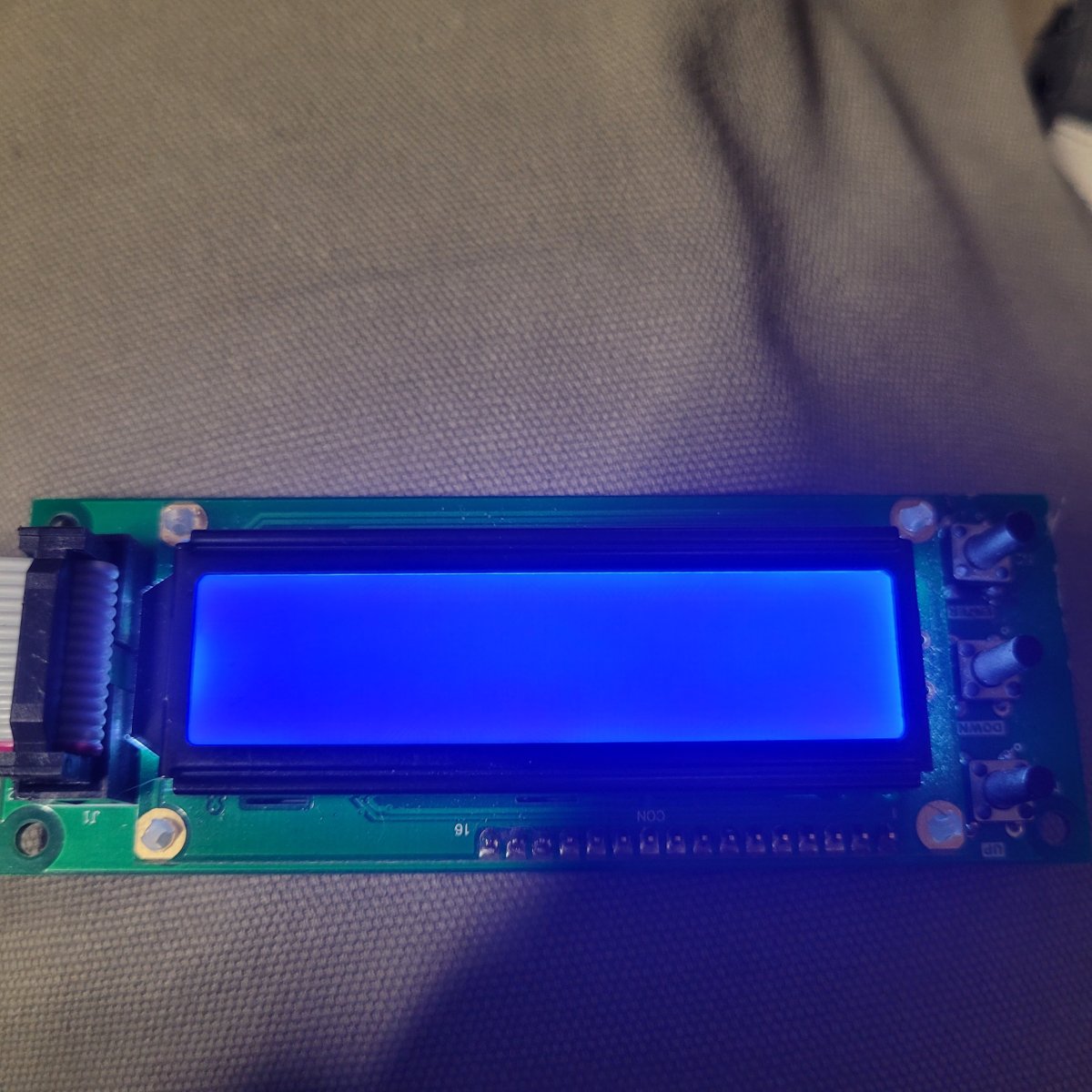

Is there anyway I can get a new selector please? Screen washed out and select doesn't work.

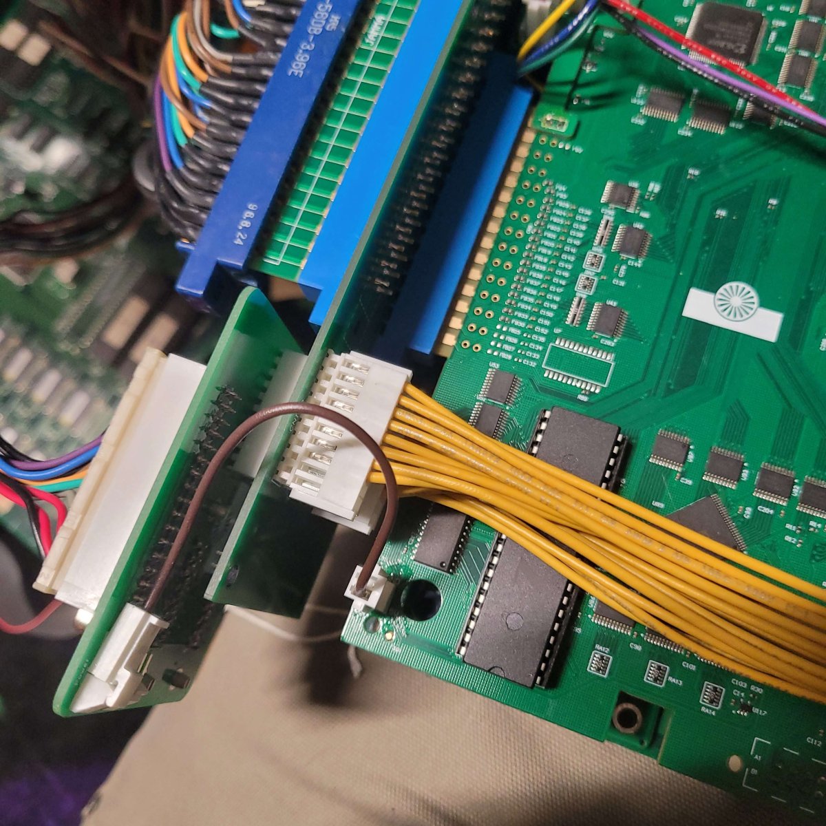

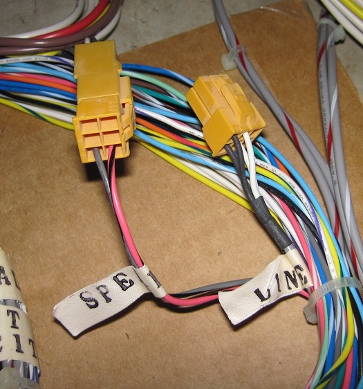

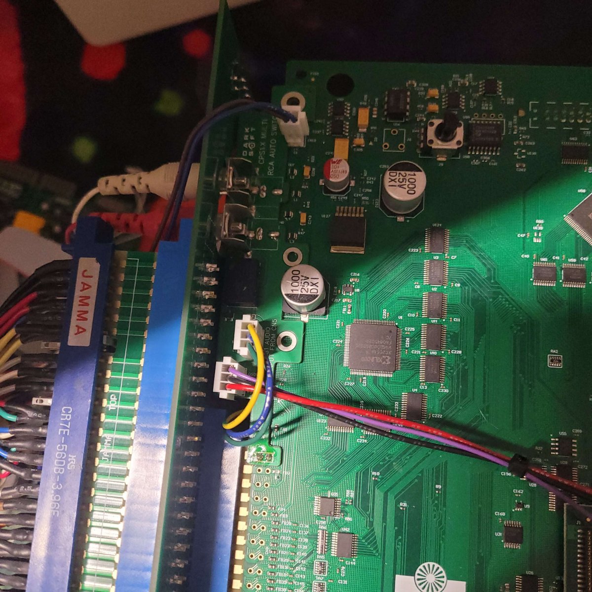

Question is it normal for cnd to give audio without rca plugged in? I dont notice anything different when plugged in or not. Also are these plugged in right?

I figured it out theres a stereo plug and a mono plug on the psu itsself in the front that iv never messed with since i bought it 4 years ago. Everything works now.

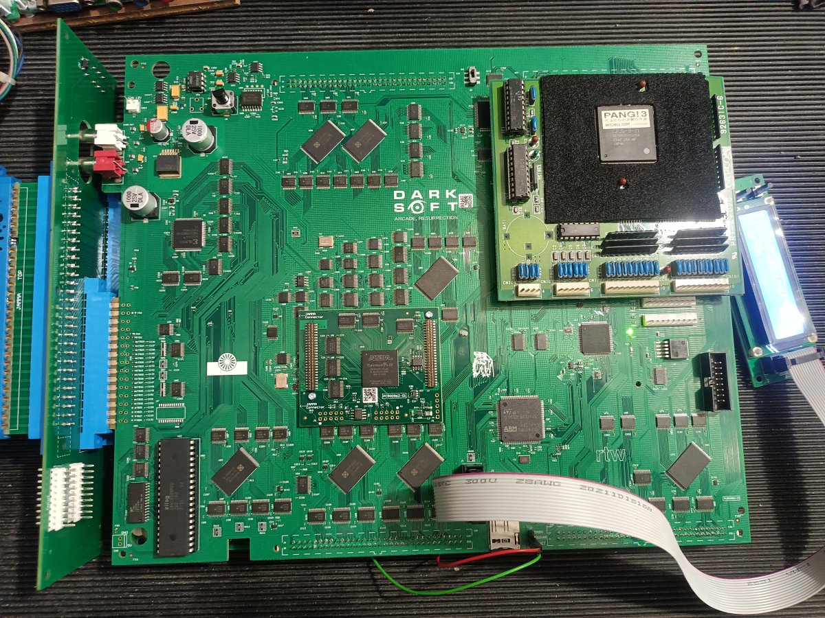

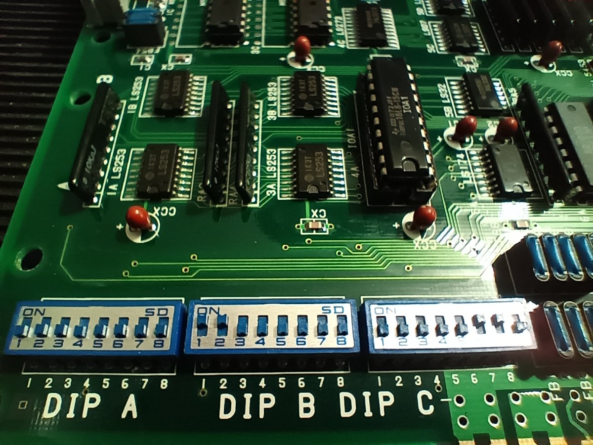

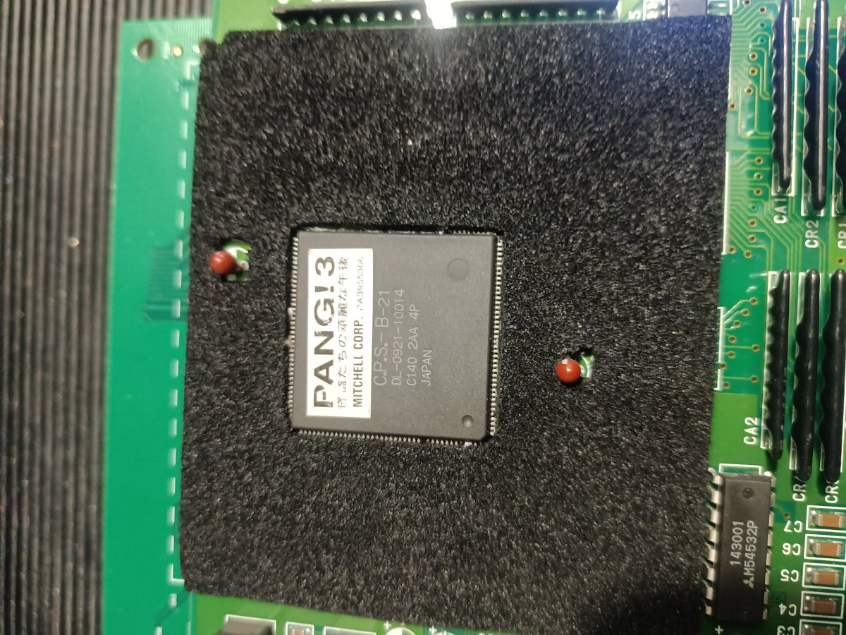

Hello,

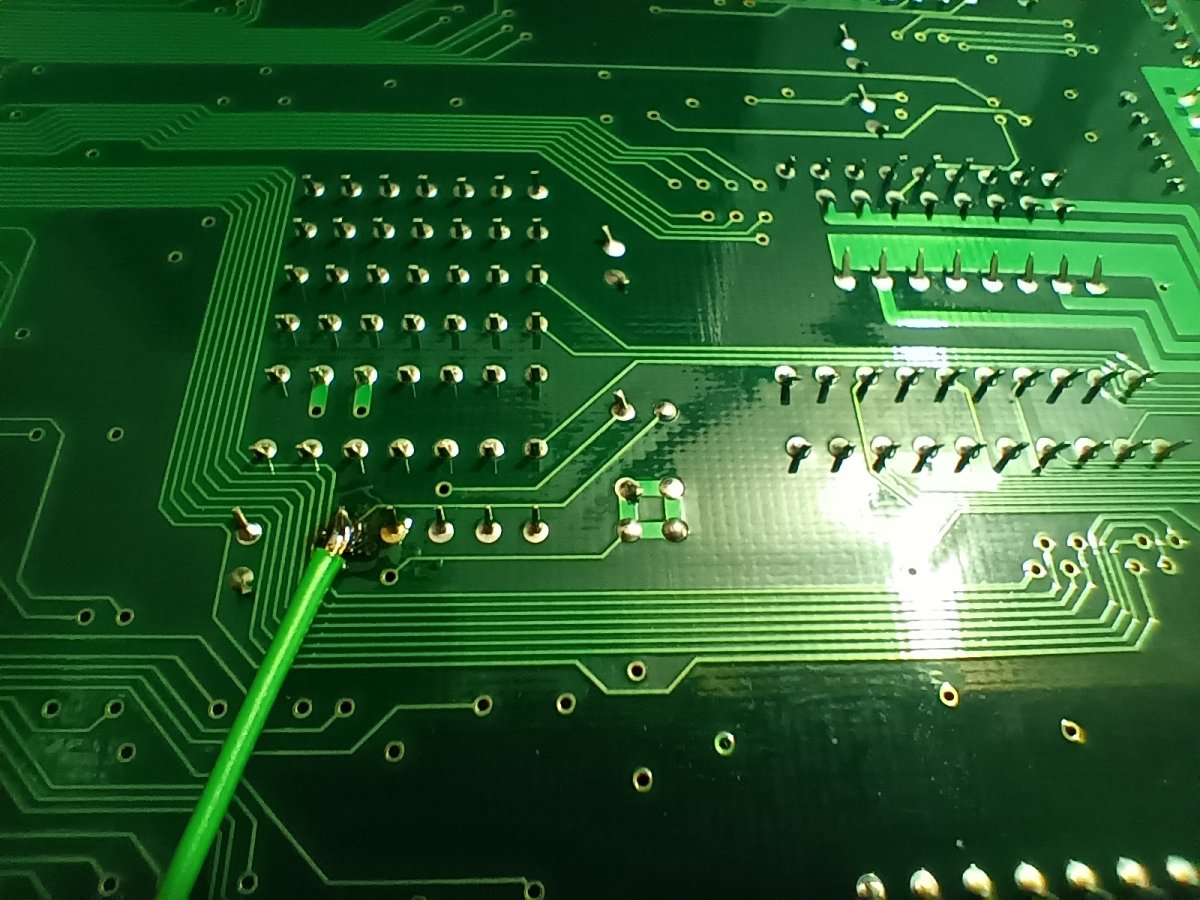

First of all , i would like to congratulate all the amazing ppl on this forum who had created these amazing multigame kits: taito f3, cps1/1.5/2/3, mvs, stv ,and all the ppl that had created conversions and mods: cps1/1.5 to cps2 HW, biomechanical toy, etc.. I own a few of these multigame : cps2/3 , taito f3 , and recently i bought a cps1.5 multi.

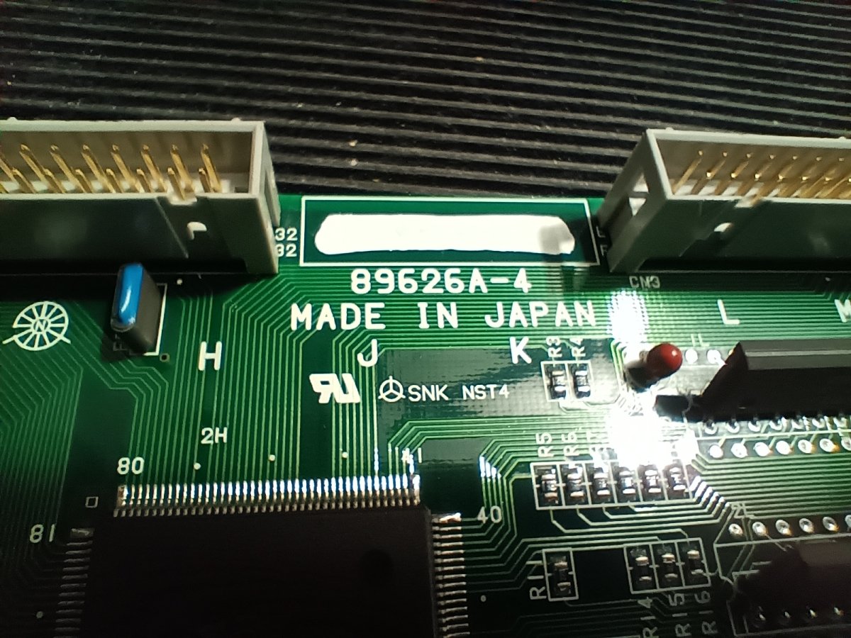

I have followed the instructions in the .pdf provided and the games are working fine, only those that are running on an original B21 PPU: sf2CE, SF2HF, daimakaimura, pang3, other games play on blank screen (they coin up), or others do not play at all(they do not coin up). Varth plays with some sprites at the beginning, so does cadillacs with the logo - but with wrong colors.
My mobo is 89626A-4, 12Mhz osc, provided PAL replaced, tried 3 C-Board: sf2CE, pang3, and knights of the round, and with recommended DIPSW.Also i have tried putting the flash.img in the root for update- no improvement.The game was pang3 before switching to multi.
I attach pics for clarification. My guess is that the keys are not written in the CPS-B-21, so that some games play blind, and other dont play at all.
I do have electronics knowledge
Any help/instructions/thoughts on this problem ?
Dragos.
IMG20241217141942.jpgIMG20241217141951.jpgIMG20241217142016.jpgIMG20241217142157.jpgIMG20241217142207.jpgIMG20241217142218.jpgIMG20241217142231.jpgIMG20241217142243.jpgIMG20241217142300.jpg
Your C Board is not the right one. Although it has the B-21, it doesn't allow for key writing. You need a new one.
Check here: https://www.arcade-projects.com/threads/what-donor-board-to-use-for-the-cps1-multi.13106/
Your model is a "GOOD" one, which are: "These "Good" Options will work, however you will be limited to only using "decrypted" ROM sets."
you one of the called "BEST"
I also have some repros left. PM me if interested: https://www.arcade-projects.com/threads/c-boards-reproduction.24614/
