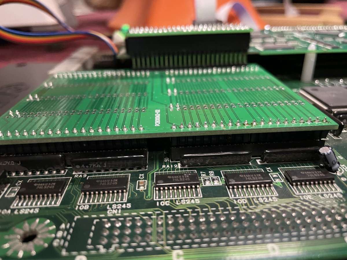

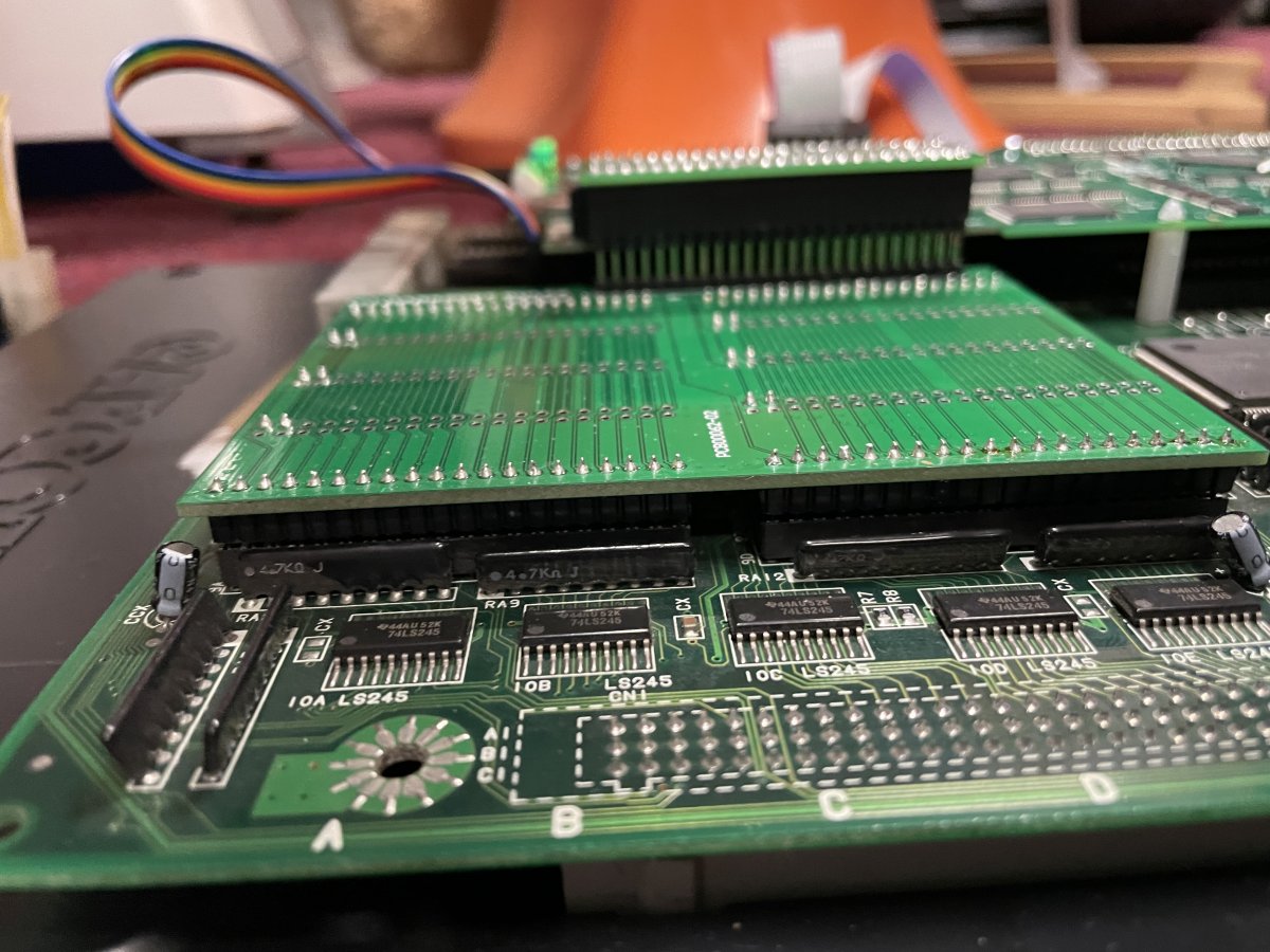

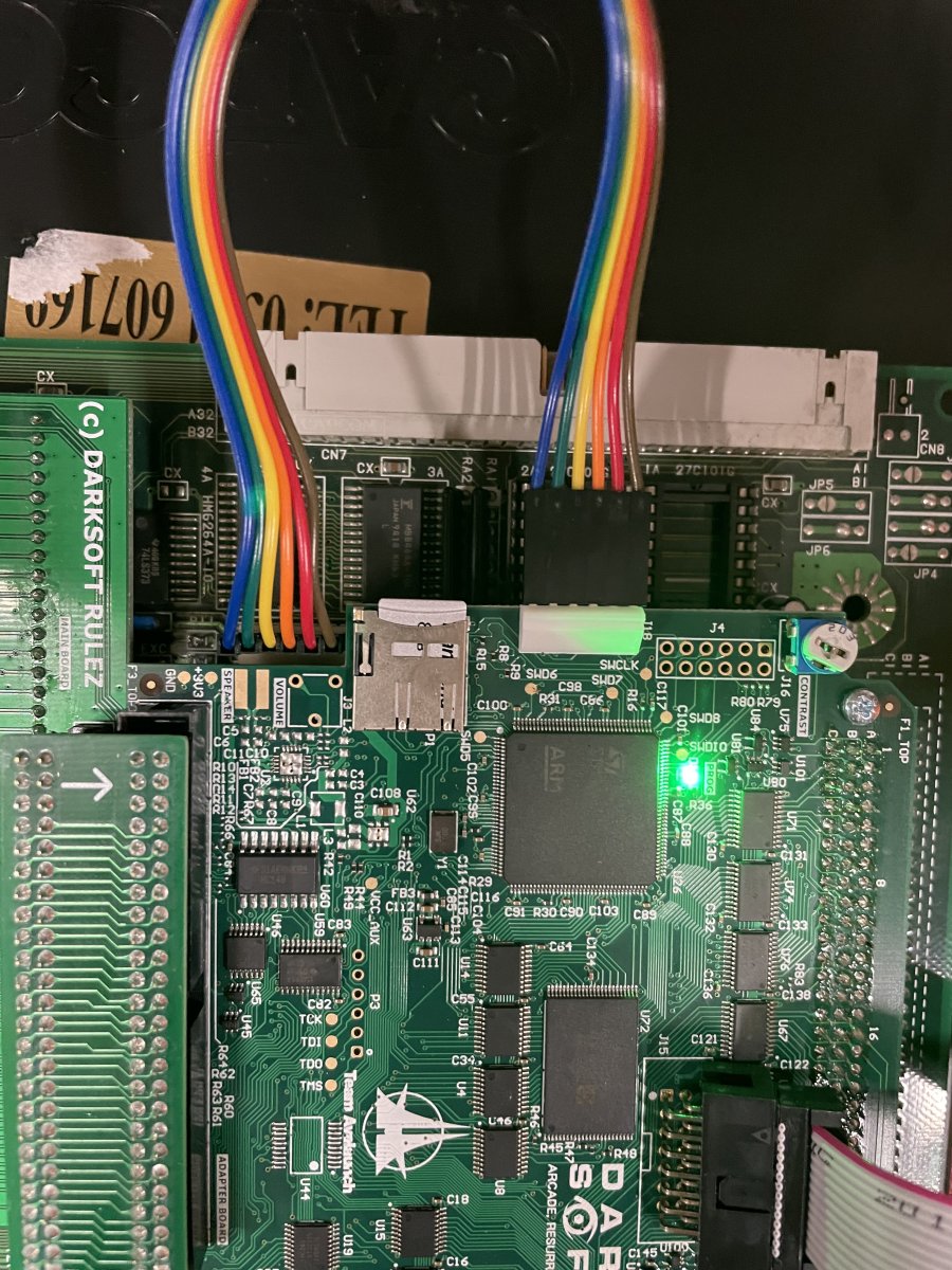

Hmmm, having issues with the keywriting cable, I bought the one provided by HighScoreSaves, and have it snapping snuggly into both the multi kit and b-board connectors, yet no luck botting encrypted roms. decrypted is working fine, but puzzled on why keywriting would be failing.
If you post a picture of your setup and specially of the section with the wires, that would help to identify the problem.
This is the correct wiring orientation, right?

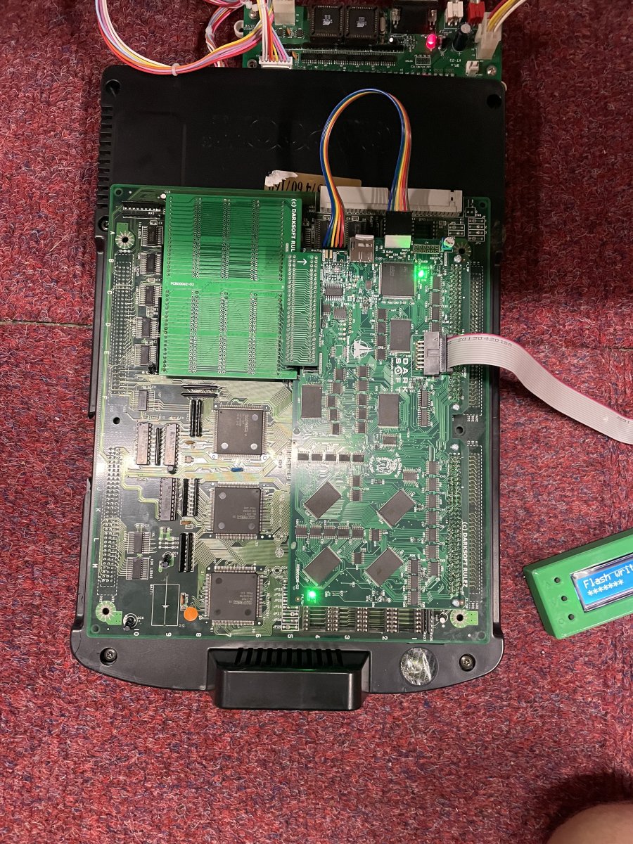

Hi all, new to the forum but I’ve just received my darksoft kit from saveyourgames.it, including SD card from them
I’ve installed onto a previously 100% working Xmen v SF rev 7 b board with battery removed, exc5 shorted to clear, DuPont wires connecting key writing & the Darksoft 2020 encrypted rpm pack. I’ve had a variety of issues when I came to test for the first time
At first I tried to load AvP, I was getting a red screen. I tried reseating everything and tried again, black screen. I tried loading D&D and this sort of worked, but without sprites and messed up controls
I tried a few times to reseat everything, eventually pulling all and starting again and trying with the decrypted rom pack. I’ve tried different games and I’m getting various issues now:
Black screen on some games

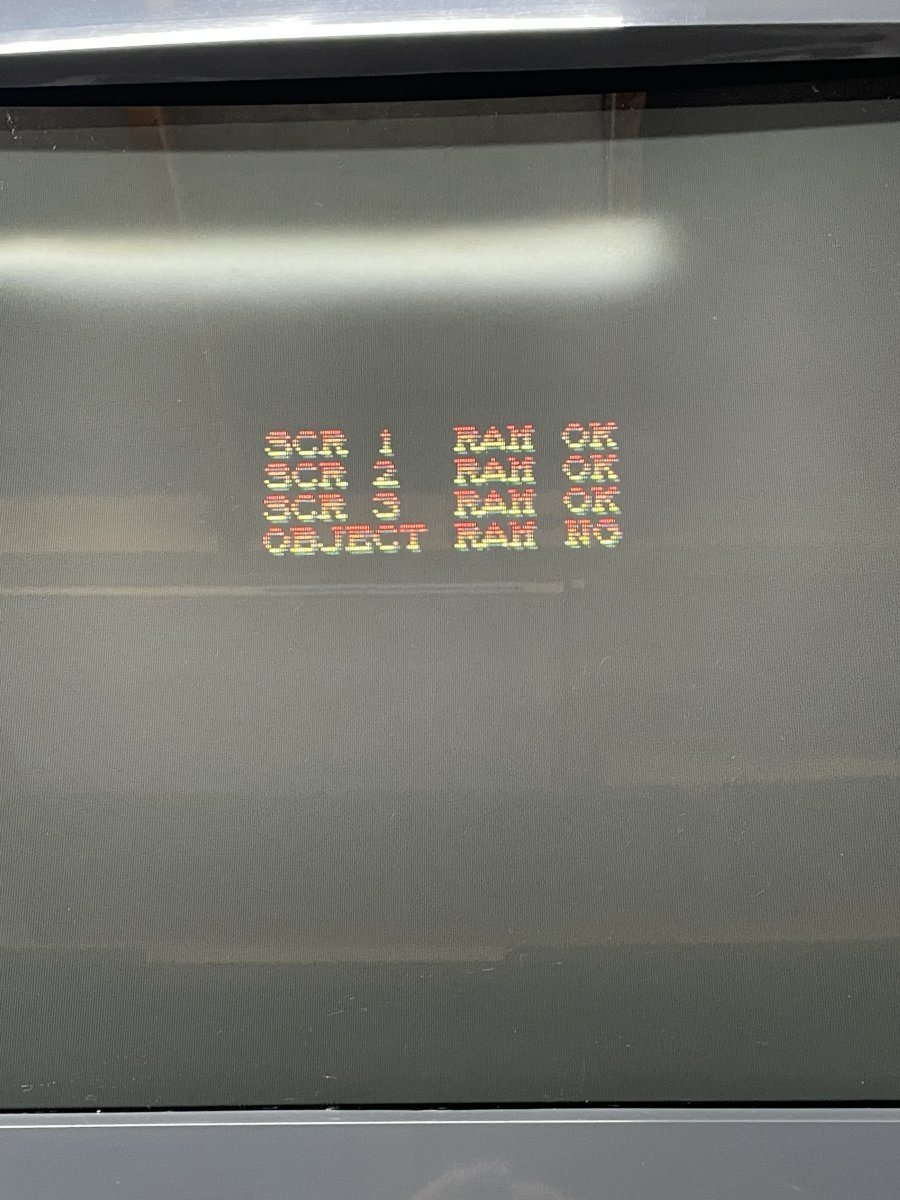

Object RAM NG (SFII X Freeplay)
Garble on others

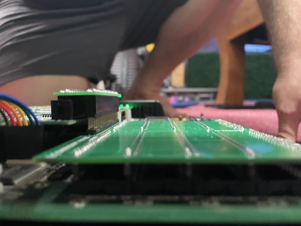

Everything seemed seated correctly, no bends or damage etc. I’ve tried another a board and same issues
I’ve read this thread and can’t find anything and I’m actively reading as many threads of possible but thought I’d post in the meantime, any assistance would be great

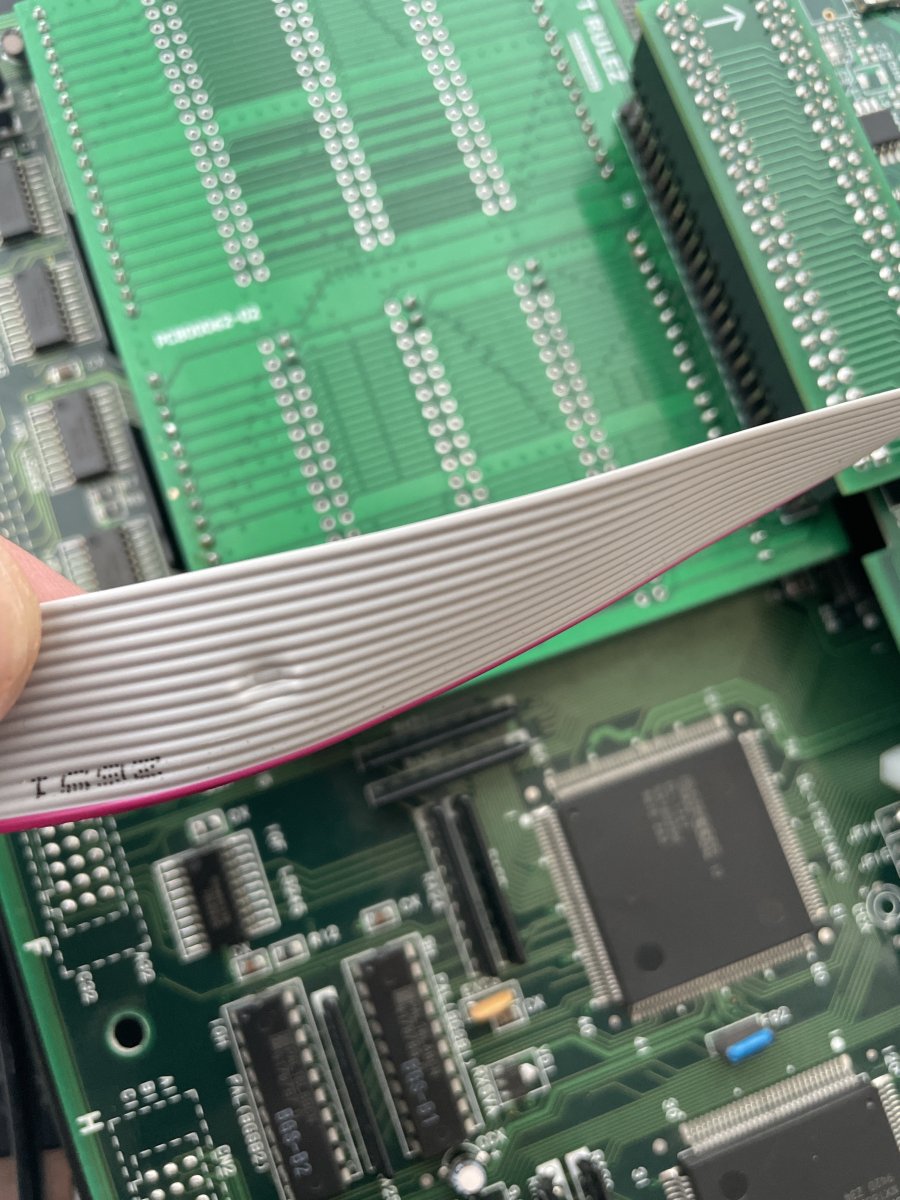

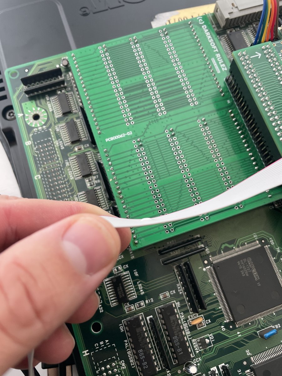

Is there a big dent in that ribbon cable? Should not cause described problem though...

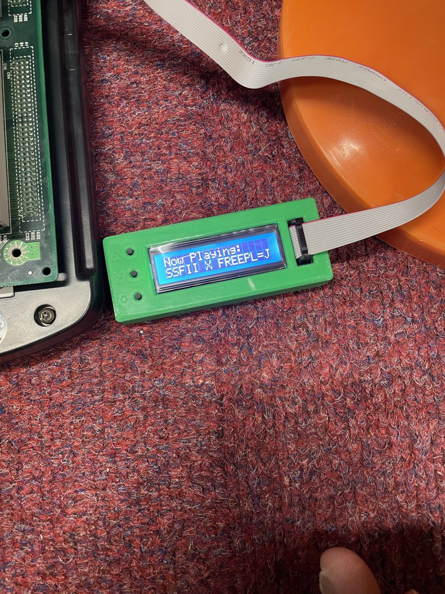

Did you already try this: after loading the game when the display says "Now playing:" turn off the power and turn the power back on. Do you still have black screen or garbage on screen?

Hi, I didn’t notice the ribbon cable but it’s straight out of the shipping box, I’ve just been and had a look and it is dimpled quite badly

Once the game is selected you don't need the LCD plugged. Try loading a game and power the LCD off. See if that changes anything.
Well, it must be a b board issue on that rev 7 xvsf board because it’s working like a charm (minus the auto reboot) on my rev 4 b board
I've seen it a few times where a B-board will play one game fine but not the multi because the B-board has a fault that doesn't affect a certain game. There is a chance the ram is good but the trace connecting the ram to the multi through the connector is compromised.
