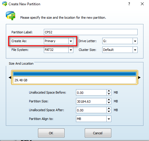

Make sure you partition to fat32 as a primary drive and not a logical drive, by default it's configured for logical.
If you use logical, the multi won't read it.
Once it's primary, load the games folder in the root directory as from the rollup pack and you should be right after that.

Ok so formatted the sd card with gui format program and it now reads the games list and plays games.

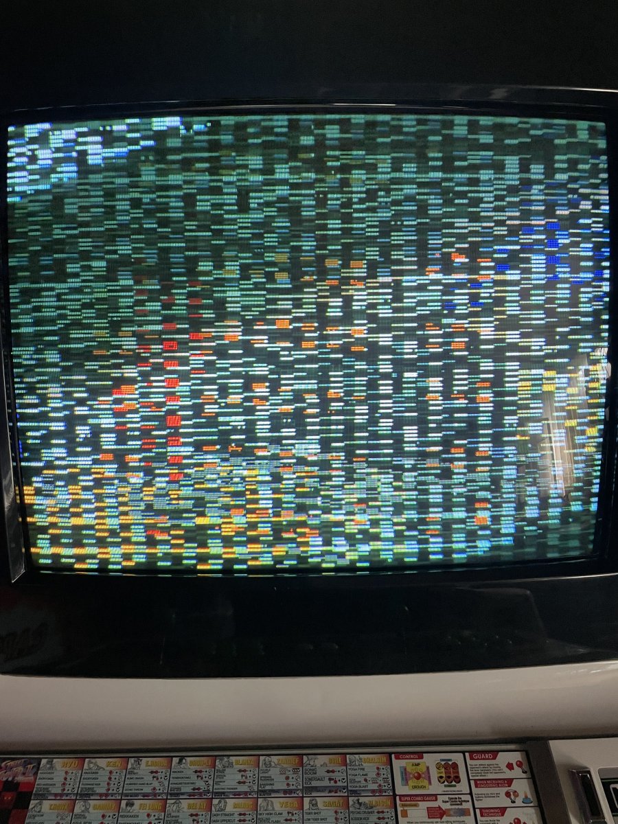

I get this screen while loading a game
Then when the rom is fully loaded and says game loaded. It pauses to graphics pallets and doesn’t move from there, if I reset the machine it loads the game I just attempted to load
Annoying that every game change I have to reset the system.
Any ideas??
Yeah quite weird
Any ideas??
That happened to me before I installed the key write wire. I may be mistaken, but I believe one of the wires is a reset
