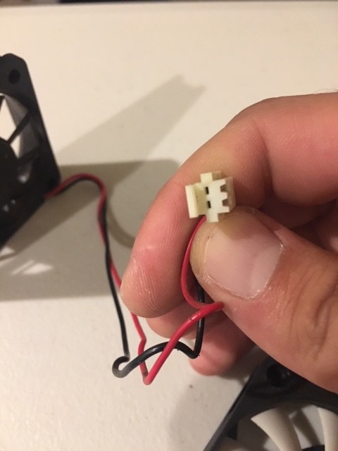

Recently did the Sunon fan replacement. Was an easy drop in. Just had to take the plug off the old fan and attach it to the new one. Works great and doesn't sound like a tie fighter. :thumbsup:

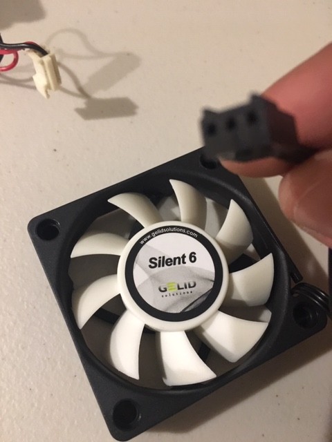

@lobogau get the silent 6 fan it works very good and it comes with the connector already its just plug and play.
https://www.amazon.com/gp/product/B008S1HNPS/ref=oh_aui_search_detailpage?ie=UTF8&psc=1

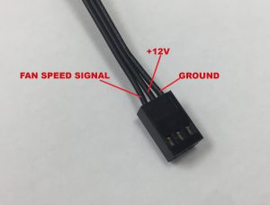

So I bought this but the connector has 3 holes where the original fan has 2. Advice appreciated :-)
I switched to the metal case so different fan now, but i would just connect 2/3 see if the fan turns on if not use the other side and the middle pin again and turn it on again, thats what i did I remember. Lol

Just cut it and solder the old connector to the new fans 12v and ground wire. I think the third wire is used for temperature control fan speed
Thx guys. I just plugged in the +12v and gnd and left the temp control unplugged.
Wouldn’t call this fan “silent” but it is eons quieter than the stock fan.
This does take a good push to fit in, it’s a little bigger than stock but definitely not a dealbreaker. It won’t crack the plastic casing or anything. Just needs some persuasion. Great plug and play solution for those who don’t want to replace the connector

For CPS2? Is it not JST PHR-2?
https://www.digikey.com/en/products/detail/jst-sales-america-inc/PHR-2/608607
or are you using it in a NAOMI? sorry I didn't read up far enough. I believe that the NAOMI fan does plug into the filter board onto an NH connector? don't forget to order the pins too...

How about crimping? The fan connects to the motherboard using a JST NH connector.
