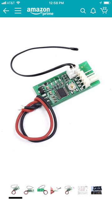

I’ve been considering installing one of these fans along with this temp based fan controller (pic and link below) in my CPS2 once my Darksoft Multi arrives. Anyone have experience with these cheap temp probe based Pwm controllers?
Icstation 12V 4 Wire PWM PC Case CPU Fan Thermostat Speed Controller with Sensor https://www.amazon.com/dp/B077SLWWXL/ref=cm_sw_r_cp_api_i_O6NKCbPWD73J2

I think fan controllers are unnecessary.
If you use a good quality low-noise fan such as EBM/Papst, Sunon, they will provide decent airflow.
Both 2-pin or 3-pin fans will work, as long as you keep the ground wire to the left (closer to the edge of the board) -- sorry, I don't have a pic right now.
To make things easier to explain: if you place your board with the fan facing up, the left pin is G and the right pin is 12V.
The yellow tacho/sensor wire can be left out, it's not necessary to ground it (or to snip the wire) in this case.

Interesting, I've found one from China on eBay for 3€, might give it a shot just for fun.
