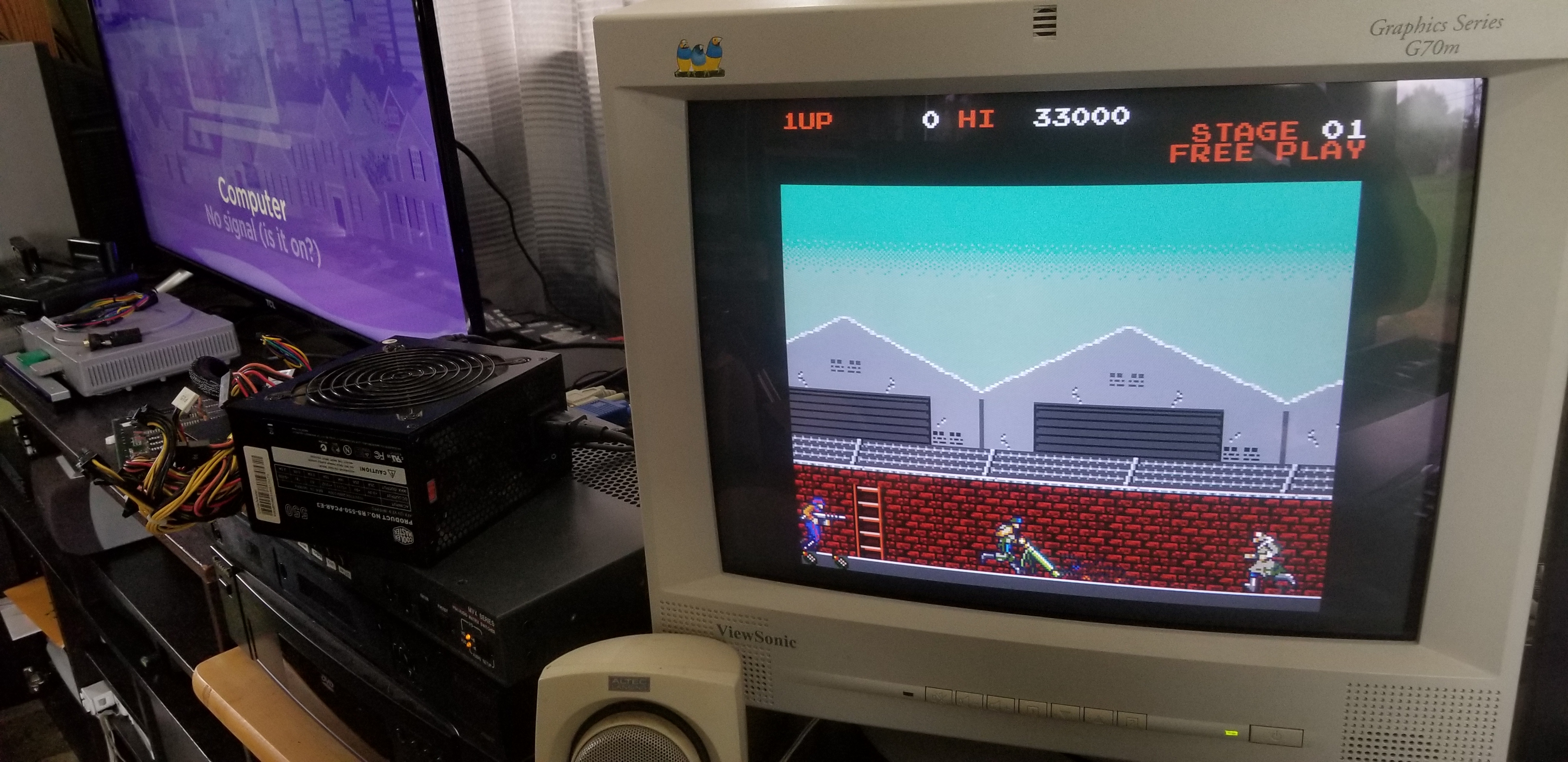

The video out is always OK from may supergun but no signal from HDMI (my tv said there's no signal)

I check all soldering with multimeter...try 2 hdmi cables
My motherboard is ok. I have video signal through the scart of my supergun. but nothing in hdmi :(
