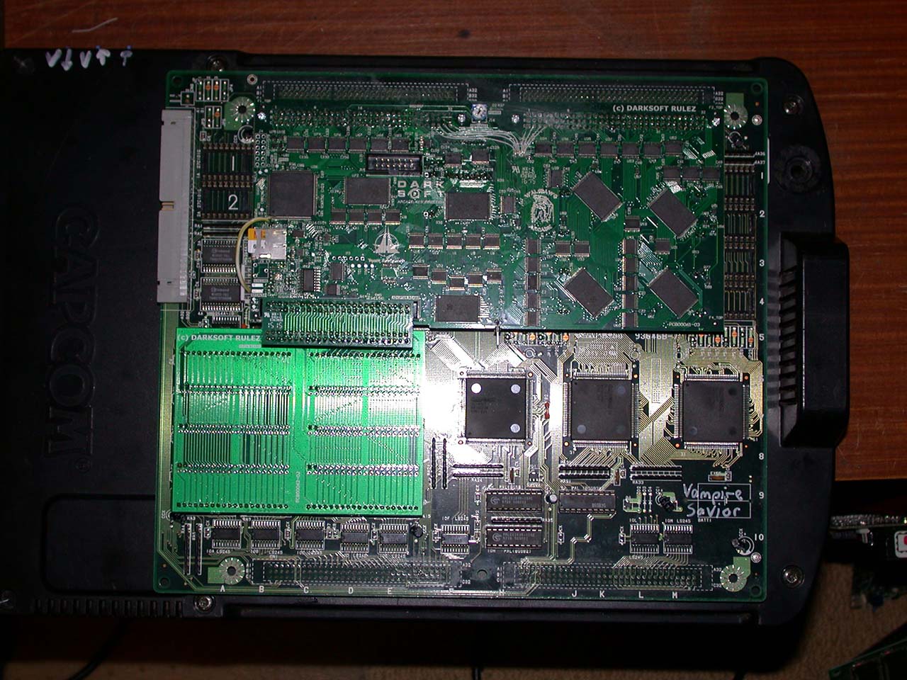

This is what the PCB looks like at real size. Click 'View Source Image' then click the + sign to see it.
My soldering was done with 8X magnifier and super bright cool white ring light.
Also removing the chip without damaging the PCB requires skill, knowledge and equipment.
I've been doing stuff like this for nearly 20 years. You definitely can't do this just by naked eye with a $10 soldering iron bought at the local hardware store ;-)

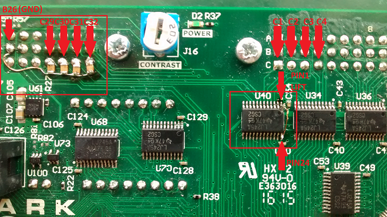

Leave u40 but lift pin 1 and connect to 3.3V then add the caps and tie them all to ground.
This does seem simple enough. Would it be possible to get a diagram drawn up showing the locations (specifically...the ground, the 3.3v, and the pin1 leg)?

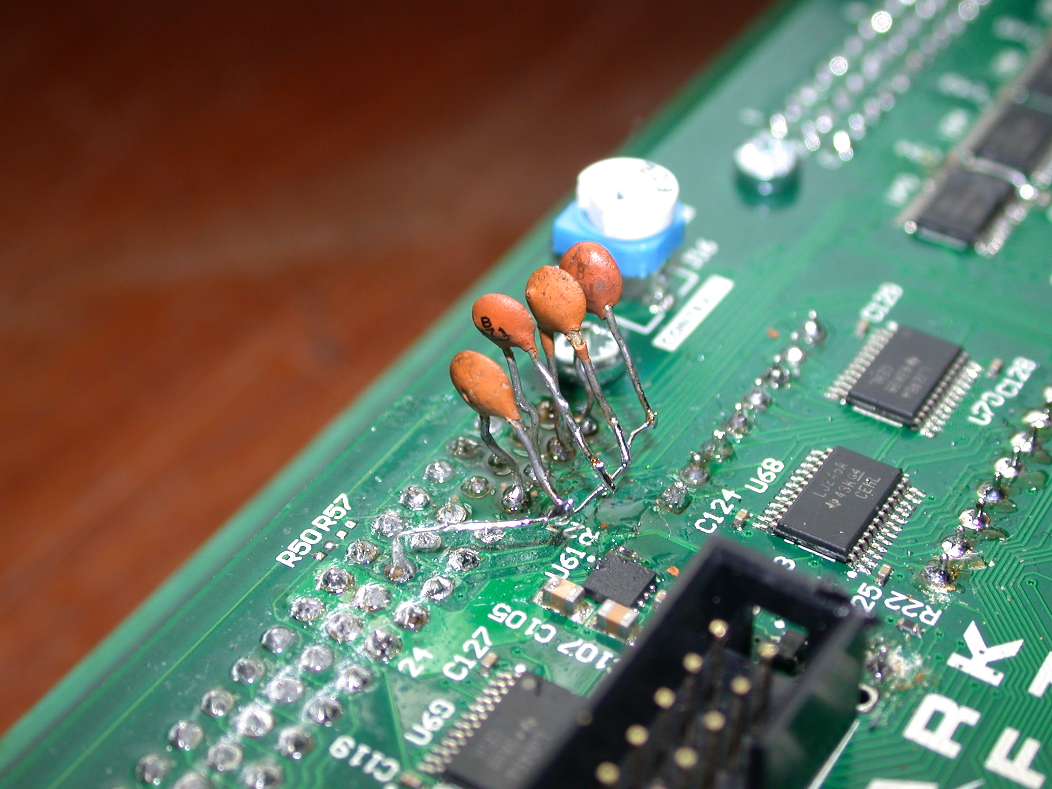

I'm posting an alternative solution that maybe suitable for more people. I repeat this again. Make sure you know what you're doing as any damage that you make will void any warranty. Do it at your own risk
The second method consists on lifting the leg 1 of U40 and connect this leg to any of the 3.3V points on the PCB like i.e leg 24 of U40. Additionally you need to add 8 Caps of 470 pF or similar to be soldered to the points shown below.
Guru used ceramic caps which are much easier to solder. See attached. Notice that the picture only shows 4 capactiors, the other 4 go on the lower left pins of the connector closer to U40 (same pins as the cable solution with cables of Guru), that means pins C1, C2, C3 and C4.
What gauge of wire do you recommend to use to run from leg1 of U40?
most important is that cable is single strand. size of pin is 0.5mm, so I guess something slightly smaller like 0.4mm would do the job.
oops. there's a small typo there. voltage going to pin 1 comes from pin 24 of u40 sure, but its 3.3v ;-)
I used ceramic caps because that's all I had, plus they were ripped off some junk PCBs which is why they look old.
