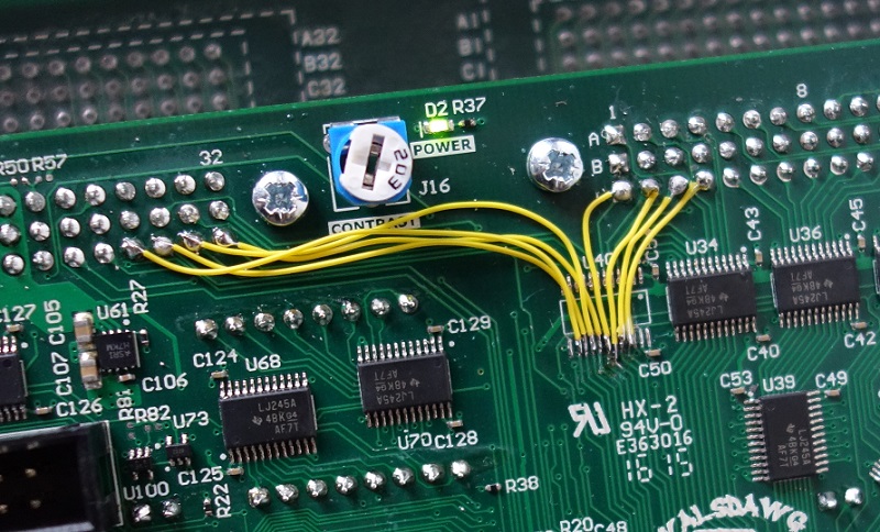

Looks like you did that for at least two other chips as well? Any reason other than initial troubleshooting?
It was also part of some research I did to get rid of the audio related pins under the board. The two chips between the rows of data pins for the audio ROMs are for audio and since the crackling is a audio issue, I focused on them. But turns out they were the receiving side of the problem, not the originating side... lol
Makes sense, nice clean work with those tiny wires!
Enameled wire is where it is
https://en.wikipedia.org/wiki/Magnet_wire
you're skilled, man!
The second method consists on lifting the leg 1 of U40 and connect this leg to any of the 3.3V points on the PCB like i.e leg 24 of U40. Additionally you need to add 8 Caps of 470 pF or similar to be soldered to the points shown below.
Guru used ceramic caps which are much easier to solder.
oops. there's a small typo there. voltage going to pin 1 comes from pin 24 of u40 sure, but its 3.3v ;-)
I used ceramic caps because that's all I had, plus they were ripped off some junk PCBs which is why they look old.
fixed!

I'm posting an alternative solution that maybe suitable for more people. I repeat this again. Make sure you know what you're doing as any damage that you make will void any warranty. Do it at your own risk
Guru used ceramic caps which are much easier to solder. See attached. Notice that the picture only shows 4 capactiors, the other 4 go on the lower left pins of the connector closer to U40 (same pins as the cable solution with cables of Guru), that means pins C1, C2, C3 and C4.

Pain in the ass to strip such small pieces, that was really the hardest part.
stripping kynar takes literally 1 second.
hold the wire flat on a piece of scrap wood.
put your soldering iron at the end of the wire about 2mm from the end then press down, wait 1 second and wipe away towards the end in one movement. repeat if necessary.
the wire is stripped instantly.
just don't do it on your kitchen bench or other valuable table otherwise your Mrs is going to kick you in the nuts.
