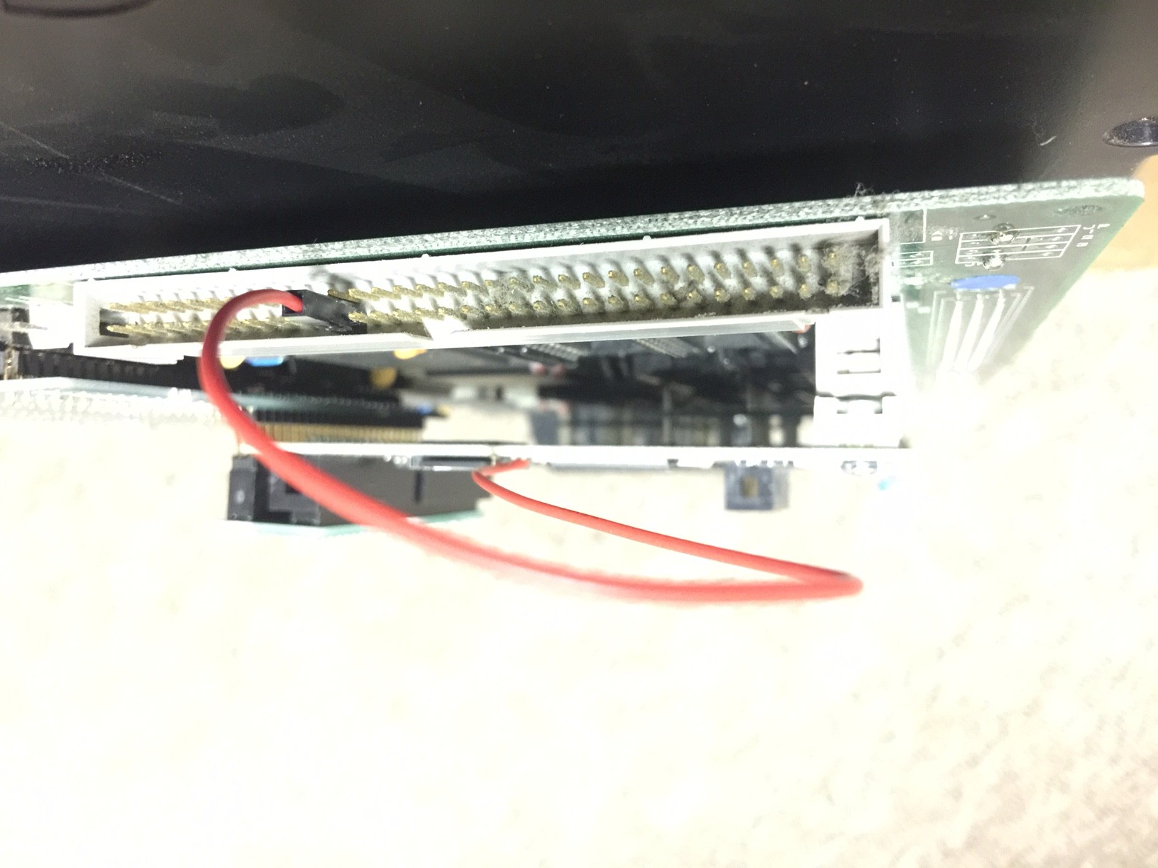

Added this picture to the first post. Anyone without the CN9 connector can add their auto-reset wire to B21 of this connector like so:
Sorry I can't seem to find the description of the connector so can somebody please post a picture where we see the rows and columns of the connector so we know where B21 is? ... thanks
edit: ok I used my brain :/ ...and read what's written on the board and to make sure, I used a DMM and beeped the pin ! but anyway ... B are the top pins and count 21 from the left of his picture above ... of see my picture! *GEEZZUS!! LOOK AT THAT MESS!! <X )

Auto Reset wire installation pic - for those who do not have a CN9 header pin connector:
One end solders to SWD5 on multi kit. The other end solders to B28 on CN1 on B board

There is an error in the "how to update the firmware" PDF. On the last page it says to connect the reboot wire to B28 when it's supposed to be B21 (as per the picture on page 1 of this thread..)
Works like a charm now.. after missing to put the flash-file on the sd-card AND then using B28 to reboot..
