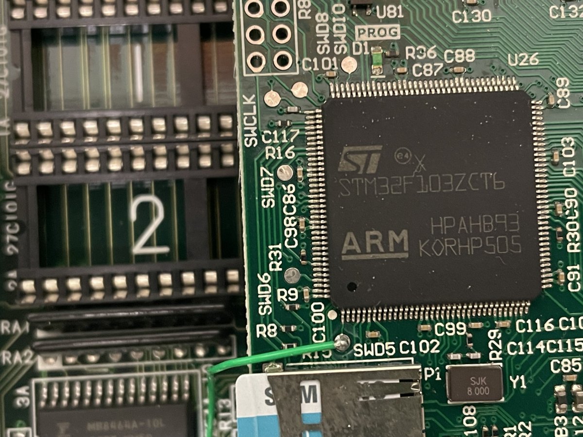

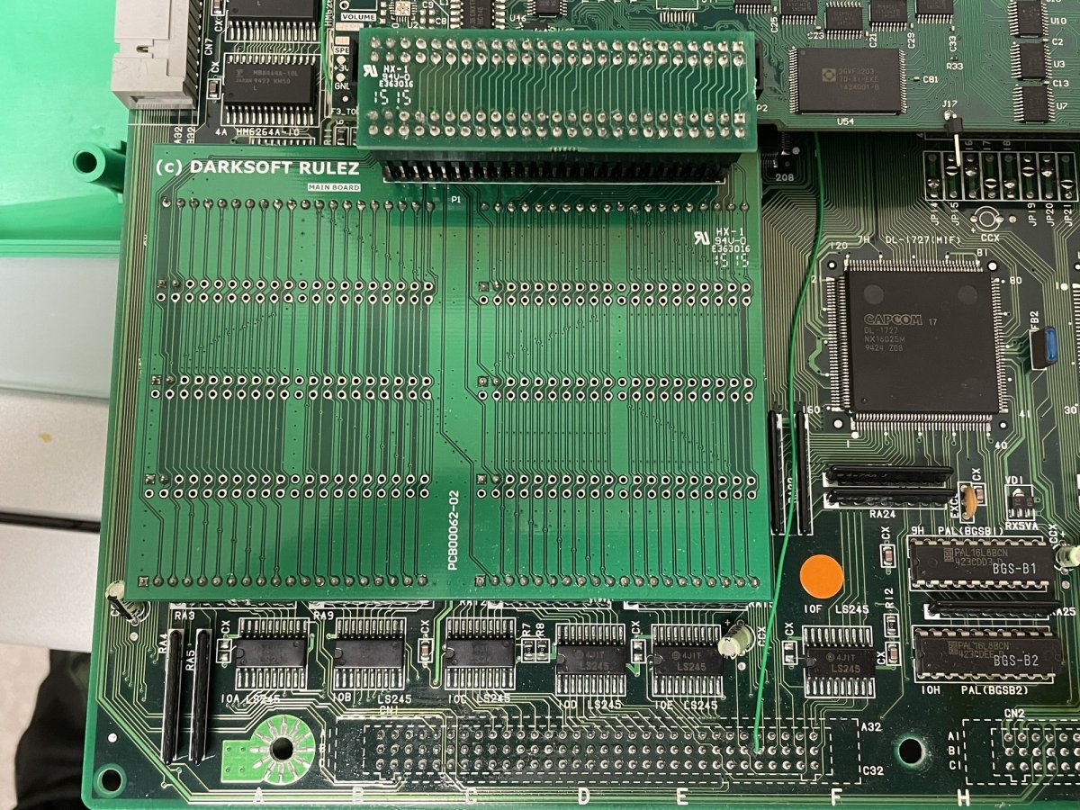

I have a couple of questions and hope someone can give me guidance.
I bought my board in 2015 (holy time is flying =O) and it's a "93646B-7" Revision.
I just opened it and there's still the "old" wire going from SWD5 to one pin of the "big" connector. (see pics).
So now to my question. In what order do i have to modify my CPS2 multi so i can use the Roms with the key files? I read that i shouldn't install the 4 wires until my motherboard is on the correct firmware.

Hello!
a) It's in the first post of this thread.
b) Correct. That wire is just a reset wire, now you need 4 wires to write the keys. One of these 4 wires is reset, so might be that you can leave that. Check instructions also in 1st post of this thread.
c) when keys are being written, there should be a file in each folder of each game with the corresponding keys.
You wont break anything. Just upload the firmware as described in the instructions and you should be good.
It's possible hos FW doesn't have the SD update function since his kit is so old. He may need to send it to someone with a Discovery to update.
Are there silkscreen markings to let one know if they might need to do just that, or at least hint at it?
Where are you based? Can you please update your profile with your approx. location? You should try to copy the file on the microSD and see if it dissapears. If it does, then you are good. It means that your CPS2 can do updates. If it doesn't then you need to either update yourself using a discovery or send to one of us for an update.
To be a bit clearer, try to put the firmware update file on the root of your SD card and boot your multi. The leds should flash rapidly for a few seconds. If it updated then the update file will be deleted from the SD card. If the file is still there you have super old firmware that needs to be updated via a Discovery device.
phuu i guess i just leave it like it is. Many games are running and that should be enough, but thanks anyway for your help!

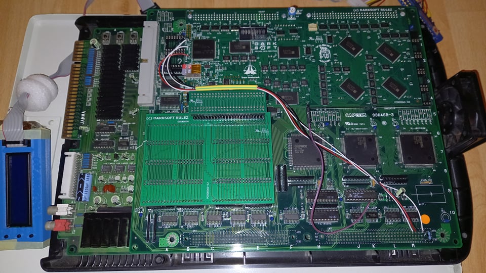

Hello,
I have a strange sound issue with my multi board. All games working well, but some newer CPS2 games like Street Fighter Alpha 3, Progear or Vampire Savior have heavy sound glitches. It sounds like the samples are misplaced or wrong addressed, to put it simply, it's like Ken would say "Yoga Flame" instead of "Hadoken". Therefore the sound fx and music is completely messed up in those games. I read a lot of threads here about sound issues but funny is that most of my games actually working. (Like Street Fighter Alpha 2, D&D, Vampire Hunter).
My B board is a 93646B-3 (Grey SFZero2) and my jumpers are SOOS SO OSOSOS SOSOSOSO SOSOSOSO (As it says in the manual) The Pal is lifted and all wires are fine. I have checked all jumpers with a DMM, also checked the continuity of all pins from the Darksoft board to the A borad. I tried different SD cards with different ROM Sets (Also with decrypted ROMs) but no success yet. Is there something wrong with e QSound addressing? Unfortunately I don't have another A borad to test it. Any ideas?
