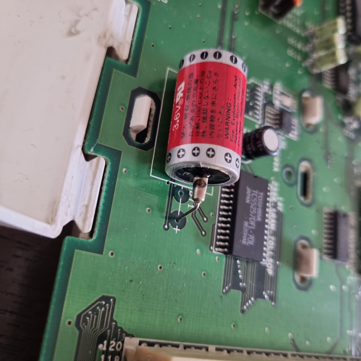

-I've open the white housing piece on the motherboard, battery still there but there's dark discolouration on the battery wire, not sure if that means it's shorted

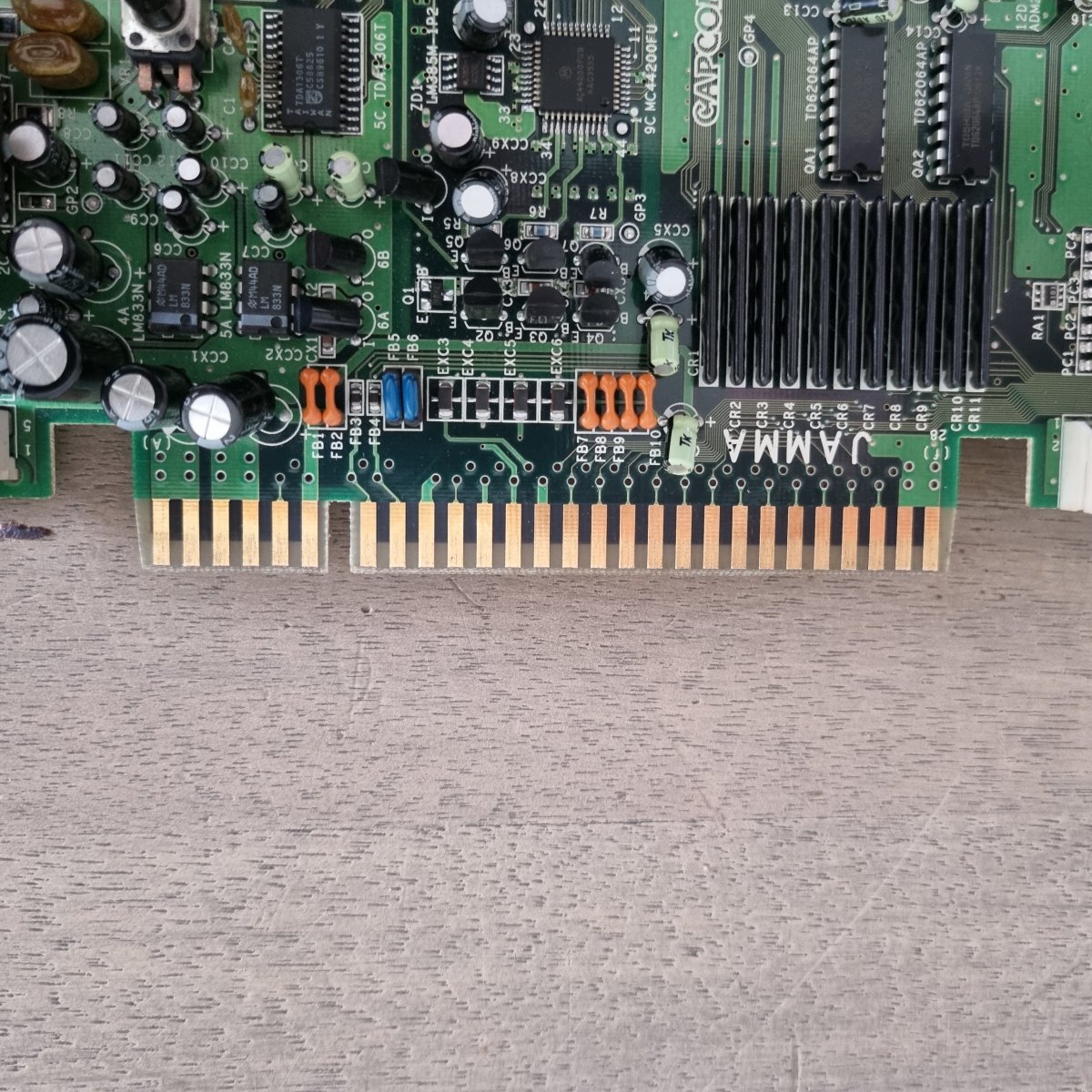

-I've cleaned the jamma and cartridge edge connectors
-checked voltage with multi meter is at 5v at the jamma edge
Wondering where to go to from here. I could buy an old cd drive, burn a copy of the 3rd strike disc and try that. Or just go ahead and organise a darksoft cart and new simms for it. Hoping someone from here could give me some pointers. I'll include some photo's below. Thanks!

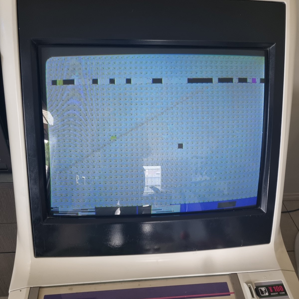

I got this screen once
